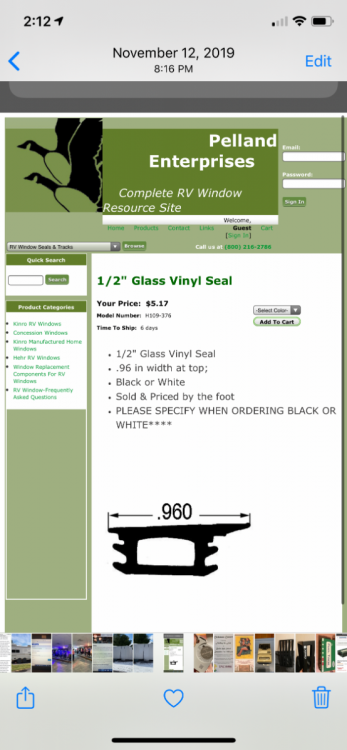

bhncb 3 Posted November 3 The Hehr p/n is H109-376. It comes in both black and white so be sure your source will permit you to specify which. I order Hehr parts from Pelland Enterprises pellandent.com (aka rvwindow.com). Great service. 2 Share this post Link to post Share on other sites

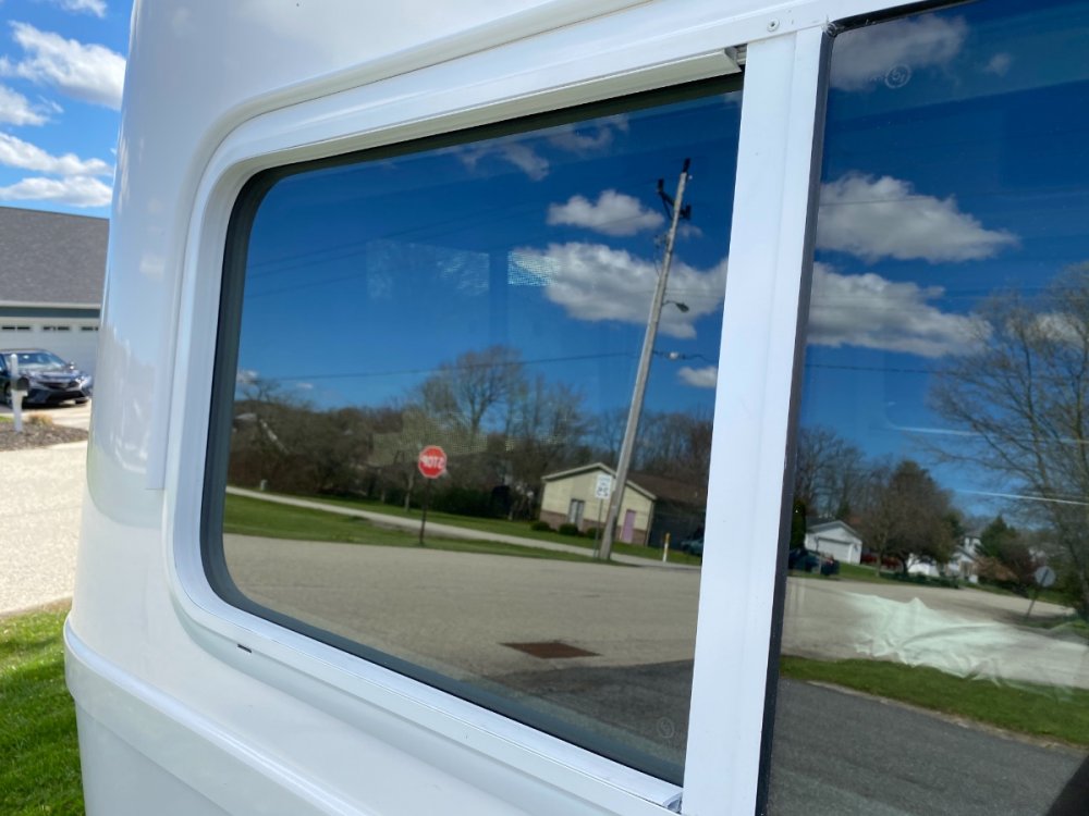

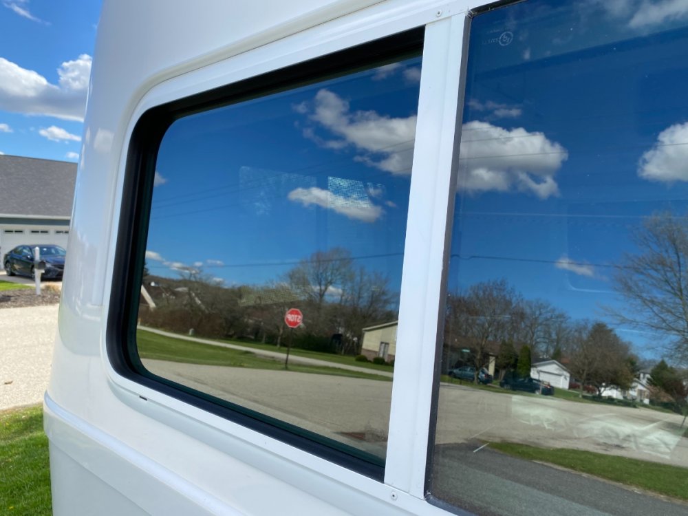

Overland 34 Posted November 3 At $5/foot it would be a bit pricey but I’d love to swap out the white trim for black to make it easier to keep clean. Snowball • LE2 256 • 2018 Ford Raptor Share this post Link to post Share on other sites
mossemi 8 Posted November 4 I replaced mine in May 2019 and it just may be the best $100 I ever spent. You will need 5' for each large window and 2' for the bath on an LEII or 17'. Mike Mike and Krunch Lutz, FL LEII #193 “the dog house” Share this post Link to post Share on other sites
