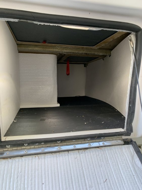

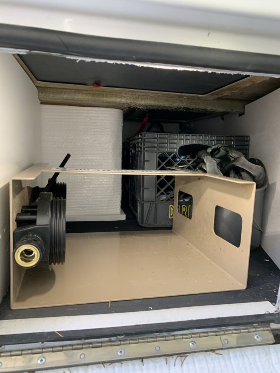

We use the Clearsource for our Oliver.
My reason for spending a bit more is that I wanted the actual stand which is powder coated non rusting.
It fits in the front part of the storage area perfectly laying flat, leaving room on top for another bin, electrical cords etc.
I put quick connects on the Filter, and use a short 2' hose to connect it to the trailer, and it can actually be  tucked up under the trailer while camping.
Pix Below:
In the basement area I have the Clearsource, a  (6 Gal) and (4 Gal) milk carton for storage and 1 gal bucket and flush hose.
(I removed the filters from the stand in this picture below so you could see through to the back of the storage area.)

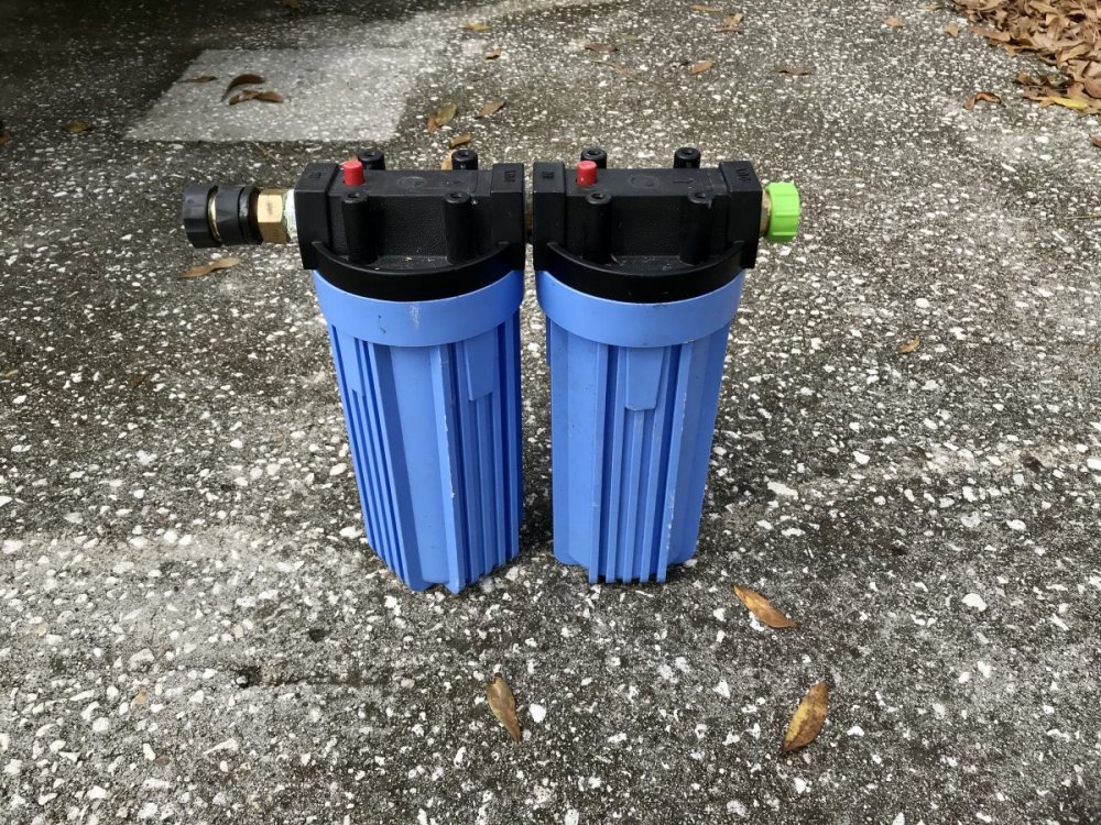

As Mossemi says above, It's entirely possible to make the same filter out of components you buy from Home Depot or Lowes as mentioned above.
To make that filter, you should have the flow go first through a sediment filter then into a finer carbon block filter which removes order and tastes (like a Brita.)
2 hours ago, mossemi said:

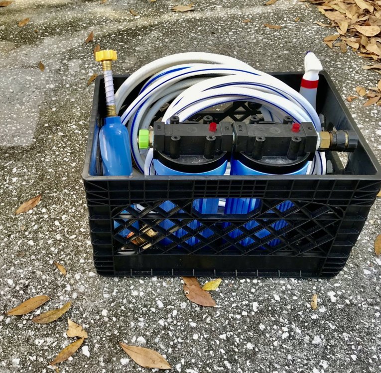

This is my home made water filter from common water equipment available at HD, Lowe’s or Amazon.
MosseyAC29C675-AA20-4094-A97A-F1AA8EAEBF42.thumb.jpeg.7ac263f4c1b407e3d195759dfd624a96.jpeg

3 hours ago, The Shackelfords said:
Mossemi,
That is absolutely amazing, and you probably saved me a lot of money. How many microns does it filter down to?
I spent about $100 and you just pick your filter cartridges to fit your needs.  I don’t think any water filtration company has any better quality filters than you or I can purchase online or locally.
I don’t drink tap water or cook with it as I have a preference for distilled water and usually start our trips with 8 gallons of water distilled at home and resupply as needed while on the road.

As I have said before, with the limited space in our SUV, I really like to carry items that serve multiple needs while camping.
Pictures of my filter stand and storage container.
072D4EA2-F4FE-4503-8B5E-DBC59F0E7B18.thumb.jpeg.206cdafafa418fdbaf6590a584a0a503.jpeg756AA745-112B-488B-9708-9348084EB6BF.thumb.jpeg.cbcec0bc3bde2044d6cb527c87832cf3.jpeg
