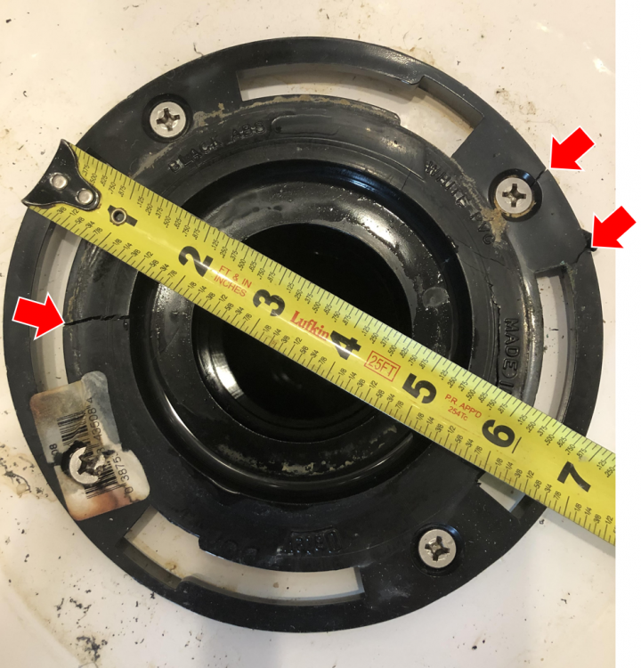

We removed the Dometic toilet to determine why it was rocking on the base. The flange was broken at the slot which holds the T-bolt. We didn’t know how to remove the base flange. Our solution was to use a universal drain toilet spanner flange. We were unable to reach the service department. Is the base flange threaded or glued in? Has anyone tried to replace the base flange?
  • 3 months later...
Our flange was broken in three places after 1 year of intermittent use.  I've posed the same question about flange removal and replacement to the service department.  Will update this thread when Jason replies.
Update:  Had the flange replaced by RV Service Center.  Flange was glued to short pipe (see below)  which was inserted through a rubber "grommet" into the top of the black tank.  After considerable effort, I gave up for fear of breaking something during removal.  RV service tech said that he also struggled mightily to get it out (he had to confer with Jason.  Thanks Jason).  Tech replaced flange with similar part and had to chamfer (grind to form a bevel) and lubricate to get the "tail pipe" reinserted through the rubber grommet.  Perhaps Oliver construction team should lube pipe well before installing.  Should have been an easy fix, but wasn't.

Dometic 310 Floor flange spec: “3 in ./76 mm ID, 1/4-7/16 in . (6-11 mm) thick” ( which is the average thickness of a toilet floor flange).  So you are probably correct.  Note the flange shown is not the correct size and shown for flange thickness example.
The Oatey 43508 flange is .45” at the 7/16 limit.

The flange cracked and the toilet also moved around.  This allowed vapors to seep past the flange gasket.  It was not pleasant.

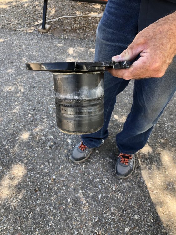

I remove the toilet and flange screws, but was having difficulty getting the flange out of the tank.  I didn't want to crack or damage the tank.  I thought that the flange my be GLUED to the tank. I spoke with Jason and he made it easy to understand.  Jason told me that the flange is glued to a short (approx. 6") piece of pipe.  The pipe and flange is NOT glued into the tank, it is only pressed into a rubber bushing at the top of the tank.  You should be able to remove the flange after removing the screws.  Some parts of the flange might crumble, because it is not easy to get the pipe out of the tank.
The tank is more like a rubber bladder than a ridged tank.  It was difficult to get the new pipe (with the flange glue to it) into the tank.  Again, Jason advised me to use liquid dish washing soap to lubricate the tail piece attached to the flange.  After using the soap, the pipe was much easier to insert into the tank.
