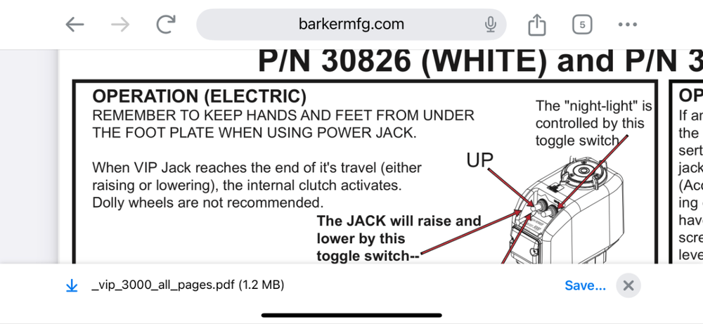

16 hours ago, jd1923 said:
Just because they don't say so, doesn't mean so! There is no clutch.
I know it’s the age of “alternative facts”, but I would hope that Barker wouldn’t be making up the “internal clutch” story out of whole cloth. Then again, perhaps they consider gear teeth slipping out of engagement as a “clutch”. I would also hope that they would give owners a warning that excessive “activation” of the “clutch” can lead to premature failure of the drive unit.
It also seems odd to me that the most important part of the jack gets no love, while the (optional, honestly) electric drive mechanism gets so much attention. Kinda like lubing the hood hinges on your truck while making it impossible to check or change the motor oil.
BTW - the documentation on the Barker web site for both the VIP3000 and VIP3500 show a “torque limiter” in the exploded parts view. Of course, if you’ve been inside the unit and don’t see such a device, then yes, maybe their idea of a clutch is gear teeth unmeshing.
The sound I hear at the end of travel doesn’t sound like teeth slipping. Just sayin’.

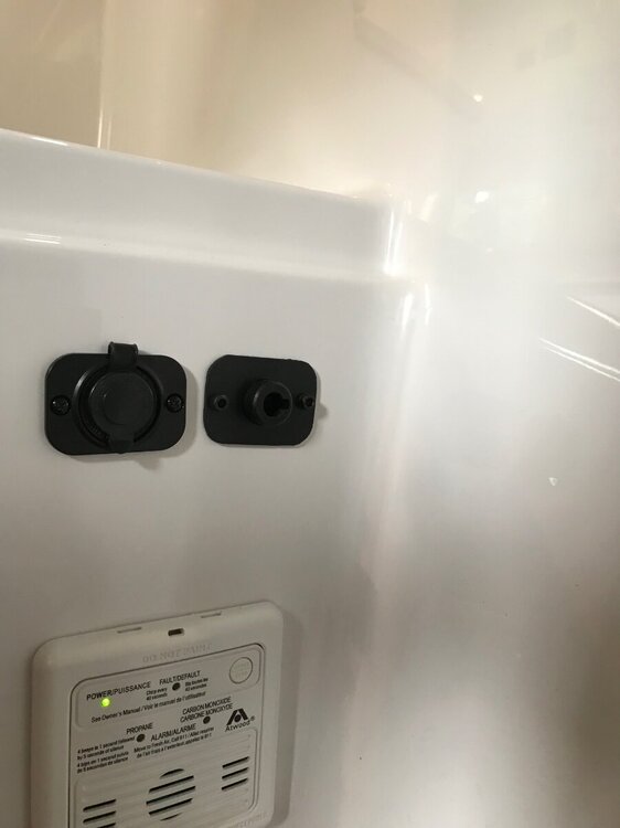

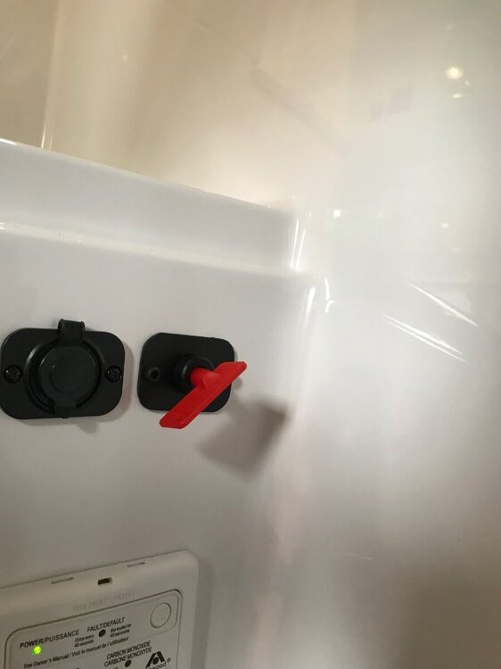

4 hours ago, mountainoliver said:
Seven years ago I added a master switch for the leveling jacks. I disconnect the power to the jacks whenever the camper is parked. My hope is that with three jacks firmly down it will be much more difficult to steal. Thankfully, as far as I know no one has ever tried my theory.IMG_0536.thumb.jpeg.689b242528ad30f4775c6068d4415ed4.jpegIMG_0537.thumb.jpeg.f5c916cc68169cab3057abd906e0720f.jpegIMG_0539.thumb.jpeg.152375e07a87df0a2b46f25ec227c21b.jpegIMG_0538.thumb.jpeg.3a4c75848c4c0cb09d5e6362380e2329.jpeg
Definitely a thumbs-up from me!
Did you pull out one of the DC “outlets” and use the hole for the switch?
Kinda surprised this isn’t at least an option from the factory. I think it would be more useful than the cell phone booster. I don’t even think that thing does anything.
