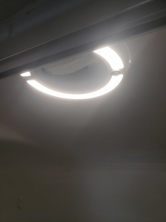

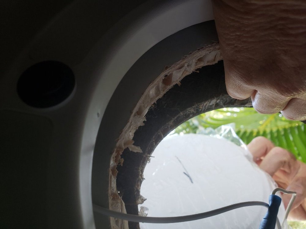

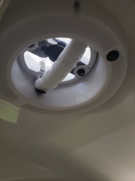

Moderators SeaDawg Posted November 30, 2020 Moderators Posted November 30, 2020 We installed the maxxair dome plus yesterday. Since Paul had already removed the old ventline and cleaned up the caulk on the roof, the install took less than an hour. (Would have been even less, but I inadvertently dropped the four screws for the interior trim ring into the shell and turf blocks where we park the trailer. Took a good five minutes to find them.) We bench tested the fan and light in the workshop before installing. It is indeed much quieter than the old ventline and the led light is very, very bright. The screen is indeed removeable from the inside for cleaning, but requires removing four tiny screws to do so. The handle for opening and closing is much beefier (our first ventline handle cracked), and it has a button to release. That motion is a bit sticky. The interior trim ring is almost 3/4 inch deeper, to accommodate the light, which might be important to taller people. I don't know about the trim ring on the unlit fan. We bedded the van with grey butyl tape before Paul fastened the screws. He added some extra at the curve of the hull. We'll run a bead of caulk around the ring when we do some other caulking. We did need the provided extension tube to reach through the two hulls. Paul cut it to length. We were able to use the original rough opening, without enlarging it, though it was very tight. The trim rings are larger in diameter than the ventline, so all original screw holes are covered . Maxxair provides a real gasket to seal the opening dome to the unit when closed, much superior to the foam weatherstripping of the Ventline. The unit itself is all plastic, but a thicker guage than the Ventline, and everything is white, inside and out. Hopefully, the quiet operation will last. I've read some reviews that the fan became louder with months of operation. We'll see. I ordered ours from rvupgrades. The price for the fan with light was just $4 more than amazon price for the fan without the light. Free shipping on $99 or more, so I bought a new water filter cartridge instead of paying $10 shipping. Sherry 3 3 2008 Ram 1500 4 × 4 2008 Oliver Elite, Hull #12 Florida and Western North Carolina, or wherever the truck goes.... 400 watts solar. DC compressor fridge. No inverter. 2 x 105 ah agm batteries . Life is good.
Moderators SeaDawg Posted November 30, 2020 Moderators Posted November 30, 2020 (edited) A few photos, and a video of the fan running. We had a good rain this morning, so I could check for leaks. Everything looks good. 20201129_124314.mp4 Edited November 30, 2020 by SeaDawg 3 4 2008 Ram 1500 4 × 4 2008 Oliver Elite, Hull #12 Florida and Western North Carolina, or wherever the truck goes.... 400 watts solar. DC compressor fridge. No inverter. 2 x 105 ah agm batteries . Life is good.
