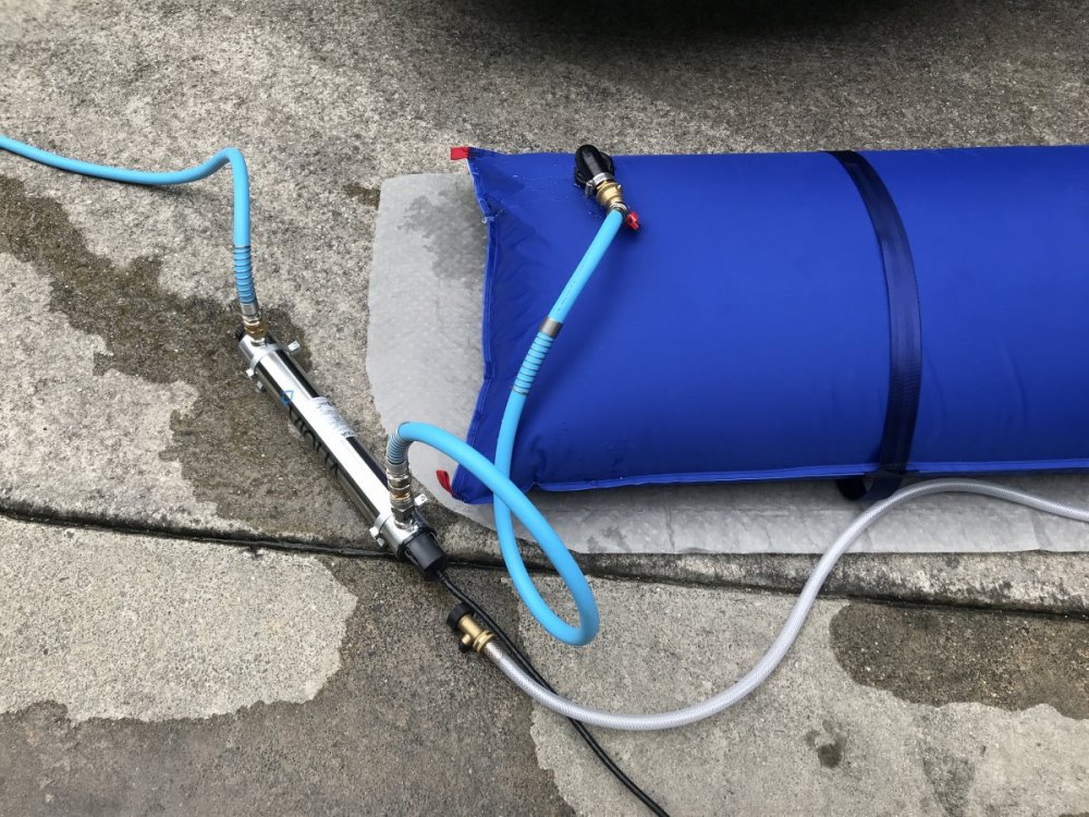

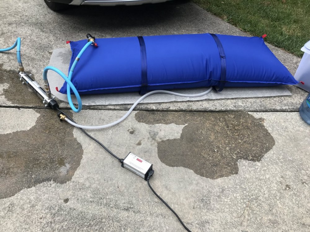

Overland Posted July 6, 2020 Share Posted July 6, 2020 (edited) Thanks for the photos. Is that a UV sterilizer on the water intake? Edited July 6, 2020 by Overland Link to comment Share on other sites More sharing options...

Seymour Posted July 6, 2020 Author Share Posted July 6, 2020 1 hour ago, Overland said: Thanks for the photos. Is that a UV sterilizer on the water intake? UV, yes. First through Katadyn silver impregnated ceramic. From streams and lakes. Testing throughout. 1 Link to comment Share on other sites More sharing options...

Overland Posted July 6, 2020 Share Posted July 6, 2020 8 minutes ago, Seymour said: UV, yes. First through Katadyn silver impregnated ceramic. From streams and lakes. Testing throughout. Neat - do you use a sediment filter first and do you need an auxiliary pump or can the Oliver's pump handle it on it's own? I also have to ask about your computer setup. That's a pretty pro looking mic, and I think this is the first time I've seen an iMac in an Ollie, plus a laptop. Do you record podcasts from your Ollie or something? Link to comment Share on other sites More sharing options...
Seymour Posted July 6, 2020 Author Share Posted July 6, 2020 7 minutes ago, Overland said: Neat - do you use a sediment filter first and do you need an auxiliary pump or can the Oliver's pump handle it on it's own? I also have to ask about your computer setup. That's a pretty pro looking mic, and I think this is the first time I've seen an iMac in an Ollie, plus a laptop. Do you record podcasts from your Ollie or something? Yes to all. Katadyn Expedition filter first followed by Viqua UV to purify. 1 1 Link to comment Share on other sites More sharing options...

Seymour Posted July 6, 2020 Author Share Posted July 6, 2020 My blue bladder is 52 gallons and I use it to transfer water with my tow vehicle. 1 Link to comment Share on other sites More sharing options...
Moderators SeaDawg Posted July 6, 2020 Moderators Share Posted July 6, 2020 I thought it was the expedition model. Pricey, but very fast, a long lasting cartridge. 1 2008 Ram 1500 4 × 4 2008 Oliver Elite, Hull #12 Florida and Western North Carolina, or wherever the truck goes.... 400 watts solar. DC compressor fridge. No inverter. 2 x 105 ah agm batteries . Life is good. Link to comment Share on other sites More sharing options...
Overland Posted July 6, 2020 Share Posted July 6, 2020 At 1 gallon per minute that's a lot of pumping to fill a 52 gallon bladder. But then that bladder plus the Ollie's tank would give my wife and me 15 days of water. 2 Link to comment Share on other sites More sharing options...
Seymour Posted July 6, 2020 Author Share Posted July 6, 2020 2 hours ago, Overland said: At 1 gallon per minute that's a lot of pumping to fill a 52 gallon bladder. But then that bladder plus the Ollie's tank would give my wife and me 15 days of water. For me, it replaces going to the gym. I fill 5 gallon contain and then transfer into bladder 5 gallons at a time. I also use iodine tablets in bladder and then transfer into Oliver through UV purifier. Drinking water from each tap. The Oliver fresh tank material concerns me a bit but so far, so good. Link to comment Share on other sites More sharing options...
