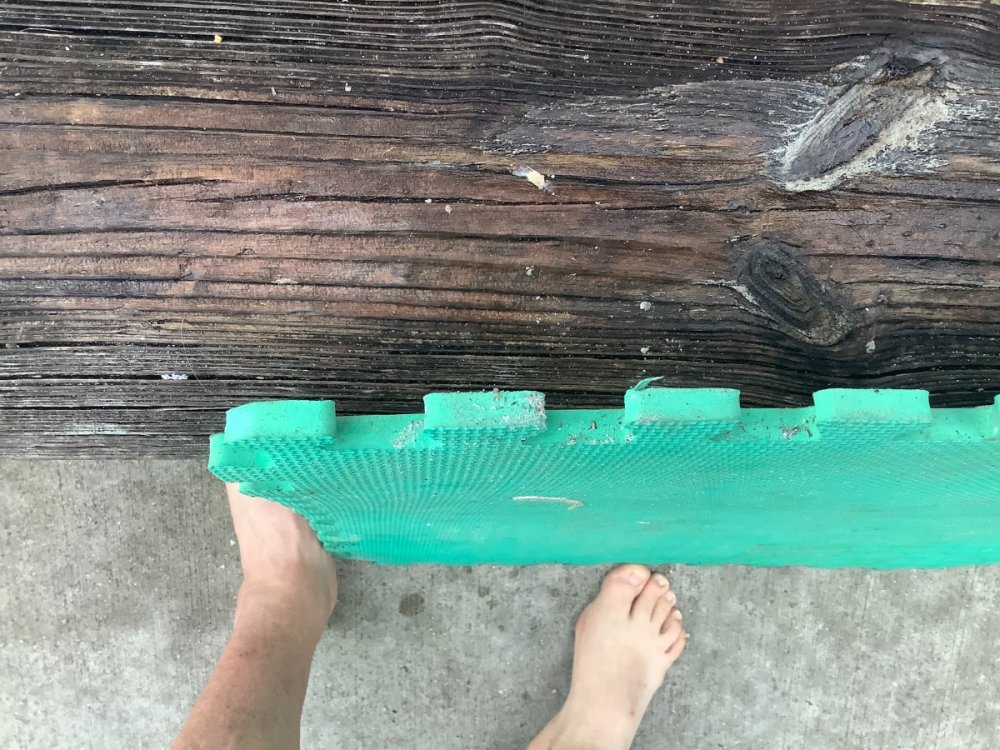

Hey there John, I’m not sure if these would work for you, but might be worth considering... They are 24”x24” and lock together like a puzzle. They are about 1/2” thick rubber, and as tough as nails. They are easy to cut with a utility knife. We had hundreds of them to protect finished floors and counter tops on construction sites, and the uses for them seemed endless...I’ve got ten of them with us on the road now.. They had them at HD for a long time , probably still do.. 20 bucks for 4 of them as I recall.....620751F8-4DC1-4142-A8C1-734C1AEA2B7C.thumb.jpeg.1a5d94eacbe6db397d0192c5cbb63992.jpeg3E1B09E4-6EAF-4DCD-8B13-6245E3AEAC60.thumb.jpeg.e22654a165c5b4c824f9b67a433b29dd.jpegDAA8A0A7-D2BD-41A3-91C6-BE42027B92FA.thumb.jpeg.995a2809bf0b177539f39ccfff500f7f.jpeg

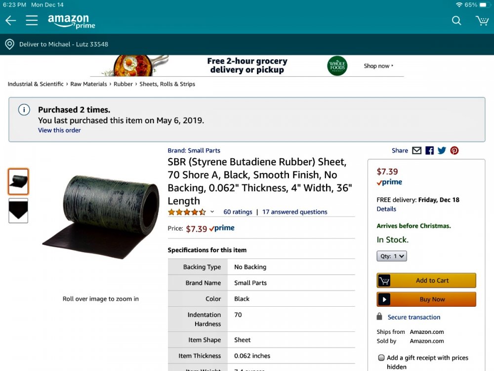

This stuff is very tough and thin.  Might do the job you described.

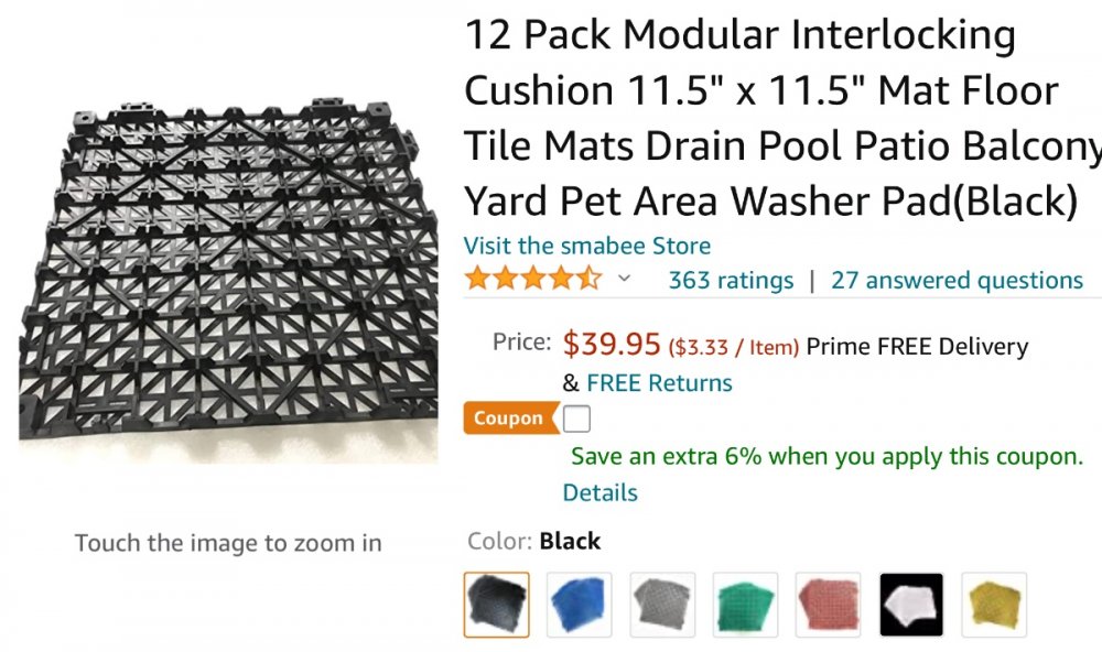

I am now leaning toward a thicker pad, one with holes molded in. I hope to mount a big computer fan under the box floor to circulate cabin air up through the compartment and out the top. So a firm (NON rubber) layer would be excellent in terms of allowing cooling/ warming air to flow around the bottom of the batteries. I like the “egg crate” design, but want something that is solid through its thickness, not depending on widely spaced little legs to support the weight. Like this, but more heavy duty:
Any ideas about this? Has anybody seen a flat panel of egg crate plastic, that doesn’t have a a recessed bottom or sides?
