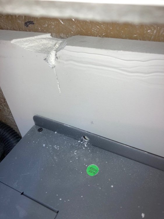

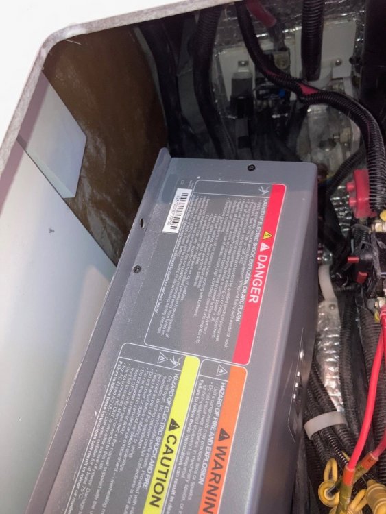

I looked at the buss bar, and found that the inverter had ripped out of its mount, and was resting on top of the buss bar, able to blop about and bang into the circuit breaker. That was probably causing the issue.
Only the top two screws were used to mount the inverter. The bottom two had not been installed, or there was no hole that showed that the two bottom screws had been installed. I assume that the bottom was able to come away from its mounting board, stressed the top two screws causing one screw to strip out and one screw to fracture the plastic (resin?) mounting board at the screw.
I'll replace the mounting screws, in new holes, of course, and see if the light issue stops, which I expect it to do.

Really disappointing to see that mounting problem with the inverter.  I’m usually pretty impressed overall with the Oliver design and engineering but then stuff like this pops up with brand new trailers.  Just two small screws holding that inverter was a failure waiting to happen.
Link to comment
Share on other sites
If you haven't already done so, please open a service ticket. Include those photos.
Though I  know you'll fix it yourself, that's a quality control issue that Oliver should be made aware of.
