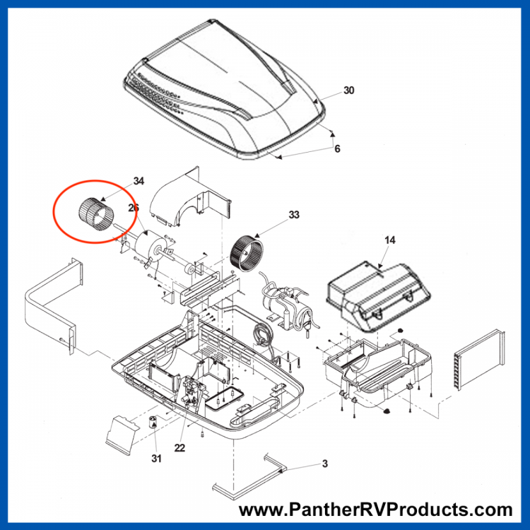

We have an E2, hull # 701.picked up in mid December. Just trying our air conditioner for the first real test.  As soon as it started up, we could hear what sounded like the impeller was in contact with something that caused a loud noise.  Seems like the blades are still turning but contacting something they are not supposed to be hitting.  I looked at the AC material supplied by Oliver but there is no model ID info.  I tried to call the company directly but their initial phone message stated that customers needing tech support need to have the model and serial number.
-  does anyone know where to find that information?
-  has anyone had a similar issue and, if so, how did you deal with it?
We are happy to open the housing to see what there is to see.  Hopefully an easy fix but not sure whether to lift the shroud from the top of the camper or if there is a way to see the guts from inside.

You need to remove the roof shroud and look for the model and serial number information, it should look something like this one (this not an Oliver AC picture):
It is too bad they didn't write it down, you should have a page with all the appliance models and serial numbers. I don't have a clue about the fan noise, you can run it while the large cover is off, don't get hurt, watch to see what is happening. With power turned OFF you may be able turn the rear fan by hand to feel for binding. It may have a screen over it. The front (compressor) fan is going to be hidden by a cover.

I pulled the shroud today and, sadly, no birds or bees in there.  There is an insulated cover inside and a plastic housing above the impeller that blows air into the trailer.  Didn't have a chance to dig too deep but looks like part #33 from john's diagram, may be rubbing Slightly against something.  Also found a 2" bolt laying loose in that area.  May be at the heart of the problem.
Will get out again and do some more analytical digging.  Will take Russel's wise words into consideration and pick up some sort of cover for the unit to minimize the chance of critter infiltration.  Am also going to take Overland's suggestion and see if I can figure the problem from inside the trailer.

GAP - we have also noticed this fan scraping noise.  we did not notice it last year on our pick-up return trip from TN to ND, which may be a factor.  it is very apparent when the AC turns off, and 6-8-10 "tick-tick-tick" noises before stopping (sounds more like a 3-4 blade propeller, not the squirrel type cages as in JD's provided diagram) prior to that, the rubbing however is masked by the "SLIGHTLY (ha-ha) NOTICEABLE" noise of the thrust of the AC.
i will read-up on it, and figure how to remove internal covering.  i do not think it is insects/birds related, but we will see, when i get the cover off.

Ok - I fixed my POS Dometic AC fan noise.
The squirrel fan that feeds the interior had come loose on its shaft - allowing it to slide back and forth to scrape against the housing  shroud - The tick tic is the fan. An allen set screw had loosened up just enough to allow the fan to slide.
You need to remove the top side cover 4 Philips screws - then the insulated cover, it slides up, - then the plastic cover, 6 hex head screws.  There are also some plastic tabs that need to be unclipped. The fan shaft will slide back and forth some - but the fan should be tight to the shaft - it should sit flush with the end of the shaft.
You do not need to remove the interior cover.
All ok now - jet engine dB's aside.

So, I figured out and fixed the problem with the air conditioner.  Turns out that the bolt I found came off of one of the two forward facing motor mounts.  This allowed the motor to twist a bit and had the front impeller scraping slightly against part of the plastic AC housing.  The noise was super loud when we first heard it and "clanky" which was probably the impeller scraping the head of the bolt that sat loose, under the blades.  Looks like no damage done.  Reinstalled the bolt and added a nut with a little loctite to both the screw ends so they could not shake their way loose again.  The bolts screw through a rubber doughnut style mount with nothing to hold them in place so I am betting I'm not the only one who has had this problem.  Still plenty loud but that must be the native noise that always comes out of these units.
