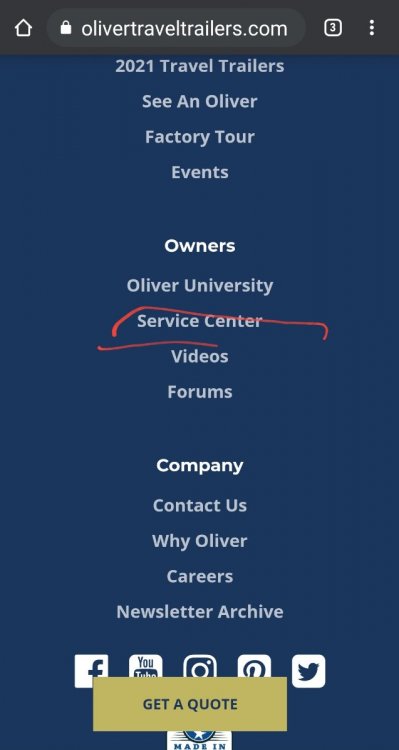

Moderators SeaDawg Posted June 1, 2021 Moderators Posted June 1, 2021 9 hours ago, Erika E said: I guess I should call Oliver service to verify part. Will be my first time calling them direct. Not sure what size that is yet. Will investigate more soon I've found I get a faster response by opening a service ticket. You can do that by clicking on the "home" button at the hamburger menu, then scroll to the bottom, and click on "service center" 1 2008 Ram 1500 4 × 4 2008 Oliver Elite, Hull #12 Florida and Western North Carolina, or wherever the truck goes.... 400 watts solar. DC compressor fridge. No inverter. 2 x 105 ah agm batteries . Life is good.
