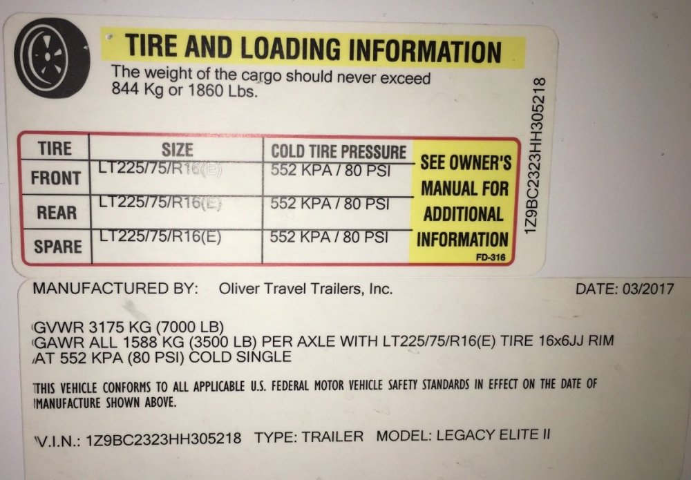

Some real numbers on our 2019 Elite II if that helps:
This is from when we were towing our EII with an F150.
Our EII as weighed below was fully loaded including dual 30G propane, water, 4 AGM Batteries, clothing on board and food and an 60lb box of gear on the tongue.
Our unit has solar panels and the tongue box is used for chocks and tools.
Tongue Wt ib this weight at this stop was 665lbs...( varies from 530-675)  depending upon full water, and junk in the closet and tongue box.
Our 2018 - F150 had a GVWR of 7100 lbs --- and I was towing 60 lbs over GVWR on that particular run.
Ultimately I upgraded to an F350 for towing.

Please consider this from someone that has towed both models. If you try to to tow an Elite II with that little truck, you WILL have a problem and be disappointed, very disappointed in the towing experience. As John said in another thread, "you do not have enough truck for an LE2". I would say it is doable for the Elite I. Everyone looks at the towing capacity and hardly gives a second look at CCC. Depending on options and trim level, your 2020 Ford Ranger has a maximum CCC of 1560 lbs. Check you driver's side door jam for the actual number. Likely, your occupants and tongue weight will eat up half of that. An Elite II will weigh well over 5000 pounds. Ours weighs 7000.

He was trying to make a sale, buyer beware! A fully loaded LE2 is 7000 pounds. The earlier hulls tend to be lighter than current models because they came with more options (less standard equipment) so you might encounter a stripped down one that is lighter than average. But “fully loaded” means “at gross weight” (aka GVWR) - so regardless of the dry weight a fully loaded trailer will always be 7000… it is the payload that varies. Oliver claims the 2022 LE2 is “4900 lbs dry”, but options like four big lead acid batteries, solar panels and the extra awning really stack on the extra weight. My moderately optioned 2017 had an “as delivered” dry weight of 5140. It is very easy to tell by the payload sticker if a seller is trying to blow smoke up your posterior.
