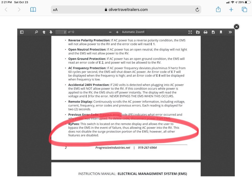

I don’t know if there is a fuse or reset button.. but there is a bypass switch..
here are a couple of potentially helpful bits from the owners manual… maybe a wire rattled loose

I tried this by pass switch still no ac power
