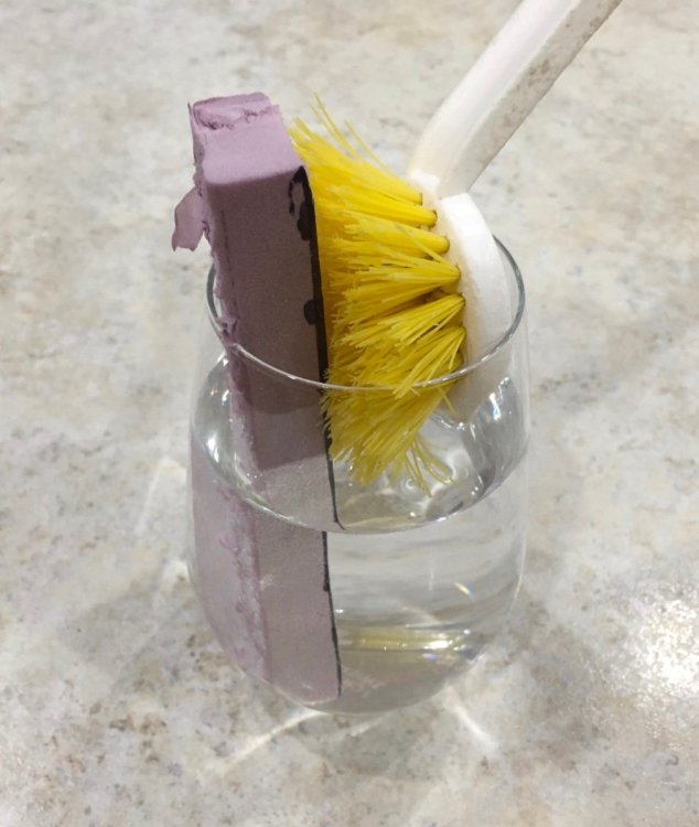

Please post pics. Rigid board is completely closed cell, meaning it is waterproof and doesn’t breath, even a tiny bit, which is the type you used. I am actually surprised it proved to be effective, after 24 hours of soaking my test scrap absorbed no water. Wouldn’t an open cell or grooved material be better, to allow air to flow under the mattresses? I had to wedge this in place, it would pop out like a cork from a champagne bottle otherwise….
At the very least, I think using a compact circular saw to cut a bunch of shallow channels on the side that contacts the mattresses might be prudent. I have never heard of a “vented” foam board, but you could certainly make your own😬

JD's "soak test" in his post above is a bit of a waste of time in that at least both sides of most construction foam board that I've seen is covered with a thin sheet of plastic which would , obviously, prevent virtually any water from penetrating into the foam - let alone the density of the foam itself.  In this regard and to certainly prevent the intrusion of water of any kind, I even went further and sealed all of the cut edges with clear tape.  This also has the added benefit of keeping things a bit cleaner and helps satisfy that OCD nature that is not the private domain of virtually anyone.
