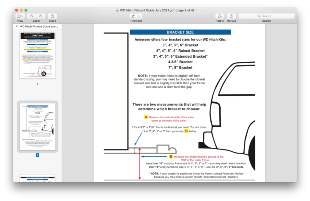

Nick and Linda Stratigakis Posted December 10, 2021 Author Posted December 10, 2021 Thank you all for your comments. I did check with my Ford dealer this morning and he confirmed that Ford requires the WD hitch for my model truck. Reading all the available posts that I found it is my understanding that the Andersen system is the most desirable for the Elite II. I believe that I have all the info/specs that I need selecting the correct WD hitch with the exception of the Bracket size and so far I have been unable to find what I am looking for. I am looking for the A vertical width width of Elite II trailer frame at the front B height from the ground to the TOP of the trailer frame if anyone can help providing this info will be great and time saver for me.

Nick and Linda Stratigakis Posted December 10, 2021 Author Posted December 10, 2021 Agree, my request was not clear enough. The attached page may be better explaining what I need concerning A and B
Moderators topgun2 Posted December 11, 2021 Moderators Posted December 11, 2021 Duh! Got it now. I'd get those measurements for you but my Oliver is in "off-site" storage for the winter. Another way of getting it is to contact Oliver Service - call or use a service ticket - and they can tell you what they install. Note that in most applications for the Oliver you will need chain extensions. You could also contact Andersen and ask them which setup is required for the Oliver. Good Luck! Bill 2023 Ford F150 Lariat 3.5EB FX4 Max Towing, Max Payload, 2016 Oliver Elite II - Hull #117 "Twist" Near Asheville, NC
SteveCr Posted December 12, 2021 Posted December 12, 2021 2021 LE2 Hull 806 A = 5" B = 22 1/4" with the trailer leveled 2
SteveCr Posted December 12, 2021 Posted December 12, 2021 It's a wet night here in NC. Here are bracket pics...the measurement is from the top edge to the bottom. 1

Rivernerd Posted December 13, 2021 Posted December 13, 2021 4 hours ago, Nick and Linda Stratigakis said: Thank you all for your kind assistance and advice. I now have what I need. I have been following this thread because, like you, I plan to buy an Andersen WD hitch and install it myself after we accept delivery of our Elite II next summer. My conclusion from the measurements provided by SteveCr is that Andersen model #3324, for 3,4,5,6" high trailer frames, is the right one if you need 4" drop/rise with a 2" ball. If you want a 2-5/16" ball, then #3350 is the correct model number. Do you concur? Hull #1291 Central Idaho 2022 Elite II Tow Vehicle: 2019 Tundra Double Cab 4x4, 5.7L with tow package

Nick and Linda Stratigakis Posted December 14, 2021 Author Posted December 14, 2021 Absolutely agree for the Andersen model # 3324. This is exactly what I need and I may want to upgrade to a 2-5/16 ball if I do not have a problem with the tailgate. I read somewhere in the various posts that there may be an issue lowering the tail gate all the way and I can’t remember but someone suggested using an extension. Don’t know if this will become an issue. As far as the mileage is concerned with the F150 I regularly tow my 20 trailer with a 5000 lbs farm tractor or a 5000 lbs lifting capacity forklift at an average of 14 MPG. Granted not long distances, around 150-180 miles . We will see how it works out for me on first trip.
