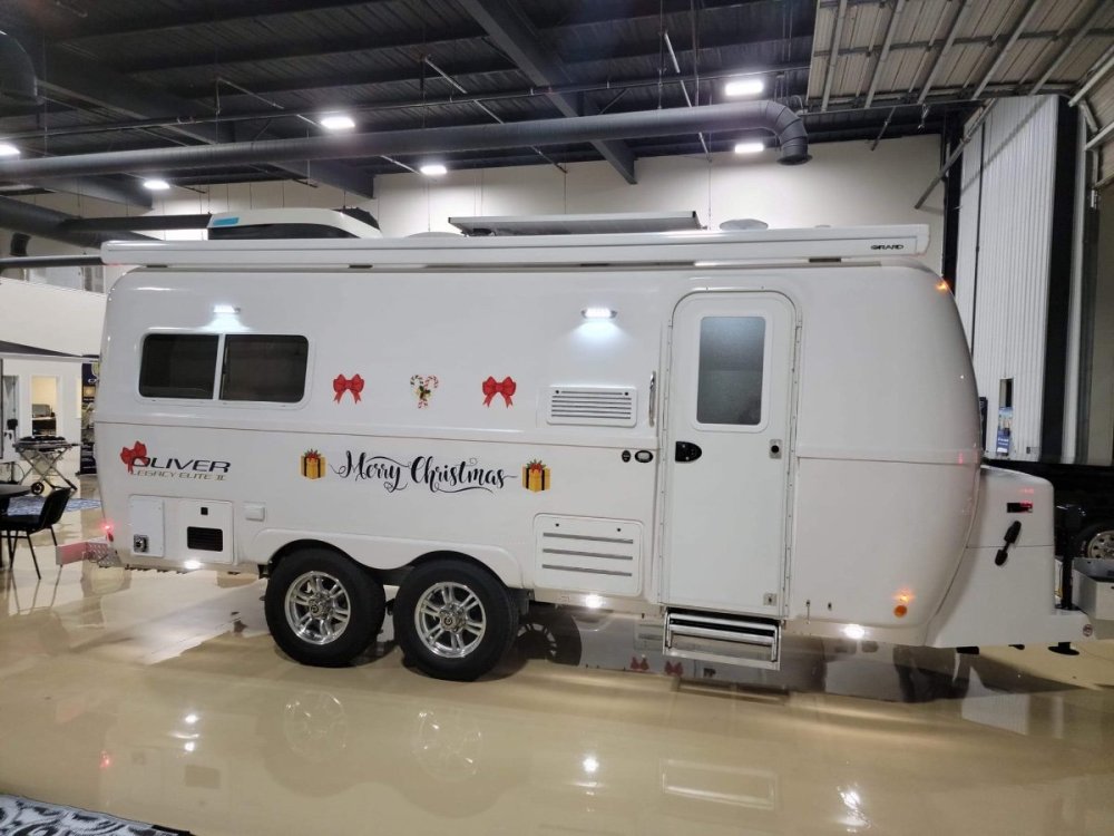

Sorry nothing to report from experience.  However, I think Oliver is testing my new AC unit to be delivered this spring!?? (I have no idea what version it is but it’s on the FB page).
Interesting.  Doesn't look like a Houghton.

Here is another view…
Edit: one advantage of this unit for the Oliver is it can be hardwired in with a Truma CP plus.  I really hope they’ll push this through quickly!

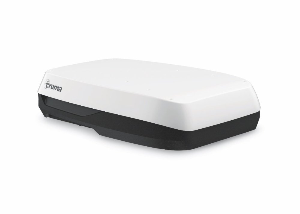

TCA Now Testing New Truma Aventa Air Conditioner
5F48C8A0-88BA-4D18-A3A0-7061136F13F9_1_2
Truma North America will soon be supplying the US RV market with premium Truma Aventa rooftop air conditioners. The Truma Aventa will be offered in two models that minimize noise and maximize comfort in a modern, energy-efficient, low-profile design. The Eco model will offer a 13,500 BTU cooling capacity, while the Comfort model offers 15,000 BTUs. As part of this release, Truck Camper Adventure is testing the Aventa Eco model for use in truck campers and vans. Both Aventa models will be offered in black and white.
Truma has been selling Aventa air conditioners in Europe and Australia for years, but the North American Aventa was designed specifically for the warmer U.S. marketplace.
Numerous partners, including Truck Camper Adventure, are testing the two air conditioner models this summer before the Fall 2021 release.
TCA is testing the Eco model using both shore power and off-grid power. The latter system found in the Truck Camper Adventure rig consists of an Expion360 360 amp hour battery, a 500 watt solar power system, and a 3,000 watt inverter. Testing is being conducted across the country, including in the dry heat of Arizona and in high humidity areas in Texas and in the Midwest.
Compatible with both ducted and non-ducted systems, the Truma Aventa comes standard with many advanced features, including an automatic cooling mode, a dehumidification mode, a night mode, an air circulation mode, and three manually selectable fan speeds (low, medium, high).
Significant noise reduction, which has always been an issue with RV air conditioners, has been achieved in the Truma Aventa by using a thick, noise absorbing EPP foamcore, while the compressor is mounted on shock absorbers to avoid vibration.
Based out of Elkhart, Indiana, Truma has a long history of providing high-quality solutions to the recreational vehicle market and is the manufacturer of the excellent Truma Combi water heater-furnace, Truma Varioheat furnace, and Truma AquaGo water heater.
This is a developing story. Check back for details as the results of our testing becomes available.

Interesting that the Truma previous largest version was this 2400 watt unit.  Mathematically speaking, 2400 watts cooling capacity is only 8,189 BTU's.  it also is a 230V unit.
It would appear that Truma is "Growing" their capacity for the US market (13.5K and 15K versions) and they most likely will be 110/120V units.  Should that be the case, they IMHO are targeting trailers needing more cooling than the OEII needs.  Can't wait to see how the testing goes and learning what models are actually being produced.  If the above press release is complete, and the only options are 13.5K or 15K, then the OTT shown would most likely be a 13.5K BTU and that's oversized from at least one perspective.
