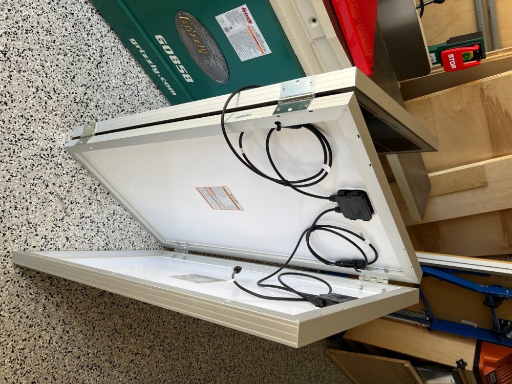

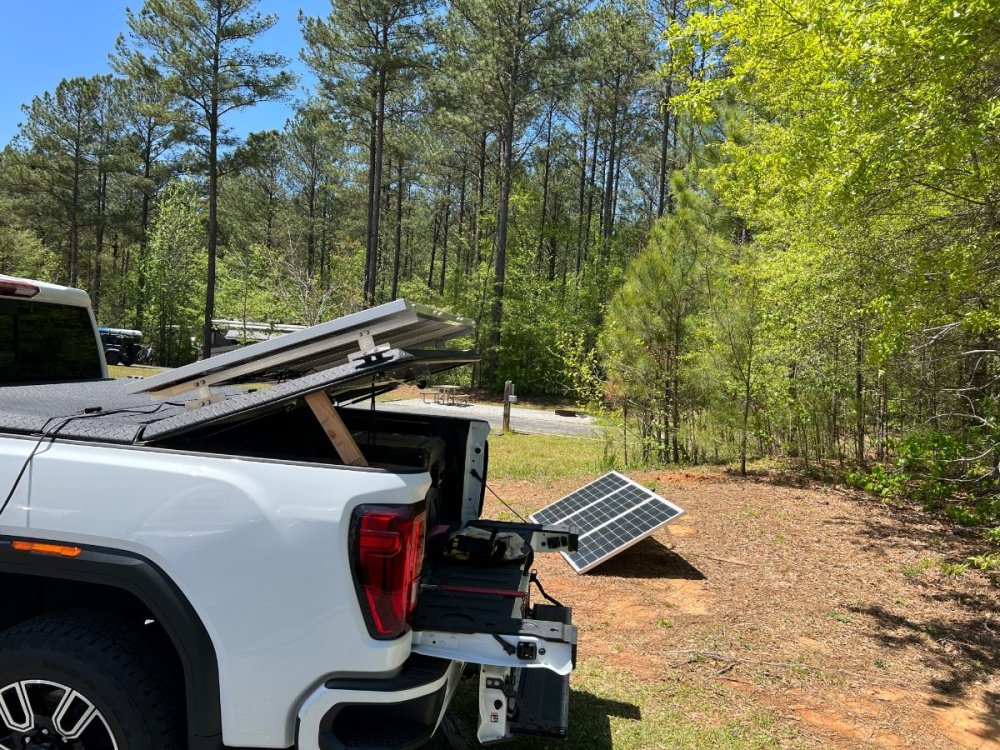

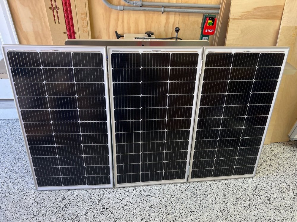

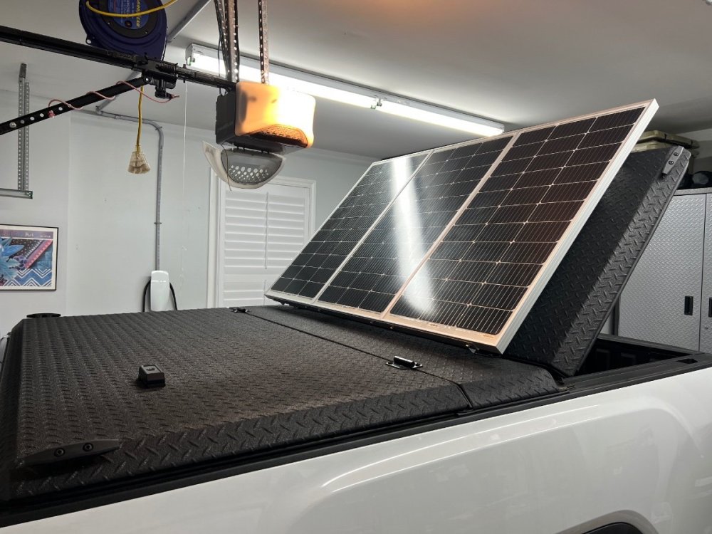

I put this setup together to augment the one I built for my trucked cover.  I can connect all the panels in series/parallel for a total of 940 watts. (including the ollie roof panels) These are BougeRV 100 watt 9bb panels.  Much cheaper than the portable offerings from Zamp.  Hopefully I will be close to net zero while running the Houghton AC in full sun.
IMG_1682.thumb.JPG.b2d4220f6bd06dfb14af79a214a775a2.JPGIMG_1679.thumb.JPG.63074a5351771d1fd440429d8a1311df.JPG148951528_IMG_12682.thumb.JPG.8ef13efc5b6757ea6215e7d6076f50dd.JPG
John and Kim
Very nice setup! 👍
Nice how you can angle the panels with the bed cover when you're parked.
Yeah, I went through different configurations and panel sizes in order to make that happen.  I didn't want the panels to hang over the back in case a stray rock flew up while underway but it could only go so far forward to allow fully opening the cover. In the morning and afternoon that angle can take the truck array from around 230 watts to 290 watts.  Every little bit helps.😬

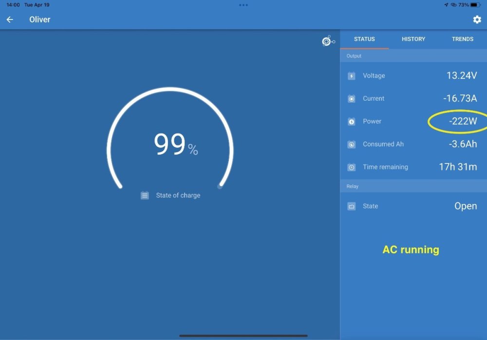

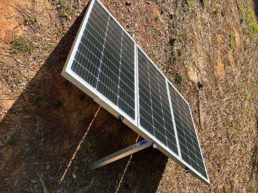

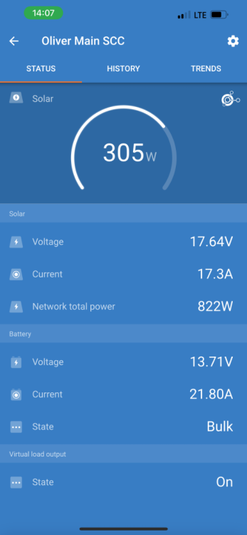

Did a quick 2 nighter and was able to do some testing.
IMG_1716.thumb.JPG.8ac62286e6b40677680a662a2b681585.JPGIMG_1717.thumb.JPG.945bdd8c1fabf661609fbf728733969d.JPG
 I had a full sun day just southwest of Atlanta and using the truck bed, portable setup and the Oliver panels I was able to pull in 5.82KWh over the whole day.  I lost sun due to trees at around 5PM so I could probably hit 7KWh in the clear. At the peak the total network power on the Victron showed about 822 watts.
 With the Houghton running I was only showing a 222 watt deficit but since the air cycles the batteries would catch back up.  Over all I am pretty satisfied.
