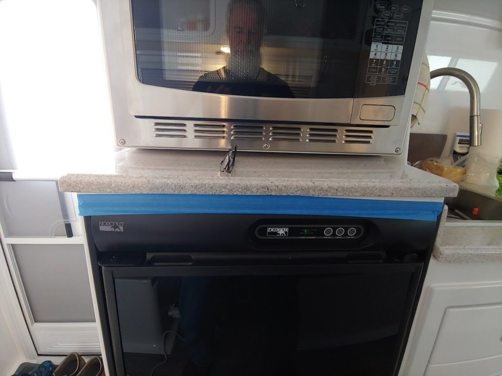

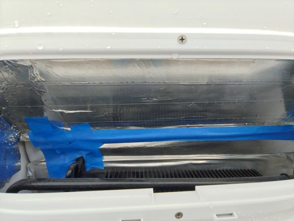

Last night at Tunica I noticed a very cold draft from the top of the refrigerator, above the frame and below its fiberglass enclosure.  The wind was very strong from that side so I took the outside upper vent cover off and discovered a large gap all the way across where insulation mats meet.  A good 3/4 inch gap.  I taped it up with some low tack tape as well as the top of the refrigerator inside the trailer.  Pictures below.
Question #2...Is there supposed to be a gap there?  I'm leaving the tape there temporarily to block the 30 degree breeze I'm getting from the outside.

We have a different refrigerator, but a gap that lets in cold air does not sound right.

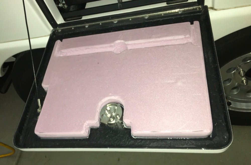

If you want better insulation for the basement you should put rigid foam on the outside door, and also put something in the shower cavity, A nice “future Ollie feature” would be vacuum molded insulated access and battery doors, with an inch of foam sandwiched by fiberglass panels. It would intrude very slightly into the cargo area, but would greatly reduce cold air infiltration. And it would not be butt ugly like my battery door mod.
