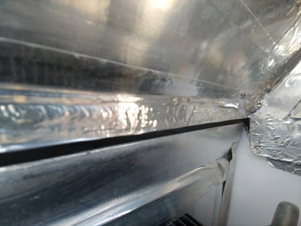

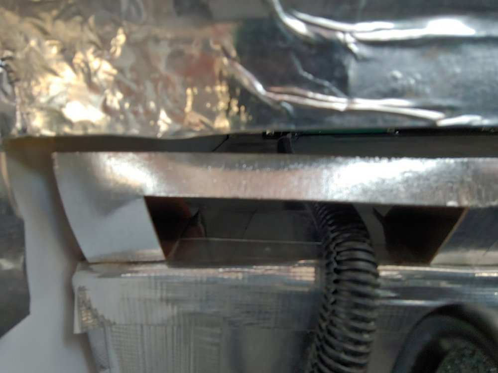

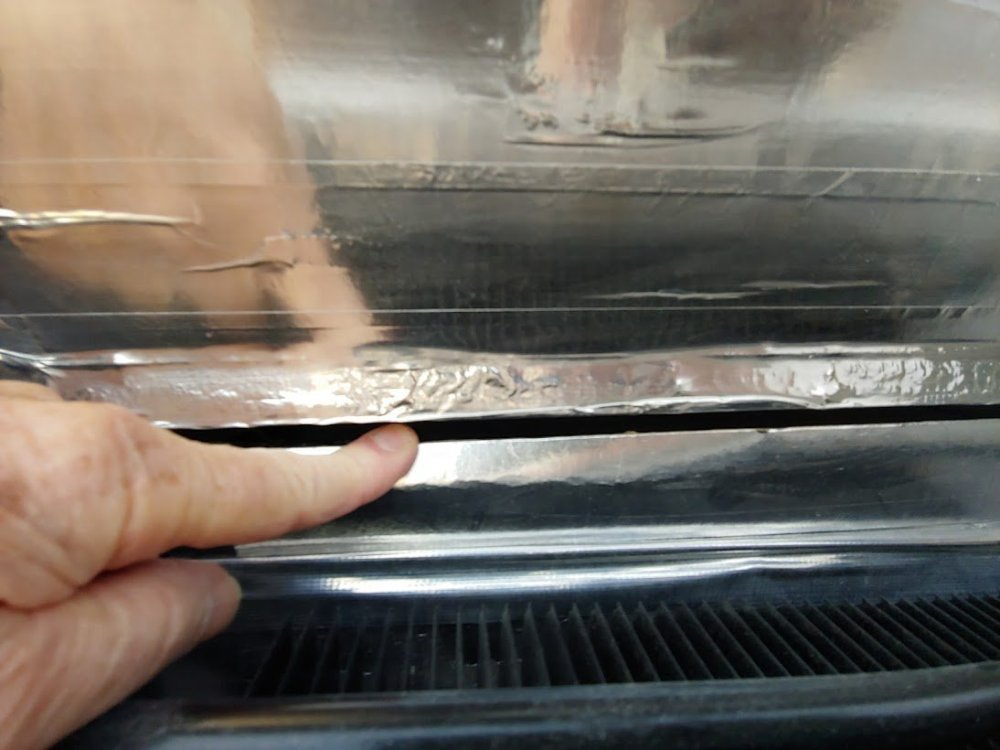

The Norcold fridge in my 2022 Elite II leaks air inside the trailer cabin.  The very cold winds are blowing directly into the vents from the outside and into the cabin.  It seems to be coming in from between the fridge frame and the fiberglass enclosure on the inside of the trailer.  Is this a common problem?  The volume of air is not horrible but is very noticeable when walking by, especially at 18 Degrees F.  I see a gap between insulation pads when I take off the cover, 1/2 to 3/4 of an inch, but Jason E. says that is by design and must not be taped over.  Any suggestions?  I may run a bead of silicone around the frame.

This is not the first time lately that I've heard a new owner complain about air entering the cabin around the refrigerator. Take off the upper outside cover and see if there is a gap in the insulation or the metal tape used to seal everything. Cover any holes with duct tap until you can get something better. I would start a service ticket also.
There is no reason air needs to pass around the fridge into the cabin. In fact, it shouldn't. That's a propane burning appliance. The rear of the fridge should be exposed to the exterior vents but the front of the fridge should be isolated from that service area. Take photos and start a service ticket.

I contacted OTT and was told to not cover the openings.  It will void the warranty.  Here are some pictures.

From https://askthervengineer.com/the-essential-guide-to-your-rv-absorption-refrigerator-and-why-it-doesnt-work-in-the-mountains/: "All that heat from your fridge’s interior has to go somewhere! And when burning propane, the fridge releases toxic exhaust gases, too. You don’t want either of those things inside your RV. That’s why your RV is installed inside a sealed compartment and the hot gases are exhausted through your fridge vents."
I can't understand why OTT says that gap should remain. Is there another seal behind that gap?
If I felt a draft, I would seal around the fridge opening inside the trailer. Duct tape is fine, wherever you feel a draft.
I wouldn't mess with outside venting.

I think there was a mis communication between you and Oliver. I think that they thought you were suggesting covering the inside of the vent covers or the hole (openings) that they fit into. I think that you were referring to any gaps in the insulation (as I was) that seal the refrigerator to the hull.
