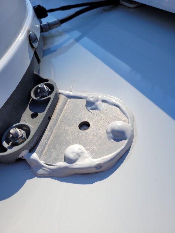

Can anyone tell me what kind of caulk this is from this photo?  Bonus points for a product name. It is used on the rooftop appliances. It was put on 2 weeks ago (Oliver Service) and has a kids playdo like texture.

Only Oliver Sevice can tell you for sure, but it looks like the standard Dicor Self Leveling sealant used on RV roofs everywhere. It is quick and easy to apply, so less man hours, and it looks like crap. I personally would be quite pissed if they did that to my trailer. That is for stick and staple Elkhart trailers with rubber roofs. It requires routine inspection and touch up.
https://dicorproducts.com/product/epdm-self-leveling-sealant-for-manufacturers/
Trailers with “boat hulls” should get marine sealants. I will probably never return to the factory, but if I did and they were going to seal something up top on “Mouse”, I would tell them what type to use and have them charge me for the extra cost and labor.
I agree with JD on the product ID and with his assessment as to the job that was done in the picture.  However, Dicor can be made to look presentable but it takes a fair amount of work and/or skill to do so.
100% with John here. I don't know why OTT uses Dicor for this. It's safe for rubber TPO/EPDM roof membranes, but that doesn't apply to Olivers. On the fiberglass sides of all my RVs I've always gone with Geocel Pro-Flex RV Sealant https://www.geocelusa.com/product/pro-flex-rv-flexible-sealant/ . Very nice stuff and seems way more appropriate for the roof penetrations on an Ollie. It doesn't chalk up and crack, either. Sorry to see that picture.
The bracket in that photo doesn't even looked sealed. There's a section where the Dicor didn't even touch the roof, a gap where the bracket bends up by the bolt, and that open hole in the middle. Seems like a lot of places where water could get in. Hoping there is additional sealant underneath, around the roof penetrations...

I'd ask Oliver what they used. PIiant  isn't necessarily bad. Good caulk needs to flex like the trailer hull.
I'll reserve other comments til you find out what they actually used.
Well, it's settled then...we are all in agreement with JD.  We had never seen this stuff before.  We have only ever owned fiberglass (Casita prior) and I think with the large step up in price we expected much better.  Thank you all for the comments and education!

I've been doing some online reading. There are several different roof sealants that manufacturers use on fiberglass trailers. Dicor lap sealant is one of them and I found a lot of posts referring to its use on various makes of fiberglass trailers. It is messy, but by most accounts it flows well to seal cracks. It does break down faster than some but is easier to maintain with a top coat or remove and replace. So, it looks like it's an acceptable sealant for this purpose. And, of course, we still haven't heard if it actually is Dicor up there.

The Oliver service department utilizes ASI 335 white & clear silicone, Red Devil butyl sealant, butyl tape, and Dicor self-leveling sealant to re-caulk/reseal the exterior of your camper.  This process is based on years of experience here in the Oliver service department addressing and preventing leaks on our trailers.  The primary goal when re-caulking/resealing at service intervals, especially roof penetrations, is ensuring there are no leaks.  The roof is an area that is not typically seen unless you climb up on top but, again, is the most likely area for a leak to occur.  Due to Oliver’s double fiberglass hull construction, any leaking water is trapped between the hulls until the water can find an escape point.  Those points are typically a window cutout or one of the weep holes in the lower outer shell.  Windows being a primary entry point often leads to an initial diagnosis that the window is leaking which is not necessarily the case.  During the yearly maintenance, the exterior is sealed with the appropriate ASI 335 silicone.  Once the silicone is cured,  bolts and screws located on the roof then have an additional application of self-leveling sealant to provide an additional layer of protection, again, these areas aren’t typically seen to affect the aesthetics of the trailer.  The additional layer also helps protect the silicone from sun exposure as well as sealing the head of screws and/or bolts.  This precautionary step can be removed from the process if you prefer to have neat caulk seams over the extra protective layer of self-leveling sealant.  The primary goal here at Oliver is to provide you the customer with a trailer free of leaks for enjoyable camping adventures.
Whatever the service department used last year to "re-caulk" our 2020 still has a tacky surface and collects dust and road grime.  It does wash off but looks terrible after each time out on the road.  Additionally, that sticky excess that was wiped off during the re-caulking makes it look like the caulking gun was given to an impatient teenager.

Thanks for jumping in with that clarification, Jason! Are new units double-sealed this way, too? Roof leaks are the bane of every RV owner and one of the primary reasons we chose Oliver. Glad to see you're taking this extra step instead of just relying on a single glop of Dicor to do the trick.

No, not every penetration, best I can tell.  I don't see any visible caulk on the surface of the legs that the solar panel is attached to the roof by. I don't know how original caulking during installation of that was handled...I'm certain there would be something at the point of entry that is underneath the plate base, hidden from view.

I fixed that statement for you. 😬 I suggest that you seal it properly, regardless of what Service says they try to do….. that bracket is a mess. At least fill the center hole so water can’t pool in there and freeze….. How do the other ones look?
