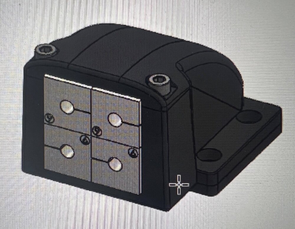

The Icotek entry solution you were looking at could be installed by drilling two holes with a hole saw vs. cutting a rectangular opening. You only need the double grommet version with four 5mm holes in each and one plug. The cut-out size on this item is 43 × 24 mm. I'd bet 2x a 7/8" hole saw would be perfect! VHB the housing onto the roof and caulk the perimeter. 90 Degree Cable Entry Frame - 2 Socket - 73mm x 53mm – MobileMustHave.com
Your last edit sentence finally gave me a reason for mounting the router in the Oliver! Thank you for that. There is one downside though, depending on where you travel. Out here we camp in many canyons without cell service. So, you would not be able to connect the Blink cameras anyway. When this occurs, we run the TV out of the canyon on a day trip and connect, use our laptops, etc.
The Pepwave router also has the WAN input to add Starlink or like service. If you were to go this route, you would nearly always be connected. Mike also did a nice Starlink antenna install up front and he ran the cable all the way back on the roof. You could do the same front install and run that cable down the same entry point.
If this upgrade may be in your future, buy this Icotek instead and drill 3 holes. Use a grommet plug until you need the 3rd opening: 90 Degree Cable Entry Frame - 3 Socket - 100mm x 53mm – MobileMustHave.com

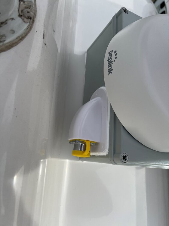

I received the IcoTek 90° cable entry kit from MMH today. It's going to work great, and I won't need a box. I'm going to test drill different diameter holes in some thin plywood, and see how small I can go and still get all seven wires through. Then I'll go with the next larger size that I can find a grommet for. Antenna will be on a mast bracket hanging from the rear awning mount.
As previously noted, my Pepwave MAX BR1 Pro is in the attic, and currently using the stub antennas. Yesterday I added a second SIM card from T-Mobile that I got through FMCA. Three months free (from my Mobile Internet Resource Center membership) gives us time to compare it with the Verizon plan through MMH. The router feeds my Apple TV and UefyCam security camera hub via Ethernet, and our phones, tablets, and Sonos Move via wifi. Later I'll add remote temperature sensing and hopefully a full Victron setup.
The router and antenna on the tow vehicle may work for you, JD, and is an easy install. But I don't have a truck, and have no intention of poking holes in my lifelong dream SUV. And, I have devices that I want to be always connected, and that wouldn't be the case with the system in the TV. There are options we can all chose, and just because I'm not doing it like you, doesn't warrant that haranguing...
Nice, which one did you get Steve?
I ordered the KEL-FG-ER-B4 (Part# 42344) with:
1 x 4-hole grommet KT 4/ø5mm grey/part # 39908
1 x 2-hole grommet KT 2/ø5mm grey/part # 41200
1 x 1-hole grommet KT ø2-3mm grey/part # 39934
1 x 1-hole grommet KT ø1-2mm grey/part # 39941 (just in case the 39934 hole is too big for the GPS wire) and 1 x Blank grommet Part # 41251
I got it from MMH, but looks like the same bits and pieces, except I have a blank instead of the 2-3 to fill the last opening.

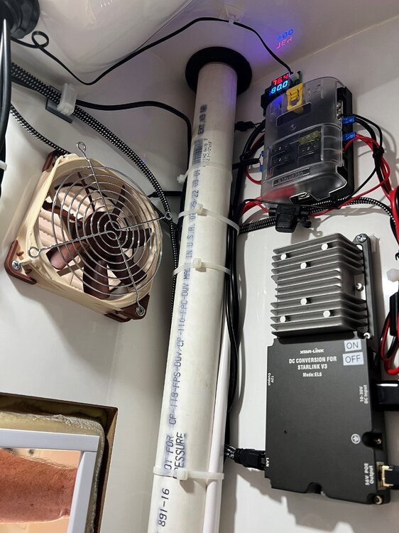

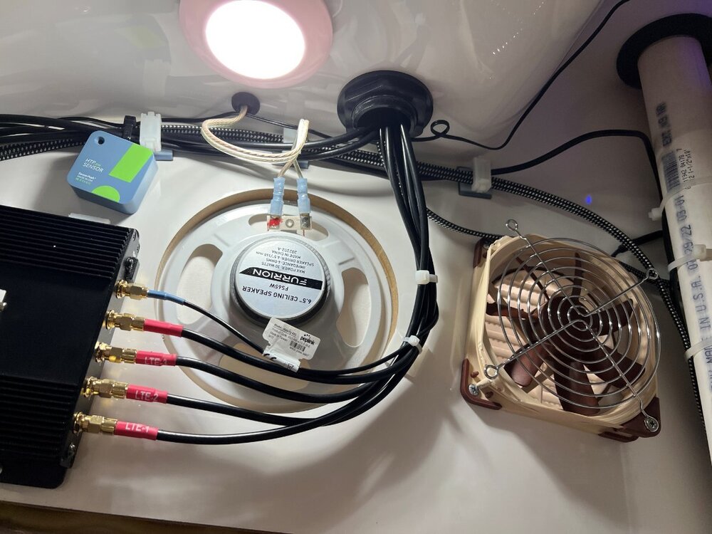

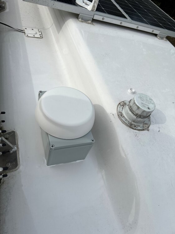

Well my install is done, following the advise of @jd1923 and install by @MAX Burner, I installed the Peplink router, Starlink 12V conversion and just for sh*ts and giggles a 12V fan in the closet.
Also, I initially installed the Peplink 42 antenna to the awning with the included L bracket, but that only lasted about 130miles, the one hole in the plastic L bracket broke out and the bracket was only held on by the other screw! Anyway, that was before I decided to add an entry point for the Starlink to the roof for a later flatmount project. I currently have a pole mount and the idea was to add a
Blue Seas Cable Clam hull penetration adjacent to the 7-pin cable like @MAX Burner did with his dc/dc install.  After the Peplink L brack issue, I decided to go with a box on top of the roof with the Peplink antenna sitting on top, and an RJ45 waterproof connector on the side of the box for the Starlink cable quick connect, either for the roof mount, pole mount, or using the 25' cable on the ground.
Here's the box on the roof, I used a Lifegard Aquatics R270577 1" slip bulkhead fitting to feed the 7 antenna cables and RJ45 cable through to inside the closet. Not pretty, and probably should've gone with a slighly lower profile box!
..and the RJ45 waterproof connector on the side of the box for the Starlink cable quick connect, either for the roof mount, pole mount, or using the 25' cable on the ground..
Peplink Router, Fan, 12v thermostat, Blue Sea Systems 5025 ST Blade Fuse Block and EL6 DC/12V conversion kit for Starlink Gen 3
This install (inside the closet) took way longer than I was hoping for, it's a very tight space, and unless you have the shape/flexibility of a spaghetti, you will end up with scrapes and bruises in places you didn't know existed! If I had to do it all over again, I would attach/mount all the wires to the thermostat before mounting it to the wall like I did, and to make things worse, the Blue Sea Systems 5025 ST Blade Fuse Block was mounted before the thermostat, so I had to basically go in blind to mount the wires to the bottom of the thermostat (not shown in my pictures, bottom of the thremostat is obscured by the top of the Blue Sea Systems 5025 ST Blade Fuse Block), but this is what the thermostat looks like at the bottom, I had to get 18AWG wires into that blue connectors, it was literally a pain in the arse!

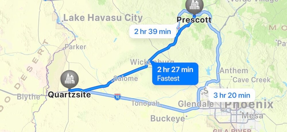

Thank you, will definitely keep it in mind, what's the best route from Quartzsite to Prescott?
**Sold😞**
I suggest the direct route in dark blue except when getting near Prescott take the west loop. A couple of hairpin turns before Yarnell but NP with our short trailers. US Hwy 60, then US Hwy 89 are the main roads. The Q is at 900 FT, Wickenburg at 2000 and Prescott at 5400 FT. The final stretch is a climb up the Prescott NF. Love to see you!
Excellent Boondocking at Wickenburg along the way and another great AZ town to visit with history, good shops and restaurants. Vulture Mountain, Vulture Mine Rd west of town is the camping spot. The mountain really looks the shape of a vulture, neck down feeding.
