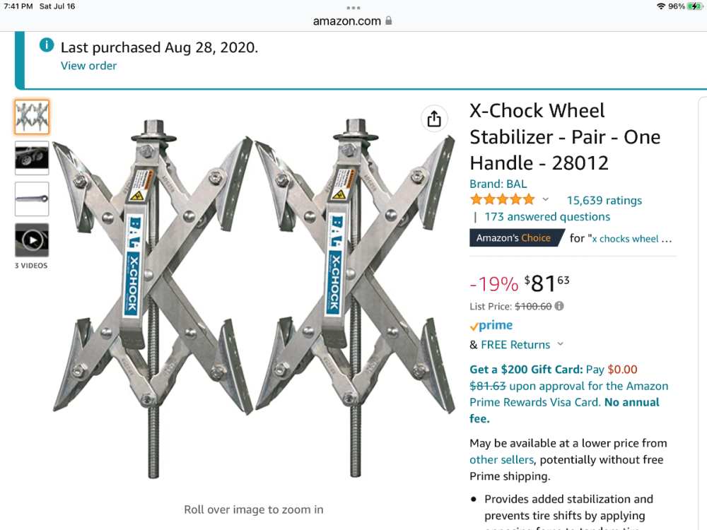

Patriot Posted July 16, 2022 Posted July 16, 2022 5 minutes ago, Puderer said: We are the new owners of hull #90. Upgrading from a Casita. I have noticed when the tongue jack and stabilizers are down there is still rocking in the body. I am parked on a concrete surface. Is this normal? Yes, we use these and they help reduce rocking. 2020 OLEII - Hull #634 aka- “XPLOR” 2021 F350 6.7 liter Diesel Lariat Ultimate Tremor aka - “Beast of Burden” Truma Aventa 13.5 AC, Alcan 5 leaf pack, Alcan HD shackles & HD wet bolts, 5200lb never lube axles.XPEL 10 mil PPF front both front corners, 30 lb LP tanks, Sea Biscuit Front Cargo Storage box. ⚡️⚡️11/2025- Lithium upgrade to XPLOR - (2) Epoch 300ah Lithium batteries, Victron 3000W MultiPlus-II, Victron GX Touch 70, Victron Cerbo GX, Victron Smart Solar MPPT, Victron Smart Shunt, Victron Orion XS 1400 DC-DC charger, RV Soft Start. Zamp 90W suit case solar panel for 420W of solar.⚡️⚡️ North Carolina

dewdev Posted July 17, 2022 Posted July 17, 2022 First Priority/Suggestion: Check the hardware as John Davis suggested Second Suggestion: Use three Anderson buckets like what Frank C suggested or something equivalant so the stabilizing jacks are not traveling so far to support the trailer. I use the Anderson buckets and have had no real rocking problems. Third Suggestion (if you want added insurance against rocking): Use the X-Chocks as suggested by Patriot. I use them when I am staying in one location for more than 1 day and the Oliver is then rock solid. Happy camping and welcome to the Oliver family. 2 2018 Oliver Elite II, Twin Bed, Hull #354 2024 RAM 1500, 4 x 4; Gas. 5.7L V8 Hemi MDS VVT Torque; 3.21 rear axle ratio w/TIMBREN spring rear suspension addition Maine

Moderators Mike and Carol Posted July 17, 2022 Moderators Posted July 17, 2022 12 hours ago, Puderer said: Patriot, by "yes" do you mean it is normal to have some rocking? Yes. It is normal. We’ve been rocking for over 6 years, Unless you use separate jacks or x-chocks to help the onboard stabilizers you will have some movement. Mike 1 1 Texas Hill Country | 2016 Elite II #135 | 2020 Ram 2500 6.7L Cummins
Patriot Posted July 17, 2022 Posted July 17, 2022 13 hours ago, Puderer said: Patriot, by "yes" do you mean it is normal to have some rocking? Yes, it is normal to have some rocking. We also use the Andersen buckets under the rear stabilizers. The xchocks work very well for us. 1 2020 OLEII - Hull #634 aka- “XPLOR” 2021 F350 6.7 liter Diesel Lariat Ultimate Tremor aka - “Beast of Burden” Truma Aventa 13.5 AC, Alcan 5 leaf pack, Alcan HD shackles & HD wet bolts, 5200lb never lube axles.XPEL 10 mil PPF front both front corners, 30 lb LP tanks, Sea Biscuit Front Cargo Storage box. ⚡️⚡️11/2025- Lithium upgrade to XPLOR - (2) Epoch 300ah Lithium batteries, Victron 3000W MultiPlus-II, Victron GX Touch 70, Victron Cerbo GX, Victron Smart Solar MPPT, Victron Smart Shunt, Victron Orion XS 1400 DC-DC charger, RV Soft Start. Zamp 90W suit case solar panel for 420W of solar.⚡️⚡️ North Carolina
