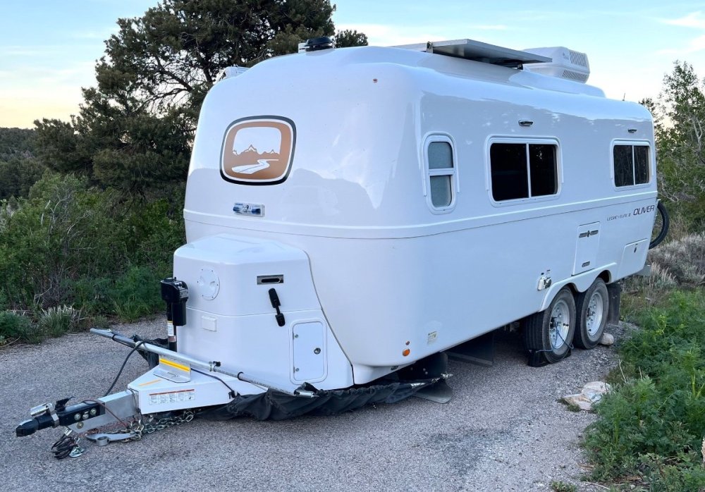

If the campsite has a major slope to it, always chock the downhill sides of the all the tires and consider pulling the emergency breakaway switch. That will completely lock up the trailer brakes until you get everything figured out, leveled and safely chocked. Do not leave them this way for more than say ten minutes, it eats up battery power and maybe the brake magnets could overheat.
And as csevel said, leave the safety chains/ cables attached until you know you are finished. Three tons of trailer can be hard to control… I hate sites like that, but some day that may be the only available one. They can be dangerous. If you don’t feel capable of unhitching safely in one, go to another campground. This was at my very limit for tolerance, sloping steeply back AND away from the street side. Great Basin NP, Lower Shafer CG (a very gorgeous park, one of my favorites, but with really crappy campgrounds!) The far side tires are way off the pavement on blocks. We paid for two nights, but bailed out early the next day and found a better site in a different CG, after scouting without the trailer attached.
