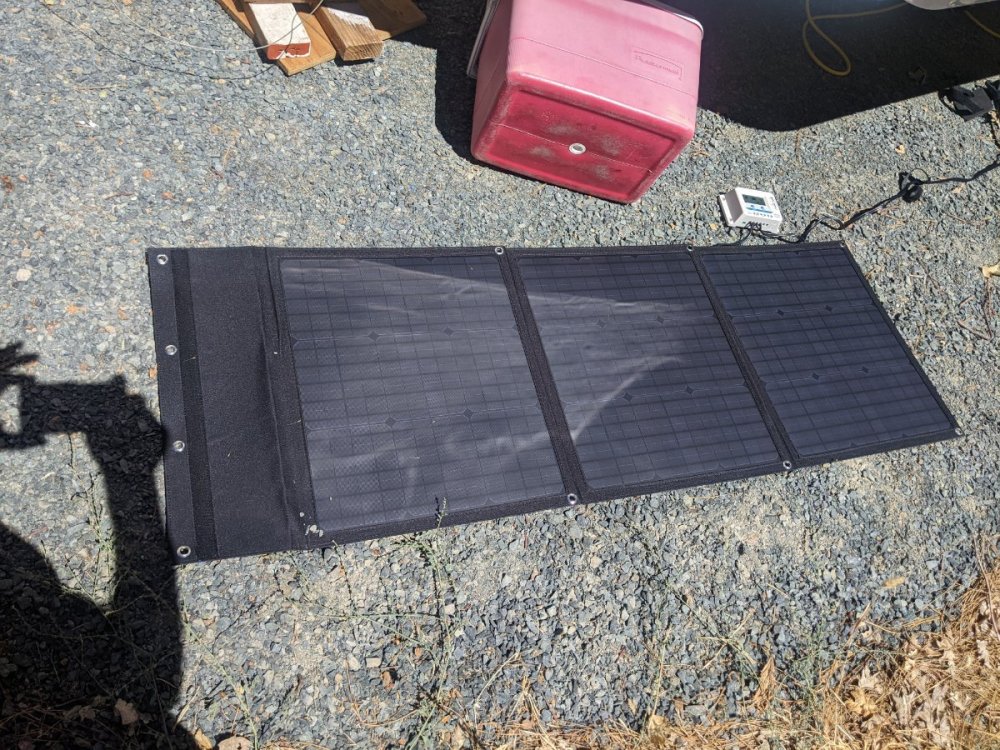

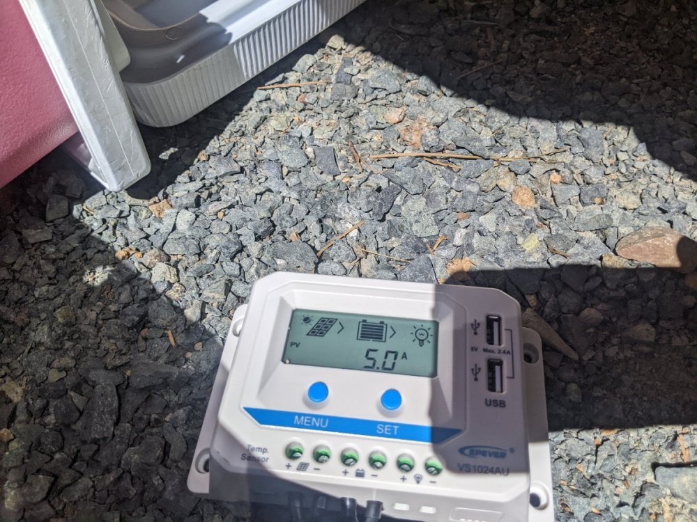

Cameron Posted August 26, 2022 Share Posted August 26, 2022 I got a portable solar panel (aka blanket/suitcase) to hook up to the external Zamp port. The price was good, so I thought I'd try it. https://www.amazon.com/Xantrex-783-0100-01-Portable-Charging-Kit-100W/dp/B07QYCHG6V/ref=sr_1_3?crid=2Y0HK1F42H1U1&keywords=xantrex+solar+flex+portable+kit&qid=1661499580&sprefix=xantrex+solar+flex+portable+kit%2Caps%2C168&sr=8-3 Hooked it up today, seemed to work fine. The top connection in the port is the positive, so I made sure to connect the SAE connector correctly. This panel comes wired correctly, so I didn't need an adapter to reverse polarity. I turned off the rooftop panels then checked the Lithionics app, which didn't show the batteries getting any juice from the portable panel. Don't know why. The controller showed 5.0A, not very much. It's really light and easy to hook up but I'm not sure if it will give me enough juice to make it worthwhile. In truth, I haven't had a problem with AC/DC while boondocking. I might run it down to 60% at night, but the next day it'll charge back up to 85% or 80%. 7 2021 Elite II #841, 2020 GMC Sierra 1500 AT4, 3.0 diesel Link to comment Share on other sites More sharing options...
John E Davies Posted August 26, 2022 Share Posted August 26, 2022 Thanks for posting! That looks like a great panel, I would have bought it over my big heavy Renogy one if it had been available, most flexible panels have been very costly in the past. Prop it up at an angle directly facing the sun and you will get a little more power. I believe these panels are more delicate so use care when cleaning and handling them. You can easily mod the wires so you can put the panel further away and still get full amperage at the batteries. This is my 100 watt panel 40 feet away tilted in full sun: https://olivertraveltrailers.com/forums/topic/5478-how-to-remote-mount-the-controller-of-a-suitcase-solar-panel-not-inside-the-trailer/ Changing the controller to a high quality more efficient MPPT one will help also, but it isn’t really cost effective if you can just physically shift the panel around to follow the sun. (Tho the price of no-name ones is getting down to around $20😳) Please post some follow up reports. John Davies Spokane WA 4 SOLD 07/23 "Mouse": 2017 Legacy Elite II Two Beds, Hull Number 218, See my HOW TO threads: Tow Vehicle: 2013 Land Cruiser 200, 32” LT tires, airbags, Safari snorkel, Maggiolina Grand Tour 360 Carbon RTT. Link to comment Share on other sites More sharing options...
thirddoor Posted August 26, 2022 Share Posted August 26, 2022 Does the charge controller have a lithium setting (Amazon listing doesn't have much info on the controller)? Check the voltage to make sure it's high enough for your battery. 2 2019 Legacy Elite II #488 - Delivery July 24, 2019 2018 F150 Platinum SC SB EB - Leer canopy Link to comment Share on other sites More sharing options...

Cameron Posted September 8, 2022 Author Share Posted September 8, 2022 Here's an update. It's mid-day, no clouds. (Hot!) With the panel connected, directly facing the sun, my Lithionics app shows power generation at 53.1W, and 4A. When I disconnect the portable solar panel, it shows 26.3W and 2A. So, my highly scientific assessment shows that it works. I'm surprised that it seems to double the charge going into the batteries when the rooftop solar is 400w and the little portable panel is just 100w. The provided charge controller is very basic and does not have settings for different types of batteries. So maybe a 300w portable panel would be better? Or maybe a different charge controller would be better? For the moment, it was an inexpensive panel that was already set up for plug and play. 2021 Elite II #841, 2020 GMC Sierra 1500 AT4, 3.0 diesel Link to comment Share on other sites More sharing options...
