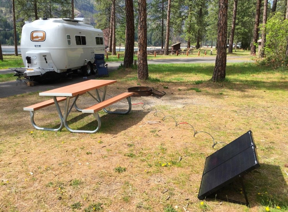

Keep in mind your day length in October, it is really hard to recharge with only a little DIRECT exposure when you only have maybe nine hours of adequate sun. The first hours at dawn and dusk don’t contribute any power. It is much easier in summer when the sun is more directly overhead for many more hours. The panels don’t work much if partially shaded…. Consider using a portable panel so you can “chase” any bright spots near your site. You can modify a standard unit so it will work fine fifty feet or more away from your shaded Ollie. This is especially true for your LE1 since you have less built-in capacity both in the batteries and in the roof panels... Here is my 100 watt Renogy panel. This size unit, tilted and directly facing the sun, potentially increases your 240 watts of roof solar power by 40%.

But a 1000 watt gennie (using the onboard converter) charges much much faster than an extra panel ever could….

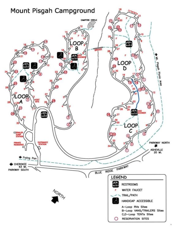

There are not many good “solar” sites in A (RV) loop at  Mt Pisgah. Some sites  can be reserved and some cannot. We normally camp in the summer when we’re looking for shade, but sites A10 and A15 look like better solar sites. The map previously posted should indicate if the site can be reserved.
