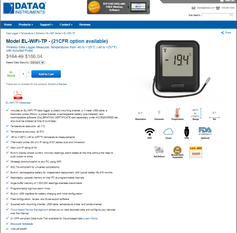

Ollie-Haus Posted November 25, 2022 Posted November 25, 2022 In the process of educating myself on the topic of maintaining our future lithium battery system, it became quickly obvious that temperature control is a key to longevity of lithium batteries. We have another system in our world that requires constant temperature monitoring in the winter to not shorten its life and that's a hot tub. If the circuit trips or a cord is unplugged by chance the tub and its pump would become an ice block in a couple days in sub freezing temps. In my place of work we monitor temps in many applications 24/7/365. Once I recognized the need for our hot tub I simply went on line to an instrument company and found a recording temperature data logger that was reasonably priced that would fulfill my needs. Well my and our needs to monitor the temps of our Oliver lithium battery system during winter storage is another perfect application of a recording temp monitor. The one in the link I'm providing is relatively inexpensive in the world of recording data logging devices and really easy to install and use. The beauty of this one is it can either be battery powered (rechargeable) or plugged into 110v with an adaptor (think shore power) and the device connects via wifi to the web for continuous cloud storage of regular temperature readings. That data is always accessible via the cloud storage site and can email temp deviations below or above chosen set points. Definitely not a requirement for a lithium battery system but very helpful, especially in a warranty situation because you own a verifiable temperature record of your stored battery system. See what you think if it sounds useful to you. Edit: Of course you could also use the same device to monitor temps in the bilge area for preventing frozen water systems. https://www.dataq.com/products/lascar/el-wifi/el-wifi-tp-data-logger.html 2 What's today?............. the most frequently asked question as a retiree 🙄 Chris and Stacie Neuhaus and Cohen the fearless Border Terrier, Greenfield, Indiana 2021 Ford F350 7.3L Tremor (Redzilla) LE2 #1373 - Ordered 10/21/22 - Delivered 05/10/23
