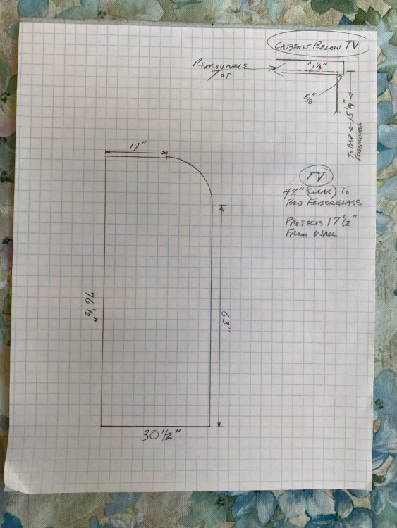

Steve Morris Posted December 13, 2022 Posted December 13, 2022 We just returned from The Original Mattress Factory store nearby, and have decided to have them make a pair of custom mattresses for us. We were going to order from KTT, but hesitant, as we've never slept on anything other than a coil spring mattress (except the thin foam one in our Hiker squaredrop trailer.) TOMF has foam RV mattresses that they offer. Instead, we are having the same exact mattress made that we currently sleep on at home. It is a modified version of their twin orthopedic extra firm mattress, with support cylinders along the edge for couch duty. They are 10" thick, so a bit more than the 8" KTT and 7" Southern mattresses. The only problem, is that they cannot create a curve on one corner to match the Oliver mattress. They can, however, create a 45° "chamfer" on one corner. All they need are dimensions for that angled portion. Now, I can simply do some math and calculate the straight line that connects the two ends of the mattresses 15" radius from the Oliver supplied dimensions. But I *think* I can cheat that a bit, and have a slightly smaller chamfer to fill in that gap. And here's where I'm asking for help. Could someone with a twin bed layout mock up a chamfered corner from cardboard for me? The Oliver drawing shows the mattress as 29" wide, 74.5" long, with a 15" radius on one corner. What I'm envisioning, is somewhere between line A and line B on the attached sketch. Option A leaves a big gap in the corner, and I think option B would interfere with the wall too much. I'm after wherever best fits between, shown indeterminately as line C. I'm thinking it can be closer to line B than shown, but can only determine that with a physical mock up. Also, are the mattresses really only 29" wide? The dimension I've seen most frequently are 30" X 75". I'd like to fill the fiberglass tray with as wide and long of a mattress that will fit, since I'm having a pair custom made. If the mattress is really 29" wide, then the dimension of the top question mark in the drawing is 14", and the lower is about 20 1/4" I'm guessing best fit will be somewhere closer to 18-19" For reference, the KTT mattresses are currently at $750 each, plus shipping. Shipping to me in October was $304 for two, but someone recently had a shipping quote to the midwest closer to $500. so, around $1900 for the pair. The Original Mattress Factory cost, including customization, will be $1018 for the pair. If anyone would be willing to mock this up and see how it fits, I'd be eternally grateful. And bring you your choice of beverage to the rally (within reason. No Pappy Van Winkle request.) 😀 1 ----- Steve - Northern Ohio, USA Wandering around on occasion, always lost. 2021 Toyota Land Cruiser - 2023 Oliver Elite II Twin Hull #1360 “Curiosity” Facebook - Instagram Camped in Curiosity = Green —— Visited with Curiosity = Gray
Steve Morris Posted December 13, 2022 Author Posted December 13, 2022 Maybe this helps clarify what I'm asking for. My overly complicated explanation above may have caused confusion (45 years in engineering makes it impossible for me to not be overcomplicated. 😉) Grab a large piece of cardboard, and make marks 9, 10, 11, and 12 inches back from a corner. Connect these marks with parallel lines. Cut off the corner formed by the 9" markings and fit it into the corner of the Oliver's twin bed area. The points where you cut probably interfere with the sides of the the cardboard laying along the sides of the Oliver. Cut back to the next pair of marks and try again. How's that fit? Probably by the time you get to the 12" pair of marks, it will fit fine, but leave a large gap in the corner. Somewhere between the 9" cut and the 12" cut was likely the best fit. That's what I'm after. I'd also like the dimensions of the twin bed tray, from the wall to the inside of the lip, and from the end (back wall of the trailer) to the face of the cabinet. Conventional wisdom has these as 30" and 75". Oliver's drawing shows 29" and 74.5" Thanks for any assistance offered. ----- Steve - Northern Ohio, USA Wandering around on occasion, always lost. 2021 Toyota Land Cruiser - 2023 Oliver Elite II Twin Hull #1360 “Curiosity” Facebook - Instagram Camped in Curiosity = Green —— Visited with Curiosity = Gray

ChrisMI Posted December 14, 2022 Posted December 14, 2022 This might help… did a quick sketch last year to order a mattress. 1 2

Steve Morris Posted December 14, 2022 Author Posted December 14, 2022 3 hours ago, ChrisMI said: This might help… did a quick sketch last year to order a mattress. Thank you! So, a bit larger than the stated 29x74.5 then. 👍 ----- Steve - Northern Ohio, USA Wandering around on occasion, always lost. 2021 Toyota Land Cruiser - 2023 Oliver Elite II Twin Hull #1360 “Curiosity” Facebook - Instagram Camped in Curiosity = Green —— Visited with Curiosity = Gray

Steve Morris Posted December 29, 2022 Author Posted December 29, 2022 Well, just when I thought we had things figured out with the radius in the corner, I find that I don't. Took the template into The Original Mattress Factory and talked with the manager about ordering a pair of custom twins. One thing I didn't take into account with all my fancy engineering layout, is that there needs to be a whole number of coils. Well, of course there does, dummy, but my layout doesn't fit that model. I'm not sure I want to lose almost 3" along that angled edge shown above... Time to rethink. Could someone with a twin layout please measure the distance from the floor to the platform where the mattress lays? Before I go too far, I want to see how high a 10" mattress is going to be from the floor. I've seen the Hypervent, but never measured it. Is it about 3/4" thick? Thank you! ----- Steve - Northern Ohio, USA Wandering around on occasion, always lost. 2021 Toyota Land Cruiser - 2023 Oliver Elite II Twin Hull #1360 “Curiosity” Facebook - Instagram Camped in Curiosity = Green —— Visited with Curiosity = Gray
Steve Morris Posted January 3, 2023 Author Posted January 3, 2023 On 12/29/2022 at 4:45 PM, Steve and Deb said: Could someone with a twin layout please measure the distance from the floor to the platform where the mattress lays? Anyone have their trailer available to check for me? Thanks! ----- Steve - Northern Ohio, USA Wandering around on occasion, always lost. 2021 Toyota Land Cruiser - 2023 Oliver Elite II Twin Hull #1360 “Curiosity” Facebook - Instagram Camped in Curiosity = Green —— Visited with Curiosity = Gray
Moderators Mike and Carol Posted January 4, 2023 Moderators Posted January 4, 2023 2 hours ago, Steve and Deb said: Anyone have their trailer available to check for me? Thanks! 15” from the floor to the bottom of the mattress support. 1 Texas Hill Country | 2016 Elite II #135 | 2020 Ram 2500 6.7L
