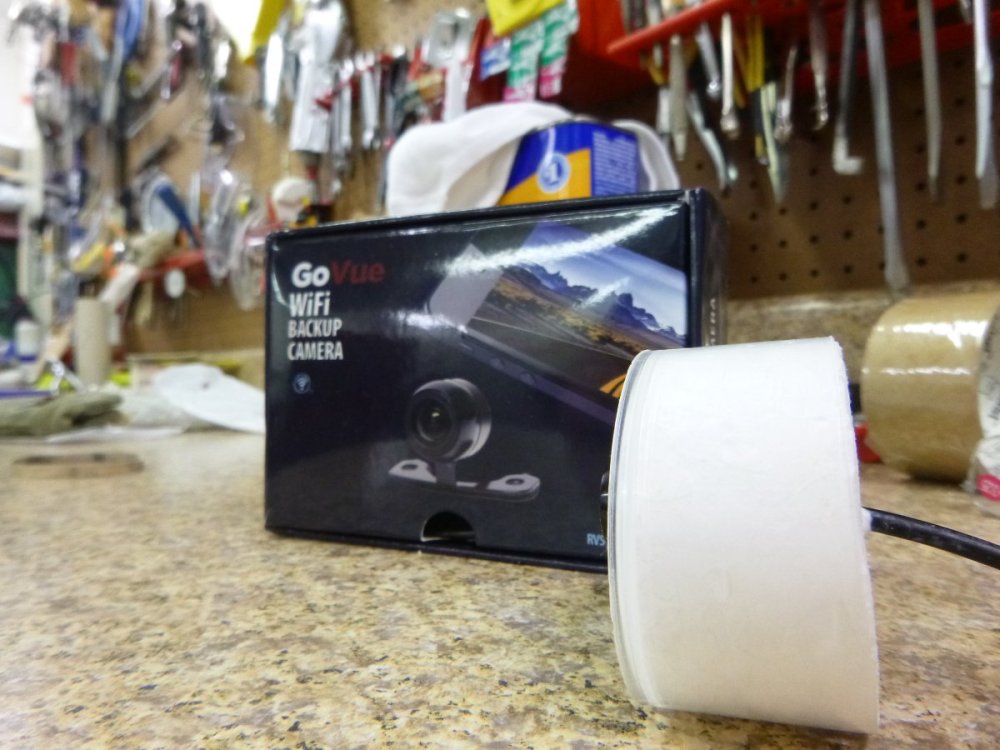

Yes - my first rear camera was/is located in the spare tire cover.  There are a couple of issues - mounting and rainy weather.
Mounting - the spare tire cover is not perpendicular to the ground.  Actually it is off by 6 degrees.  So if you mount the camera without making any adjustments to account for this, the camera will be pointing too far down towards the road.  If you compensate for the entire 6 degrees you will probably find that the camera is now pointing too high.

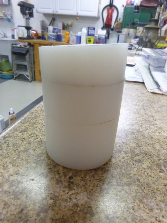

I made a "puck" out of a material called Delran (similar to nylon) that is easy to work with and cut it at a 4 degree angle.  Thus when mounted on the tire cover you obtain a net 2 degree downward view which is about perfect.
The second issue is rain.  With the camera mounted in this relatively low position (versus the "normal" roof mount), the camera gets more road spray in wet weather.  However, when it is not raining the I prefer this lower view for backing into campsites.
A third issue with the lower mounting position is in heavy traffic you can not see as far behind you because the guy on your bumper blocks most if not all of the view.
Given the above - I now have two rear cameras.
