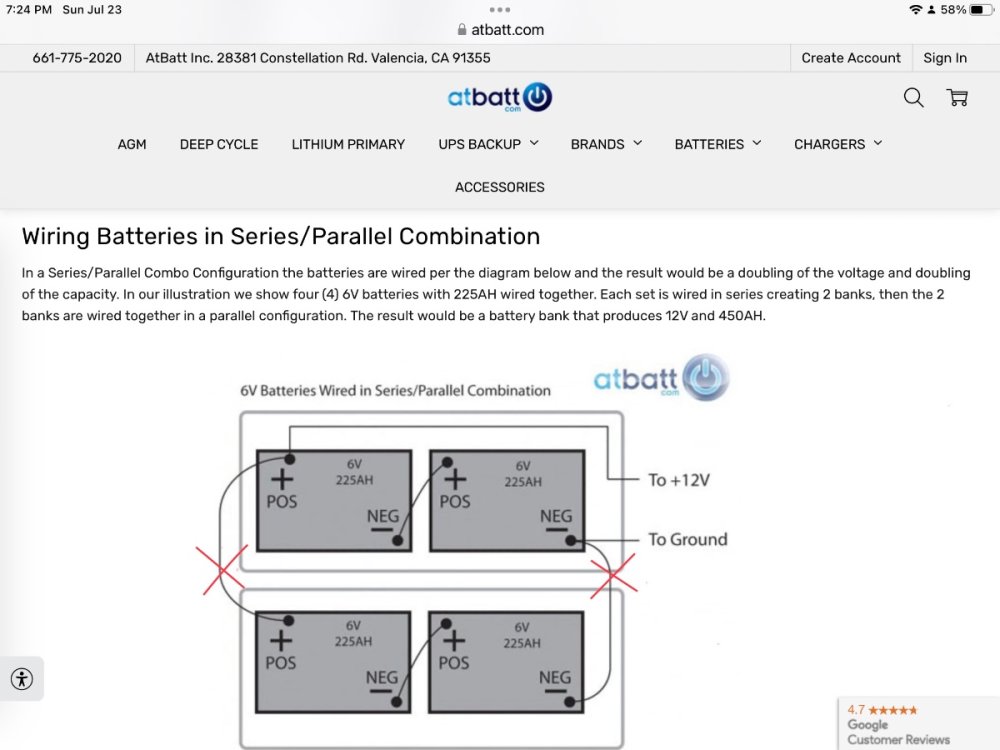

Make your battery cables look like the diagram below by removing the cables with the red X's.
I tried to edit the battery configuration diagram from the OTT manual and the result looks like first grade art work, sorry.

It appears you have 4 6v batteries, therefore you must run 2, 1 battery is not feasible, as two 6v batteries must be wired in series to produce nominal 12v.
You have wiring diagrams above, but simply stated, you must connect the + post of one battery to the - post of the other. Then connect positive feed to the trailer to the remaining + battery post. Lastly connect the ground by connecting the final negative battery post to the trailer ground.
Positive automotive battery cables are usually red, and negative/ground cables are usually black. Installing in the order described here is safe and will not allow a short across your tools, when adding ground to the batteries is the last step.

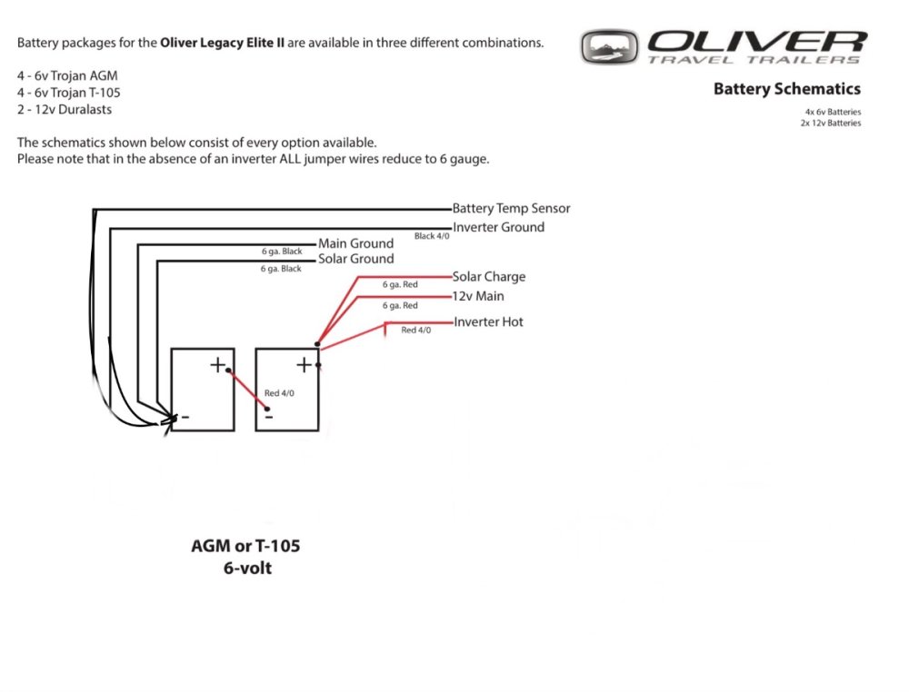

Hi Ralph, you need to provide details of what type of 4 lead acid batteries you have (6 volt or 12 volt) before you start changing jumper wires into a series or parallel arrangement if you only keep 2 batteries. You didn’t specify in your original post, and you mentioned possibly cutting back to using only 1 battery, so that implies a single 12 volt battery.  There are Olivers with FOUR 12 volt lead acid wet cell batteries in parallel (I have this setup. It was offered by Oliver as an option, maybe you have the same setup as this?). See photos below.
Bright Way BWG DC24-6
So look to be six volt, sealed lead acid.
