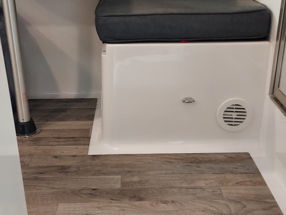

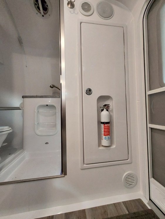

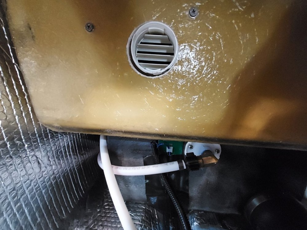

The answer to this question depends, to some extent, on how recently your hull was manufactured.  Our late 2022 Hull #1291 with the Truma Varioheat furnace can withstand colder outside ambient temps than earlier models because Truma required a redesign of the duct system that includes a return air vent between the bathroom and the under side of the front dinette seat.  See photo below:
BathroomReturnAirVentFromUnderneathFrontDinetteSeat.thumb.jpg.e06bbc22b93a3b9829699c735663053e.jpg
This return air vent enables distribution of more  heat to the underbelly of the trailer, providing some additional thermal protection to the plumbing.  Your Hull No. 1423 probably does not have the Truma Varioheat, and, therefore, does not have the updated ducting.
