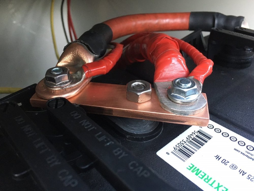

Going to finish and close this post. Grommets epoxied into place, not my idea of the best solution, but it is the OTT design. Got rid of what was referred previously as an elegant solution, perhaps, but battery posts mounted too high is NOT a good idea, not near an adequate solution. As another great Greek once said 🤣, "Give me a lever long enough and a fulcrum on which to place it, and I shall move the world." (Archimedes). You do not want the lever to pull you battery posts out of the casing.
I am not interested in elegant solutions, as KISS, Keep It Simple Silly, is a long-lived and currently viable design philosophy. Most of you will not like my solution, fear may engage your mind.
I found 100 varied electrical bus solutions for this need, ranging from $40 to $200 on Amazon and professional sites. Why? I just bought a piece of copper. Copper is about the best affordable conductor. For $20 taxed and delivered, I received a 1" wide, 1/4" thick, 8" bar of 99.9% pure copper. I guarantee any manufactured bus you would buy would have more resistance than this copper.
Decided to mount the + connections on the left side, so they would not be stressed into the corner like the previous install (as @John E Davies had warned of earlier). Like it or not, here it is. So, we're done here. Thanks for reading and I would certainly appreciate your comments! 🙂

I also placed ribbed rubber toolbox liner under the batteries for cushion, came up with a better solution to fill the 3/8" extra depth in the box.
Looking again at my pics, on next maintenance, I may drill a recess in the copper bars where they mount to the battery posts, so that I can mount the nuts deeper so that all threads are holding strong. First, we may just take an outing to see how this install holds up. Thanks again
I like the idea of spot facing the copper bars where needed. I also like the flanged nuts. If you could spot face a large enough area to allow for the flanged nuts on the battery studs that wouldn't be a bad idea. Like your idea and I too would run a test period to find out where you stand now. Knowing your connections are improved, any other issues could be traced to their true source.

We used a similar approach for the upgraded copper bus battery terminal:
