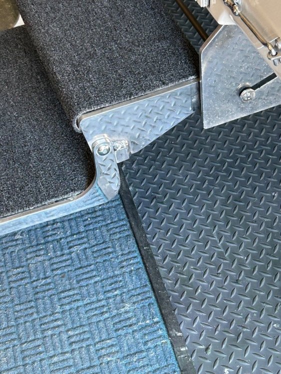

Installed new carpet treads a couple days ago and planned to clean and lubricate the step mechanism with CV-2 grease.  FYI:  Just a small amount of CV-2 applied to the rail slots make deploying/retracting the steps quieter and much easier with a lot less effort.

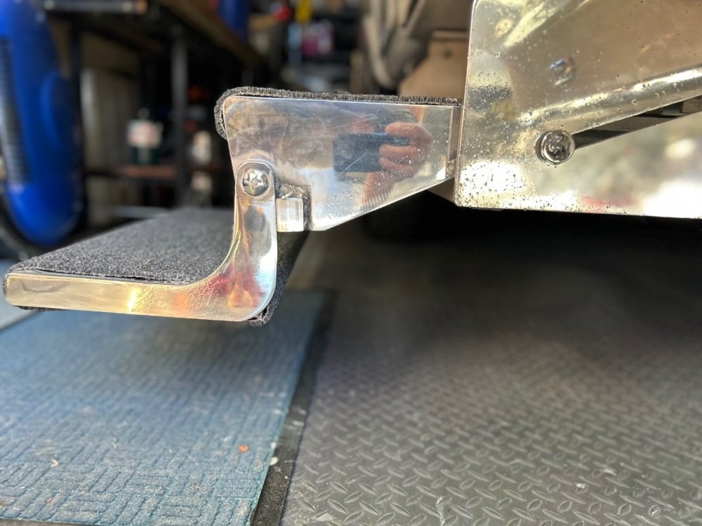

Noticing that the leading edge/forward aluminum step frame had been quite hammered by road debris after 6+ years of usage, we decided to address this situation with an angle grinder fit with a polishing wheel and green rouge.
Here's what happened after about 30 minutes of effort:
We're liking the results and should allow being able to keep this area cleaner over time...
Cheers!

It appears the steps are currently being made from tread plate rather than flat plate aluminum.
Our old (2010?) steps are flat plate, plus nonskid strips.
2 hours ago, Steph and Dud B said:
Our 2022 is flat plate. Must have been an interim thing.
FYI:  The plates are in fact flat aluminum, they look like diamond plate because they're reflecting the diamond plate floor mat that the trailer is positioned on.  The second photo shows the plate finish without the reflection.
Cheers!
Art, it appears you still have a bit of aluminitus left over from the Airstream days.   I like it.
My bad, I see it now, Thanks!
