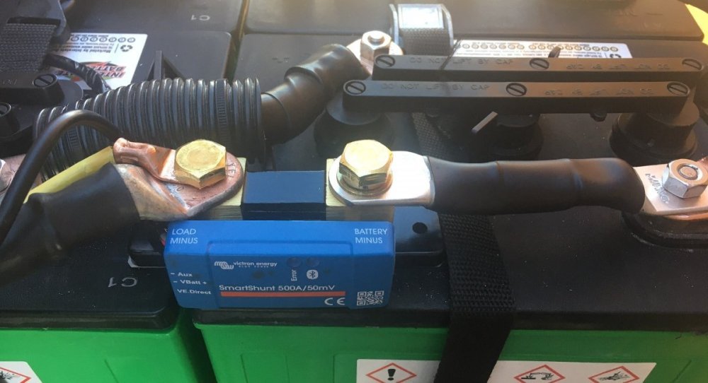

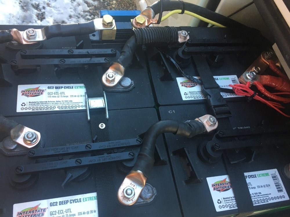

The heat shrink tubing was delivered yesterday, so I got the shunt and shorty cable installed today. When I upgrade to Lithium, I'll likely come up with a better location for the shunt, but for now is sits on the battery. I added a heavy plastic wire loom on the other battery cable to fully isolate the shunt terminal.

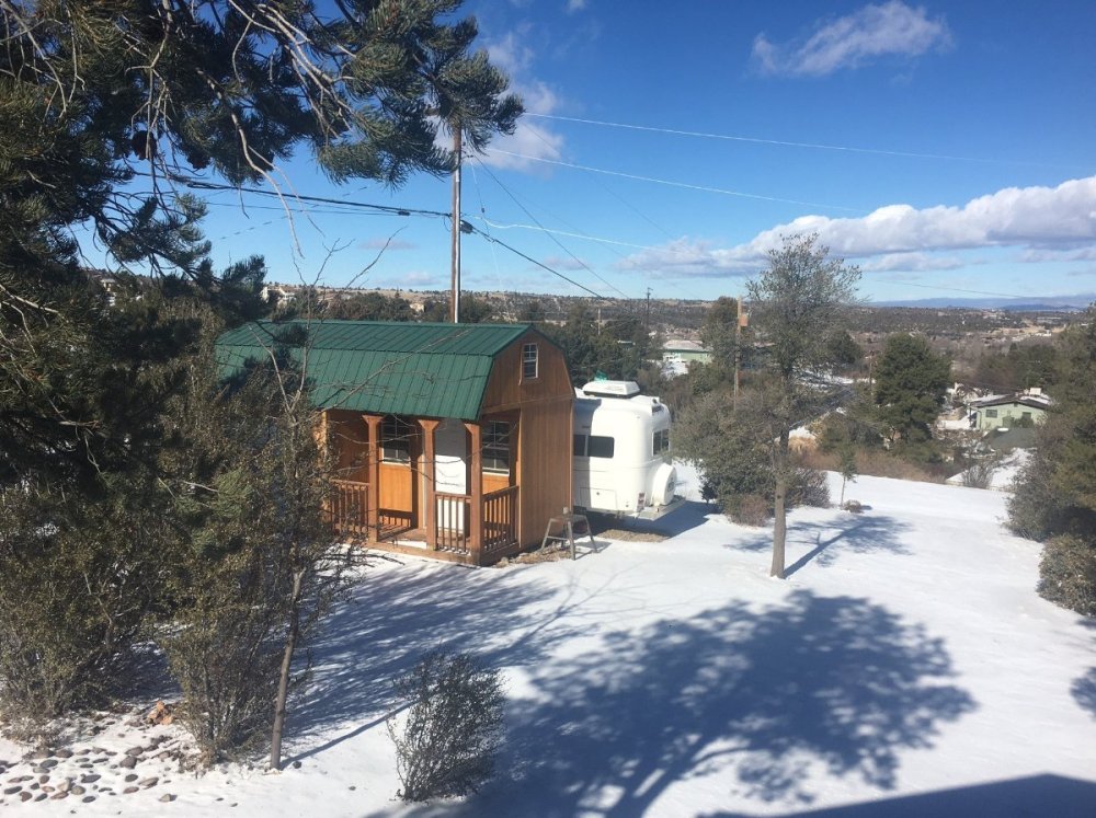

Interesting!
But, what is that white stuff on the ground?😇

Yeah Bill, we got 3" of snow on Sunday and usually melts quickly, but it's been cold (everywhere right)! We're at 5,400 FT up here, and it looks like another 3" by the morning.
Love reading simple battery status w/o craning my neck to see the Blue Sky panel mounted at knee height. The Bluetooth range sucks (more comments on this above). @Ronbrink and @MAX Burner concur that max range is 10 to 20 FT max. I'm good for now, but might add the Victron smart dongle, that according to members on other RV forums, broadcasts a stronger signal. The dongle is $40, a (required?) Victron connector cable and tax should come under $65.

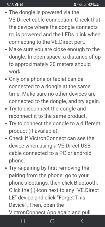

don't have the time to worry about it now, but perhaps another $60 would allow the app to read the signal from your driver's seat. I'm not betting on a 60' broadcast to my living room, but perhaps it could if I mounted the dongle rear left of the Oliver where I have line-of-sight. Closer to my living room, would be farther from the TV driver's seat!
Maybe. I pulled up the victron smart dongle manual, and it says 20 meters of clear space "should" give a signal, in the troubleshootingsection. (That might depend on your windows, wall thickness,  and insulation, etc, in your house. Mine block a lot of signals.
Perhaps worth a try?
$40 on Amazon, and free return if it doesn't work...
5 hours ago, SeaDawg said:
Maybe. I pulled up the Victron smart dongle manual, and it says 20 meters of clear space "should" give a signal... Perhaps worth a try?
That's 65 feet, so it should certainly get into the TV cab and yes "maybe" to my living room. We did get another 3" of snow this morning. Doesn't the Oliver look good out there, or what? We all love Oliver pics, right? (Picture taken from our living room window.)
You know of course after finding a used Tuff Shed, I ran 125' of 8AWG burial cable (proper gauge for 30A at 120V for this distance), installed a sub-panel for lights and outlets, then ran 10AWG to the far side of the shed for a 30A shore power outlet! Don't have her covered, hard to do on our property and with codes, but at least the tires are mostly out of the sun.
Anybody reading... do you want to visit Prescott, AZ for a couple of days? Open invite here, just PM me. I'll move our Oliver to another spot, and you can plug in here. I'll run 100' water hose for you too. We love this place, an oasis in the high desert! 🤣
That's an idyllic spot! So nice of you to offer to share.

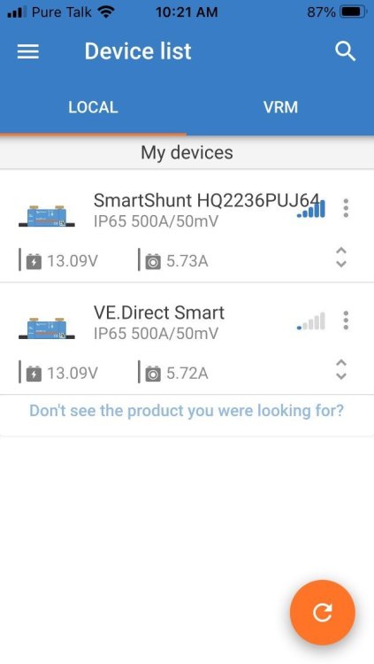

OK @jd1923; after performing a signal strength experiment with the Victron SmartShunt and the Solar Controller, here's what was learned:
Placing the tape measure at 15' from the outer hull adjacent to where the components are mounted within, connection was successful:
Screenshot of the SmartShunt after connecting at 15 feet:
Screenshot of the SmartSolar MPPT Controller at 15':
The 15-foot radius from the hull seemed to be the maximum distance to acquire either device.  Stepping back to 18 - 20 feet was too far away for the Victron app to connect to the devices.  However, as JD noted, in the My Devices screen the readouts for each device seemed to still transmit/receive out to 20 feet.
Here's a 20' screenshot of the My Devices page:
This got me curious.  So, Part 2 of the experiment:  Went back out and with the My Devices page selected at about 40 feet - no BT signal received - zero bars on each device, then started walking ever so slowly toward the rig.  At about 30 - 35 feet, the signal strength bars started popping up to about 2-3 bars.  At this distance the data was now displayed below the SmartShunt and Solar Controller sections of the My Devices page.  So, one could get readings from this distance but will not able to connect to the device individually.
Pic from the distance of 2-3 bars (approximately 30-35 feet):Screenshot2024-01-15at12_42_26.thumb.png.1cf75f80dc6a31623970d98c433523cd.png:
Here's a screenshot of the My Devices page at this distance where the BT signal begins transmitting bulk data:
Unfortunately, the cab of the TV attenuates the BT signal such that this data cannot be observed when towing.  It would be nice to know if the Victron dongle would increase BT signal strength enough to monitor the system from the cab when towing.  That would certainly be worth the $40 + tax to have that capability, IMO.

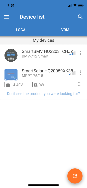

However, on the app "My Devices" home page, it now shows battery voltage and amperage flow on both devices. I'm not absolutely positive, but I do not remember seeing these readings prior to installing the Dongle.
Mine shows those values for the SmartShunt in the Oliver (no monitor) and the MPPT solar charger for a 100Ah LFP portable power station in my TV. However, the PS also has a 712 monitor which is displayed as the ‘device’, rather than its’ associated SmartShunt, and does not display those values on the home screen. No Dongle. Screenshot of the PS monitor and charge controller only, the Oliver is in storage.
