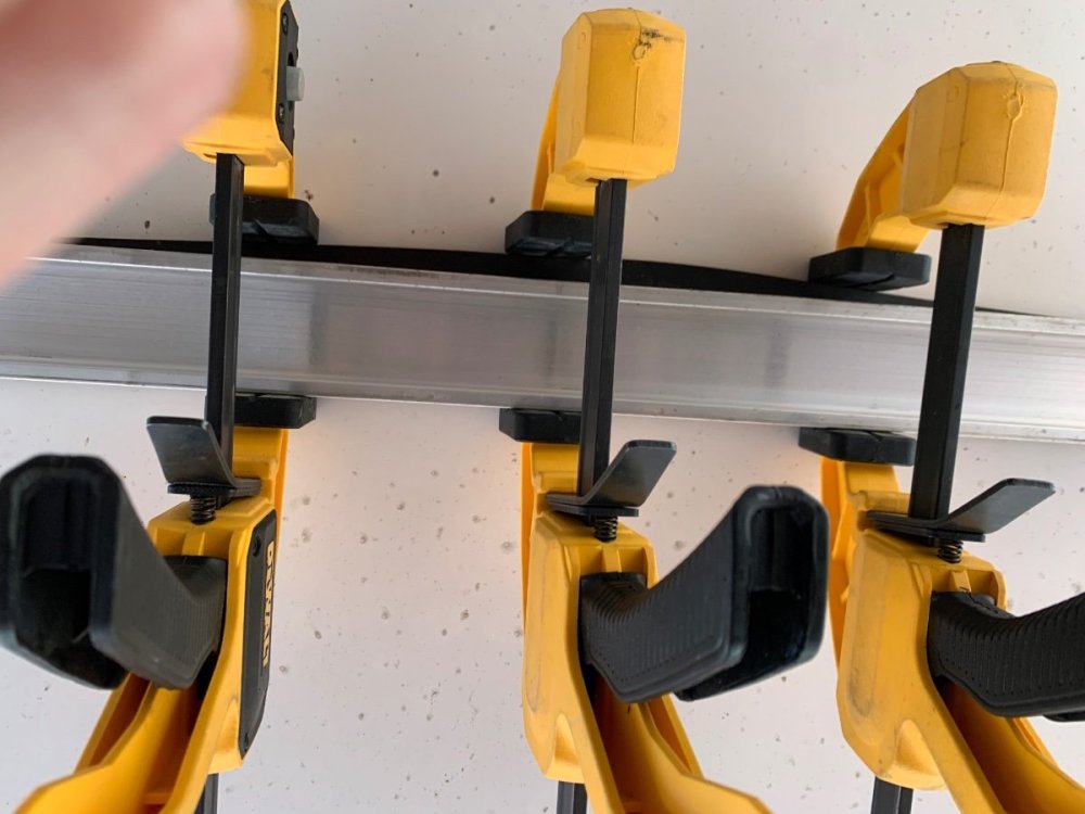

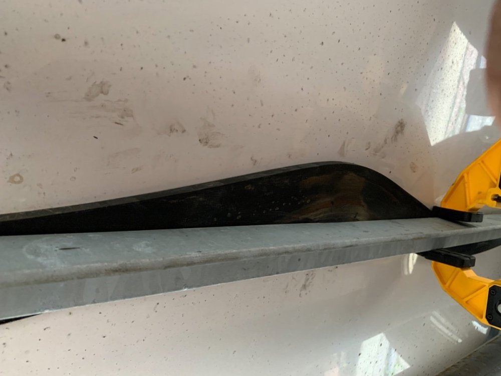

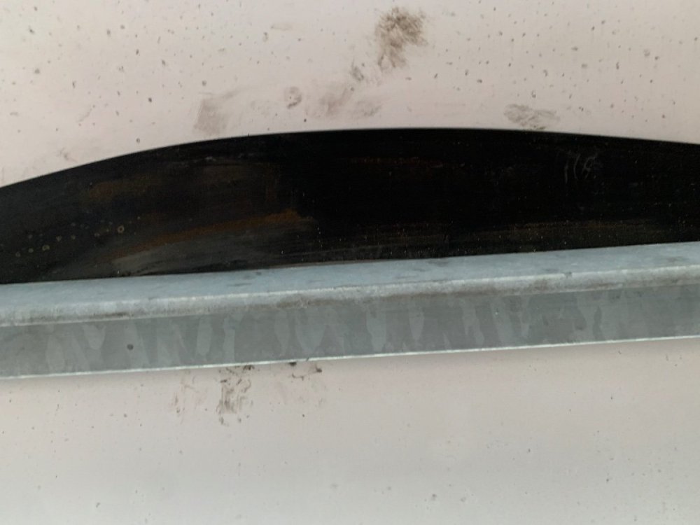

Last Spring while upgrading to Timken wheel bearings, I noticed some of the rubber neoprene runners Oliver places between the aluminum frame and fiberglass hull were out of place. After remounting all of the wheels, I crawled under the trailer to further examine in order to devise a fix. I eventually made use of some trigger clamps to help force the runners back, with varying degrees of success. I had similar issues previously with these ‘cushions’ at the tongue frame and was able to use cable ties to hold them in place. However, due to the tightness at the underbelly supports, the best I could do was attempt to reposition them with thoughts of continued monitoring of future migrations overtime. I did find these runners secured on each end with a screw, which lessened any concern of them falling completely out (think added rubber road debris for motorist to dodge!).
This is what I found. Note the smudges made first trying to use a rubber mallet to force back in place.
IMG_3890.thumb.jpeg.d8bff1dd6b66403ff1704461a60e7fe2.jpegIMG_3896.thumb.jpeg.f36a9c970bf7b055254dfacb8c29c46d.jpegIMG_3885.thumb.jpeg.8b6a87e214eb9e843cdbcf86f04efab6.jpeg

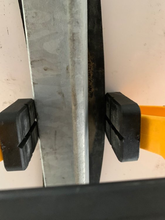

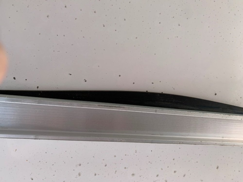

I began by attaching a clamp at the outermost points of concern.

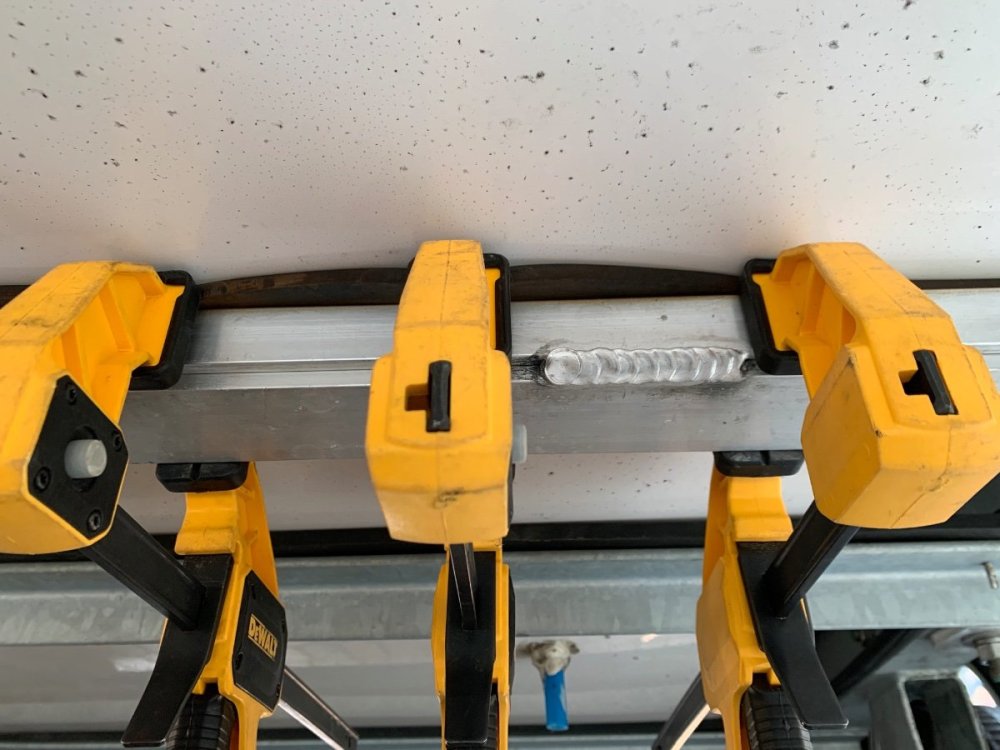

Then used additional clamps to work the runners moving inwards. Easy, right? Not so much, very little clearance tolerance!
IMG_3893.thumb.jpeg.59992b565601c8cf75a8f62aa4747a4f.jpegIMG_3897.thumb.jpeg.47c66776b06d0ebd067212dcfcbc4da4.jpegIMG_3889.thumb.jpeg.64508e4cfdd71e1211ebf1d00d8cde27.jpeg

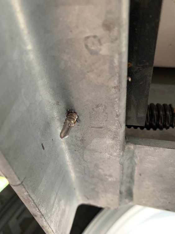

Retainer screw at each end. It would have been nice if Oliver would have used adhesive, as well, to keep these runners in place!

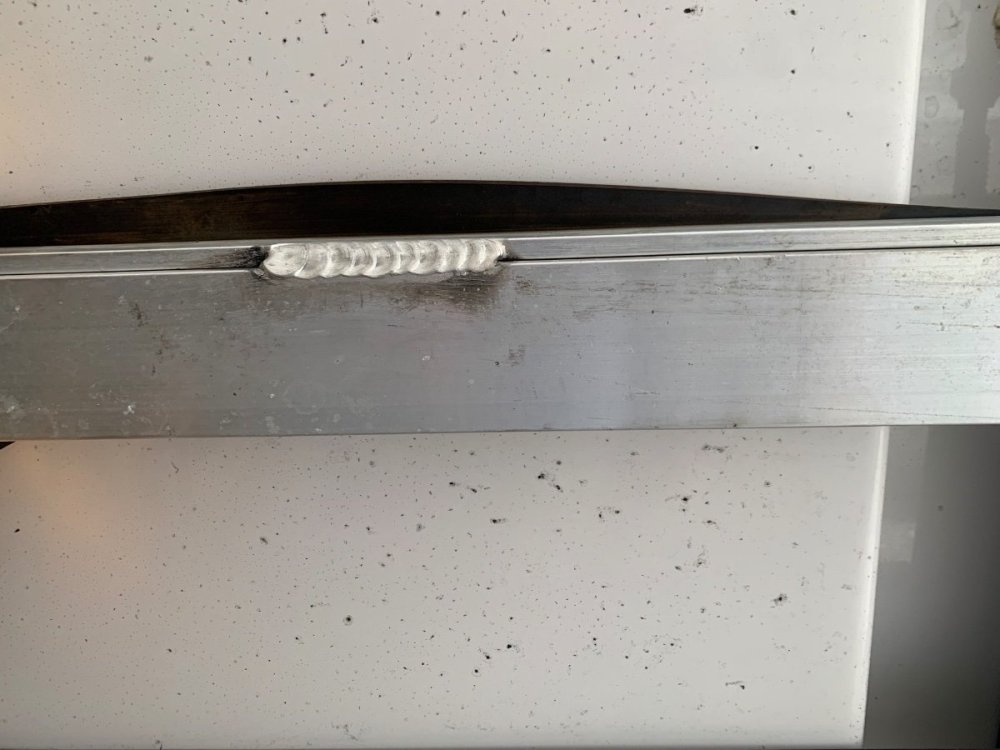

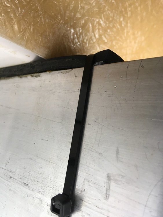

Cable tie used at frame tongue. No further a problems there at the three points!
To conclude, although I don’t perceive this a ‘major’ problem, these runners were factory installed for a purpose and thus, I feel obligated to maintain them to ensure proper support of the hull’s underbelly.

Interesting, I haven’t heard of this problem before. Thanks for posting the pics.., Could you use a big piece of wood, like a 2”x4”, and a hydraulic jack under the fiberglass to very carefully take the load off the rubber to allow you to push it back into place? Also, some soapy water, applied liberally to flush out the dirt, would act as a lubricant to perhaps help them move a little easily.
Did you check all the big hull mount nuts to see if any were loose? They do loosen, the ones at the jacks especially, and below the propane compartment... I am having a hard time visualizing a situation where these rubber pads would drift out of place if all other factors were normal. This could just be a visual symptom of another problem that remains to be corrected. I suggest that you file a Service Report - they may have other cases like this, and the extra info might lead to a a new technical bulletin.

I had the same issue, and have thought about what it would take to get our rubber moved back between frame & belly.  Some areas i was able to do it by hand, although i suspect my efforts would be negated by the forces (wash-boardy roads???) that caused it in the first place. other areas, i could not budge it without having to raise the hull from the frame.
I too thought (and JD validated it) of the 2x6 (or 2x8 to dissipate/spread pressure) for (2) hydraulic jacks on the hull, but have not done so yet.  It should only take maybe 1/8 - 3/16" upward movement to get enough room to reposition the rubber.  I may go a 1/4" to floss out the dirt/dust and apply the "3M Marine Adhesive Sealant 4000 UV " between the frame and the rubber.

I ruled out trying to lift the hull in any manner for fear of cracking the gelcoat/fiberglass. Oftentimes when I attempt to do something “very carefully”, stuff happens! However, your suggestion to use soapy water to cleanse and lubricate is a good one. Also, I will take a look at the hull nuts, as well. Thanks for your response.

The early models were notorious for this happening. I fixed mine and several other owner's units back in 2015 using jacks with supporting pieces of 3/4" plywood on either side of a cross brace. You don't need more than 1/8" of clearance to put the rubber strips back into place. The fiberglass will easily give that much without damage. Wetting the area well helped to facilitate. Using the quick clamps as above should make the job easier. The sealant mentioned by @SNY SD UP between the frame member and the rubber is an excellent idea.
Next ‘go’, I may try the board and lift method. If enough clearance, a may slip some cable ties around the truss to hold the rubber runners in place, as opposed to an adhesive.
