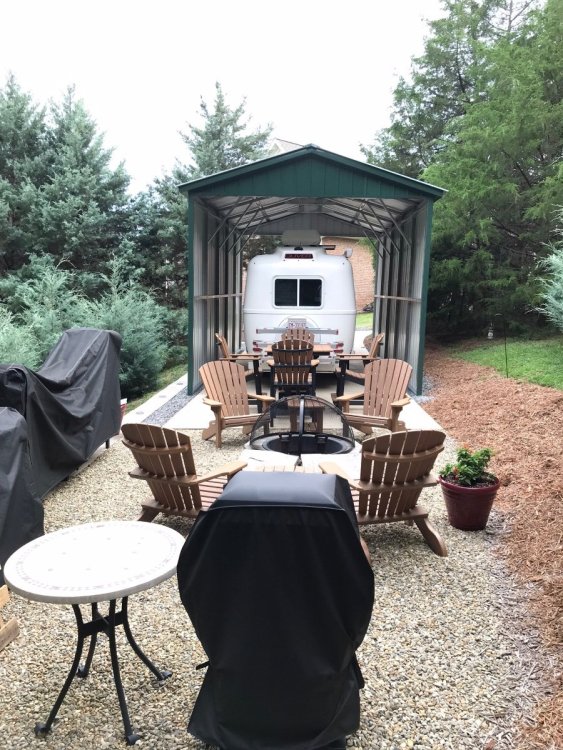

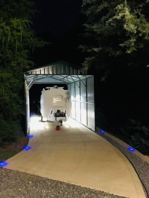

I had our “Ollie Hangar” built at our home in July of 2022. I had a 13’W X 55’L slab poured and contracted with a company out of Mt Airy, NC to have our Ollie Hangar custom built. We decided on 11’H X 13’W X 25’L steel structure.
We keep our Ollie plugged into 30 amp while stored here. We presently have 4 car attached parking 3 upper garages and a lower basement garage just did not need a 5th enclosed garage.
This open air metal building aka hangar has really worked out well for washing and waxing our Ollie and keeping out of the weather and especially the UV. Needless to say, it’s  a real plus having our Ollie parked at our home and under cover. Also note: I have plenty of room to wash and wax our Ollie.
Have fun deciding what to build that suits your needs!

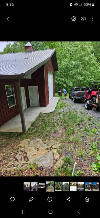

We've built a couple garages, with hopes of accommodating our Elite I, along with other vehicles and trailers.
If 15 x 15 x 30 is what your restrictions allow, go for it. If you can go at least 16 wide, I'd do it. An extra foot gives room for shelves, and a workbench on rollers. And, all that other "stuff".
If you have room, at least go longer and wider,, for resale, if you ever decide to move. 30' length won't accommodate  most class c's or a's.
Our pole barn garage is 32 x 36, still short, but we needed room to swing the truck, and have a significant  probably 3' incline, in the path. That's a factor, too. We have a 14' high door, so no factor for entry, but arse end of truck is high for "short me"  to unload, unless we are well inside, because of the inclined apron, on rainy days.
Still, it holds three workbenches, the Elite, two utility trailers, two or three atvs, and the truck, as necessary. And, various "necessary " shelving, genset, weedeaters, etc, etc. But, it's a jigsaw/chiclets game of maneuvers.
If all you need is a shelter for your Ollie, you are good to go. Room for a slim rolling scaffold on each side.
Remember that you need extra height for the garage door opener, and ratlines/overhead beams.

For anyone interested, I posted more details about our experience building the garage on our blog, including some pricing and the vagaries of construction schedules.

Your contractor did a nice job, from what I see in the photos. (I also read your blog.)
We investigated both conventional framing, and pole barn (pole framed), and chose the steel sided , pole framed for a number of reasons. Investment/price, speed of construction,  and availability.  (We built during Covid slowdowns.) And, I'm familiar with both. (My family built a couple steel buildings, and a bunch of conventionally framed buildings. My brother sells pole barns in Minnesota. )
I like your sidemount garage door openers. (Still have to allow room for the overhead rails.) We looked into them, but our contractor advised against, based on availability,  and size of our  conventional garage door.
Everything for us was an availability issue. Lumber, fasteners,  pvc, wire... (except the steel) you name it. Garage door took six months. Windows, six months. (We ordered in January,  at urging of our contractor,  got them in July, I think.) We went to 6 different stores in three counties, for 12/3 wire one day. Omg.
Thankfully,  the pain is over, and we really are happy with end result.
Back to the op, if you maintain 2' dimensions everywhere, if conventional framing, you'll save a lot of waste. Dimensional lumber is in 2' increments. Never do odd dimensions, if you can help it. Plywood/osb/Hardie panels, 4 x 8' , typically. Cutting takes time, and makes waste. (Honestly, cutoffs usually go to dumpster, even usable, unless you watch it, as we do.)
If you can add length to 36', or more, I'd do it. 32' width, again, I'd do it. You'd be surprised how little more it costs to add a few feet, either way. There are major site prep costs that add more to most finished buildings than a foot (or 6) either way.
Our home garage is 24 x 36, and we manage, but the Ollie sits in the side yard,  and my husband's truck in a side drive. (My Silverado gets a garage spot.) 2 cars, workshop, and my truck. And, a bunch of very important shelving containing stuff, and more stuff. Lol.
Good luck with your decision.  I have to agree with the posters who said to build as big as you can. @RustyMD, if you can go 32 x 40, or 30 x 40, I'd go extra length before width, imo.
Edit to add: if you are looking at a metal building, look at the newer crinkle finish for sides. It's a much less reflective, warmer finish. Not your standard shiny stuff. I love ours.
The "garage" side in my photo is 32 x 36. The workshop side (behind the "porch"  is 16 x 30. For reference. We went with one big garage door, because of the incline, and angles of backing. With a flat approach, or pull through, two garage doors would likely be easier. )
