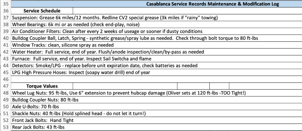

dewdev Posted January 29, 2024 Posted January 29, 2024 I have seen on this forum discussions for torque setting for the Wheel Nuts (90-100 ft-lbs) and the Leveling Jack flange bolt nuts (43 ft-lbs). Are there other fasterners on the Ollie's that we should be checking torque and what setting should they be? 1 2018 Oliver Elite II, Twin Bed, Hull #354 2024 RAM 1500, 4 x 4; Gas. 5.7L V8 Hemi MDS VVT Torque; 3.21 rear axle ratio w/TIMBREN spring rear suspension addition Maine
MAX Burner Posted January 29, 2024 Posted January 29, 2024 We use these values (screenshot from our maintenance and trip log): 5 6 Art, Diane, Magnus & Oscar (double-Aaarrf!) 2022 TUNDRA 2017 LE II; Hull #226 "Casablanca" HAM call-sign: W0ABX
John and Debbie Posted January 30, 2024 Posted January 30, 2024 7 hours ago, MAX Burner said: We use these values (screenshot from our maintenance and trip log): Very helpful. Thanks. John 2 John and Debbie, Beaverton, Oregon, 2017 Ford Expedition EL 4x4 3.5 liter Ecoboost, with heavy duty tow package. Hull #1290, twin bed with Truma package (a/c, furnace, hot water heater with electric antifreeze option), lithium pro package, picked up November 7, 2022 Alcan 5 leaf springs and Bulldog shocks done May 20, 2025 in Grand Junction, Colorado
dewdev Posted January 30, 2024 Author Posted January 30, 2024 Thanks MAX Burner. What are you referring to when you say "Shackle Nuts"? 2018 Oliver Elite II, Twin Bed, Hull #354 2024 RAM 1500, 4 x 4; Gas. 5.7L V8 Hemi MDS VVT Torque; 3.21 rear axle ratio w/TIMBREN spring rear suspension addition Maine
Patriot Posted January 30, 2024 Posted January 30, 2024 2 hours ago, dewdev said: Thanks MAX Burner. What are you referring to when you say "Shackle Nuts"? I will chime in. I believe @MAX Burner is referring to the torque value of the nut that tightens the wet bolt. Comonly referred to as wet bolts due to having a grease zerk on the end. https://www.etrailer.com/Trailer-Leaf-Spring-Suspension/Redline/34007-187-00.html 3 2020 OLEII - Hull #634 aka- “XPLOR” TV 2021 F350 6.7 liter Diesel Lariat Ultimate Tremor aka - “Beast of Burden” Truma Aventa 13.5 AC, Alcan 5 leaf pack, Alcan HD shackles & HD wet bolts, 5200lb never lube axles.XPEL 10 mil PPF front both front corners, 30 lb LP tanks, Sea Biscuit Front Cargo Storage box. ⚡️⚡️Recent Lithium upgrade to XPLOR - (2) Epoch 300ah Lithium batteries, Victron 3000W MultiPlus-II, Victron GX Touch 70, Victron Cerbo GX, Victron Smart Solar MPPT, Victron Smart Shunt, Victron Orion XS 1400 DC-DC charger, RV Soft Start. Zamp 90W suit case solar panel for 420W of solar.⚡️⚡️ North Carolina
MAX Burner Posted January 30, 2024 Posted January 30, 2024 @Patriot - exactly correct... Thanks for clarifying. 1 Art, Diane, Magnus & Oscar (double-Aaarrf!) 2022 TUNDRA 2017 LE II; Hull #226 "Casablanca" HAM call-sign: W0ABX
jd1923 Posted January 31, 2024 Posted January 31, 2024 However we think our Olivers are special, a bolt is a bolt and torque is based on bolt grade and diameter. I never look at manufacturer's specs, too much time and trouble. Torque-Tension Reference Guide.pdf (fastenal.com) 4 Chris & John in Prescott, AZ | 2016 EII #113 | '01 Ram 2500 Cummins!
Moderator+ ScubaRx Posted January 31, 2024 Moderator+ Posted January 31, 2024 I believe it is 43 pound/feet. 2 1 Steve, Tali and our dog Rocky plus our beloved dogs Storm, Lucy, Maggie and Reacher (all waiting at the Rainbow Bridge) 2008 Legacy Elite I - Outlaw Oliver, Hull #026 | 2014 Legacy Elite II - Outlaw Oliver, Hull #050 | 2022 Silverado High Country 3500HD SRW Diesel 4x4

Geronimo John Posted December 17, 2024 Posted December 17, 2024 I believe the right answer is the same torque as the rear jack bolts as they are essentially the same jacks. 1 TV: 2019 F-150 SuperCrew Lariat, 3.5L EcoBoost, 10 Speed Trans, Max Tow, FX-4, Rear Locker OLLIE: 2018 OE2 Hull 342, Twin Bed. OLLIE DIY’s: Timken Bearings, BB LiFePO4's, Victron 712 Smart, 350 Amp Master Switch, Houghton 3400, Victron Orion DC - DC, 3000-Watt Renogy Inverter, P.D. 60-amp Converter, Frig Dual Exhaust Fans, Kitchen Drawer Straps. Front Wardrobe Shelves, Snuggle Shelf. TV DIY’s: 2 5/16" Anderson System, Nitto recon’s, Firestone Rear Air Bags, Bilstein 5100’s, Mud Flaps & Weather Tech all, installed Ham Radio (WH6JPR).
