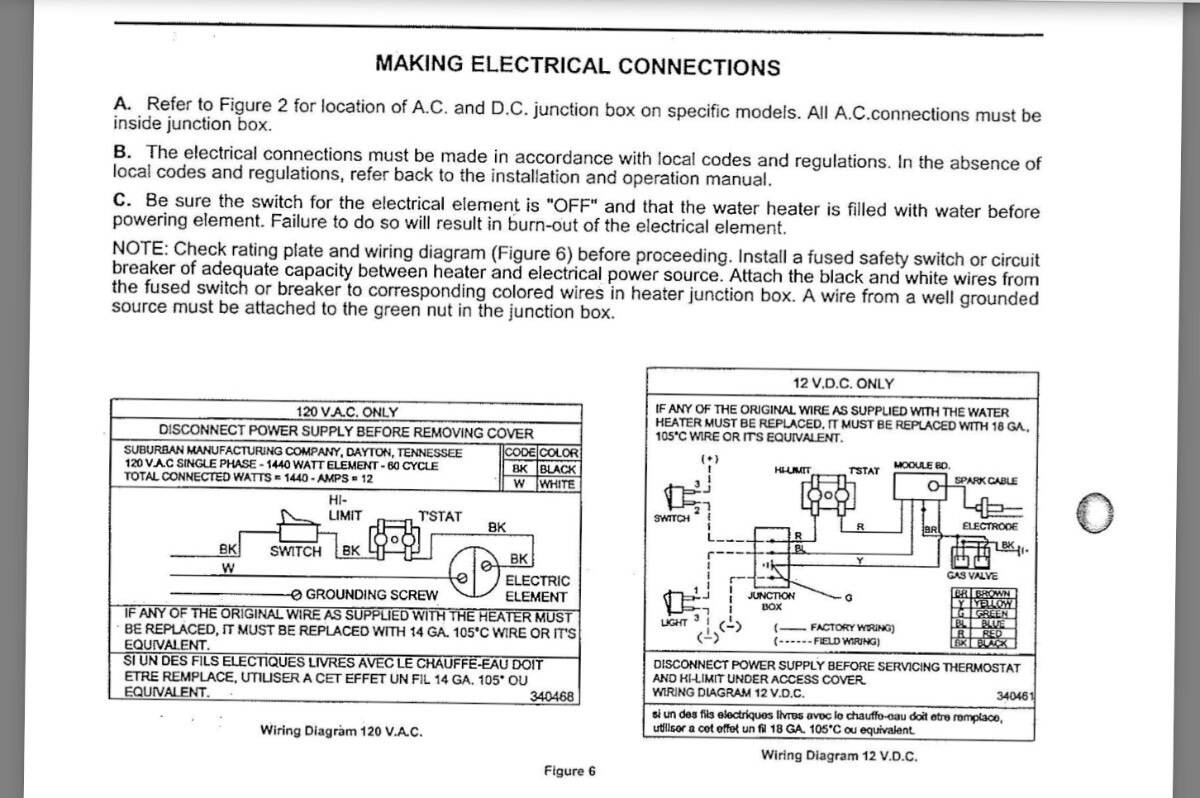

Note about phantom voltage drops. As mentioned it can be due to active/passive devices in the signal path, but it can also be resistance/impedance in the circuit. Case in point, the composting fan my two month old Oliver stopped working. The odd thing was my DVM measured around 3VDC at the terminal - not enough to run the computer case style fan - indicating a circuit issue. Jerry at support gave me a great troubleshooting list, the first of course was to check the fuse, which is fine. I didn’t suspect that as it was getting a low voltage, it’s an inline glass fuse and was unbroken. But I put the fuse back and voila - it works. There must have been a poor connection in the fuse housing which gave enough resistance for a voltage droop, so reseating it fixed the problem. So general advice is to check every leg of the power rail, a little corrosion or a loose connection can/will introduce resistance. -
You are on the right track. However as mentioned before, the blue wire is part of the Fault/Reset and it is grounded through the switch light as seen in the schematic. That is causing the voltage drop you were asking about. Don’t use the blue wire because it creates a resistive current path through the reset switch light. The yellow/green was the intended ground wire. It was probably grounded through the old WH chassis that’s now gone. You are right in thinking to re-ground it. However, I'd cap it off unused because apparently it's not be properly grounded on the switch side. Just connect the new WH black wire directly to ground. Only use the red wire from the switch. The on/off switch will work for the new WH, but the reset will be disconnected and not used. The AC side is completely separate as you know, although the AC ground might have been the original ground path for the yellow/green wire on the old units chassis. Having said that, isn’t the new unit controlled by a separate panel? Is a power switch required? I’d probably splice the red wire to bypass the switch, and blank off the switch to avoid any future confusion. Hope that helps!

Thanks @Geronimo John and @jd1923 for the additional comments. Clearly I have not provided adequate information regarding the install. No the Fogatti WH only uses 12 VDC to run the internal circuits, sensors etc and which also then feeds back to its remote control which is a nifty device itself. The power to heat water is only through propane and not AC and certainly not DC voltage. The wires themselves coming from the Fogatti are probably 16 AWG or 18 AWG at best and they are intended to connect to the same wires that fed the Suburban sensors circuit board, nothing more. Attaching a few photos below to illustrate (hopefully) the layout and wiring situation. I will be crimping those connections later on today rather than the wire nuts but used those just to make sure everything is working ok before proceeding to final installation. In the first photo the black and red wires represent those coming from the WH and as you can see I have red to red (+) and black to blue & green/yellow (- & GND). The new WH works fine this way oddly enough. The next photo is the same just pulled back further to illustrate the entire enchilada a bit better Remote below with two blue wires (non polarity) from the same wiring harness of the new WH inside the basement where the new WH is installed using 1/4 - 20 SS screws, lock nuts and fender washers rather than the pitiful pop rivets initially used for the Suburban WH. Note this IS a two person job. 1/4-20 stainless steel screws viewed from the outside though the bottom row I used self tapping Big Timber screws into a block behind the FG wall. There simply is not access to tighten nuts and screws on the bottom row. Everybody knows what a locking nut looks like but just in case someone else tries this method thought might be helpful.

I was thinking “new DC run” and GJ laid out the circuit logic perfectly! See what fuse and wire gauge Fogatti specs in their documentation. I would locate a spare or empty position in the 12VDC fuse panel to do this right. The last thing you want is more inline fuses under beds! This is a major appliance. Source wiring should start at the main +/- buses with the positive running through the fuse panel. 😎

Forgive me if I am not understanding your problem. But here is what I am thinking: Your Hull #70 is most likely set up like my 2018. A hot water requires a bunch of energy. It can get that energy from propane or 120 volt. The switch on the unit activates the 120V AC power to heat the water. The switch inside just activates the circuit board. Our hulls are not set up to power up hot water from the DC source. It is not like the refergerator that is. The Suburban hot water heater needs energy from three systems. The 120 V lines provide alot of power to the unit if your outside switch is on to use 120V power to do the heavy lifting (heating water) The DC power to to the gas solenoid valve to provide propane to heat the water if you want it to do the heavy lifting. But regardless of how you want to provide the energy to heat the water, you also must have DC to the circuit board. Those wires are not sized to provide power to heat the water. The DC wires are there only to provide power to the circuit board. Put a massive load on them and one would think you would blow it's fuse. Likely the reason your not blowing the fuse is that your new demand hot water has a sensor that will not energize it's heating coils unless the voltage is high enough to work properly. IF THIS IS YOUR PROBLEM Then you have a larger project than you anticipated as you'll need to run a new DC + and - to your demand hot water heater. I sure hope I am missing the boat on this one. GJ -

After many attempts finally got the thing to work but only after I used both the blue - and green/yellow ground wires connected together and to the negative black terminal of the Fogatti WH. The device would not work using either the blue or green/yellow wires individually connected to black wires of the Fogatti. So apparently it would be better to connect the green/yellow wire to some metal portion of the trailer, correct? I should add once operating the Fogatti worked great.
