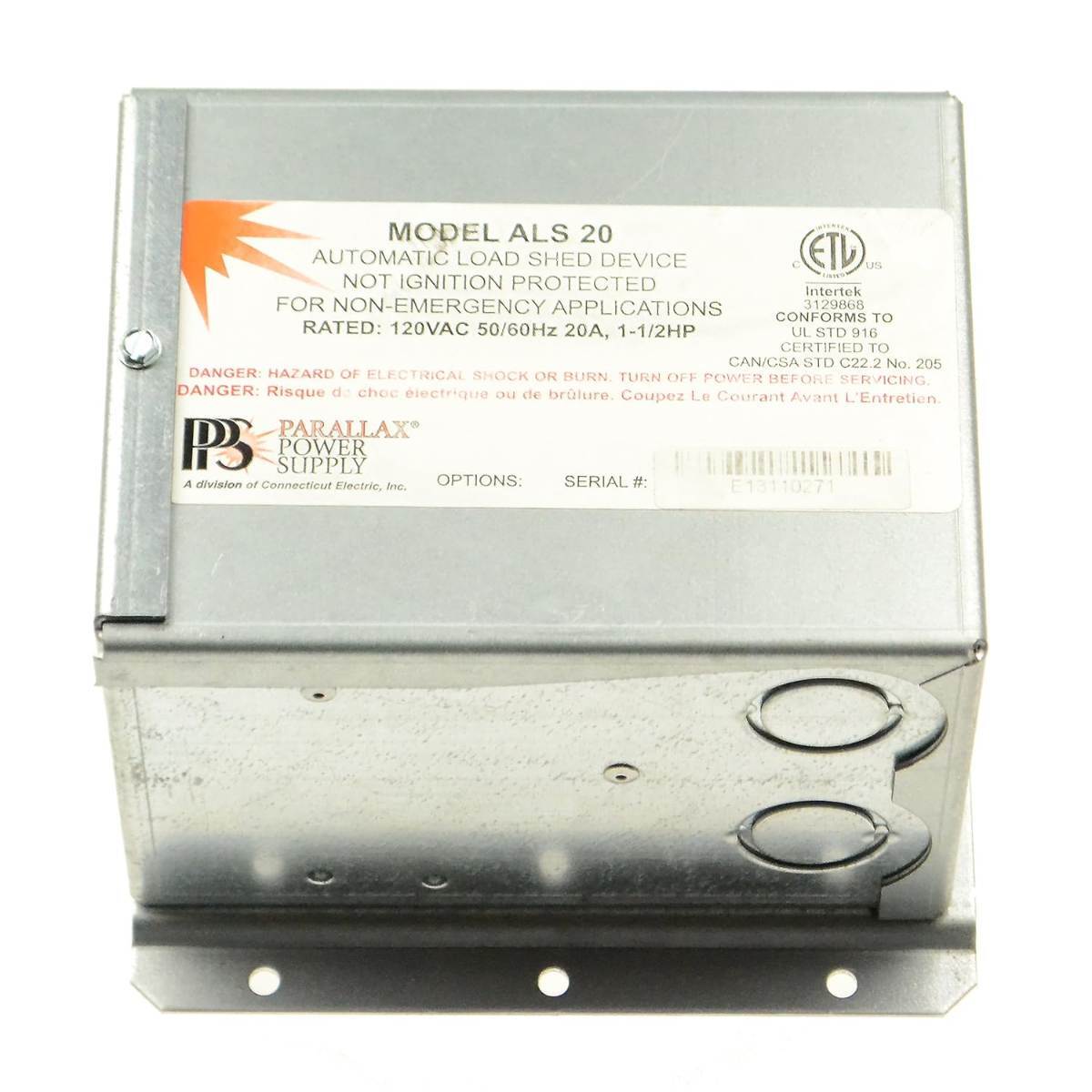

One of our previous 30A trailers had a load shed device that cut off power to the electric fireplace if you fired up the microwave. It wouldn't allow those 2 devices to operate at the same time. When you were done with the microwave, you could use the fireplace again. Oliver could set @Lamar up with something similar for the induction stovetop to protect the inverter. That should make everyone happy. Found this image on the Forest River forum. The topic comes up frequently there. - Today

@jd1923, excellent explanation about the power an induction cooktop actually draws. I have to think that the reason Oliver doesn't wire it through the inverter 120v AC sub panel is to protect inexperienced campers from themselves. The 2kw inverter may be plenty for the induction cooktop by itself, but the microwave is already on the inverter circuit, as well as the wall outlets. Imagine someone trying to use the cooktop, microwave and a coffee maker concurrently. Even when on shore power, one should be careful running multiple electrical appliances. Many of Oliver's customers are first time RVers who have little to no experience with power management. It seems to me that a 3kw inverter would be more appropriate as standard equipment for an induction cooktop equipped trailer since the demand could easily exceed 2kw. Maybe Oliver should just avoid wiring the air conditioner to the inverter since the battery bank doesn't have capacity for an extended run time. Steve -
