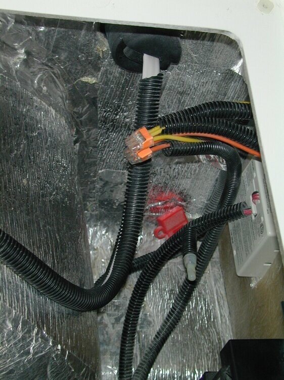

I will have to find a 12v Test Lamp. But you have offered some good information. Pulling the Break Away Switch... the spinning wheels will stop immediately. Solid and firm. Replug and they spin easily without resistance. Connect to Tow Vehicle... 'Trailer Connected' ... squeeze the manual brake controller in the 2019 F350... and a notice 'Trailer Disconnected'. Works fine on our 2019 27FBQ Airstream. Seems to be in between the 7 Pin Plug and the Axles. I found a Fuse Holder (RED) without a fuse. Below the second seat at the Table. Does someone know its function? Obviously without a fuse, everything inside the Oliver works.

Do you own a 12v test lamp? If you do, pull the disconnect switch (verify that brakes are working) and then test between the blue and white wires at the trailer connector. If test light lights then both the blue power wire to the brakes and the white wire to ground have connectivity and your problem is on the vehicle side. No light? Then test between blue wire and trailer frame. If it lights then there is an issue on the white wire between the trailer connector and trailer ground. Still no light? Your problem is on the blue wire somewhere between the connector and where it is spliced to the disconnect switch wire. -
Steve Thanks. Now everyone knows. This is information that is often found by those with experience! Learning one 'fuse' at a time. I will plug it back. My Electric Brakes seem to have a Fuse issue or Wire inside the Oliver. Maybe a simple fuse, reset or something that is between the operating brakes and 7 pin plug. Or a wire not making contact in a wire bundle under the table or bed access areas. Wow. Again that was quick.
This fuse is under the street side bed and half way up the right side among other wiring hardware. What does this Fuse Protect? What is it called? I am trying to hunt down an obscure reason why my Trailer Brakes are not recognized, when my 2019 Oliver Elite II to my 2016 F350 Diesel. I plug in and when press the F350 Brakes... disconnected. My 2019 Airstream has no issue with the Brake Controller. So it is the Oliver and some wiring issue? Pull the Trailer Disconnect when spinning wheels on either side... they immediately lock up firmly. Insert the Pin and power is disconnected and free wheeling with no effort. Have a Post on Oliver #448 and trying to find the... obscure... problem, but following wiring using a flashlight is the best I can do at the moment.

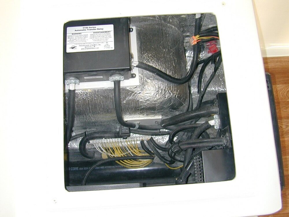

Using the color illustration of the Legacy Elite II Trailer Harness Electrical... the only item up for discussion seems to be the 'Ground Bar'. Is that the bar under the seat with a dozen or so wires? None are labeled. Lots of Yellow Wires. Is this the source for the Brake Grounding attachment? The Brakes have Power when the Break Away Switch is engaged. They lock up immediately. We spin each side and those passed the Rewire... just finished. Someone may have some advice. The connections all seem tight and secure. It there another location once the power leaves the Ground Bar to Brakes? 13 Yellow wires & 4 White wires... from a quick glance. All screws have a wire. One has no screw, but looks threaded on the Right Side of the bar. There are 3 bundles? with the plastic around the wire(s) on the Right side. I did not look if they had one or more wires... any suggestions? The wiring diagram is missing all of this.
