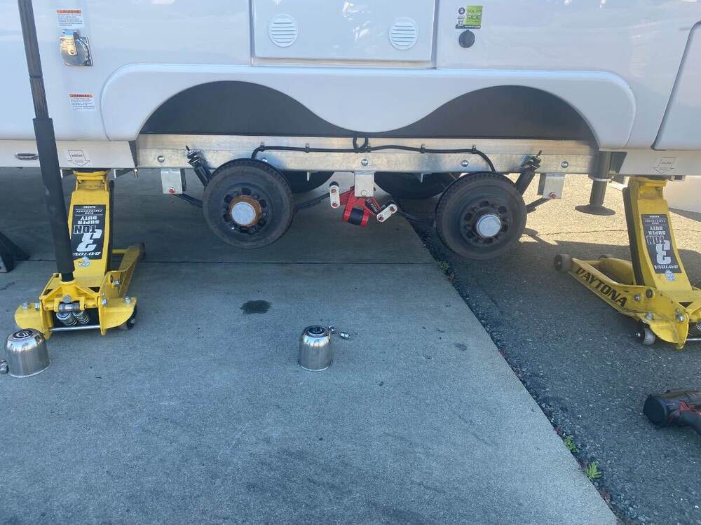

Living in the Texas Hill Country, with steep dips on roads where dry river beds cross, I asked Oliver to build The Wonder Egg (#14) with a spring-over-axle set up to avoid rear end scraping. It has worked very well for me and improves clearances over obstacles if I want to place the back end of the trailer over a log / etc to get into the perfect boondocking site. As mentioned, a set up like this does result in some handling issues you'd need to contend with . . . braking a turn taken little too fast with a strong, gusting wind coming from the inside of the turn is a potential rollover situation. That might be more pronounced in the LEII due to more height and mass on top, combined with a larger surface area causing a "sail" effect. To mitigate this issue, I always travel with a full fresh water tank when starting out to lower the center of gravity and improve safety. The 2"X8" board or driveway modification might be your best bet.

Yeah Chris, it's not easy to see. Apples to apples, you can measure change in axle height top-to-top, center-to-center, or at the bottoms. Thinking centers, it's difficult to add up. Maybe looking at the bottoms is easier. When under-slung the bottom of the axle sits on the leaf springs. When over-slung the bottom of the axle is lowered by the height of the leaf pack and the height of the axle diameter. Please look again and see if you can see it this way. I've looked at now many times and would like verification if my thinking and math is correct! 🤣
Don't you already have a mountain home? It's that fiberglass egg-looking thing! 🤣
Maybe I'm looking at it wrong, but since the axle is in the center of the tube, shouldn't it only raise the Oliver by half the diameter of the axle tube plus the height of the leaf pack?

I believe going from from an Under- to Over-slung suspension adds quite a bit more than 2" but you've done this on another trailer and I have not. You may be right. I don't have my notes with me. It was 27 years ago and I was shooting from the hip there. It did solve our problem and didn't affect handling much, BUT, that trailer sat much lower than a stock Oliver does. Another thing that we learned that may be helpful to the OP is that angle of attack to the grade makes a big difference. Worst case is driving straight into the grade change. Crossing the grade change at an angle helps reduce tail dragging. We found that our best option to clear our grade is a right turn leaving and a left turn returning.
