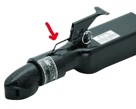

Since you had the latch pinned, I would assume that the issue was caused by the wire part that connected from the latch to the collar. I don't see how that collar can slide back allowing the coupler to open without some type of deformation to, or disconnection of, that wire. Let us know what Bulldog tells you.

John, the 2-5/16 sounds like a safe bet. I doubt you'll have to worry after that. -

No pictures. Trailer is back in storage. After a day processing, we are sure the trailer was secure on the ball. My wife directs me back and when we have the ball where we want it under the hitch, I lower the hitch. Once I know it is seated, I squeeze the lever and slide the slide closed. With it closed, I turn to my wife and we give each other Knucks and she hands me the pin to insert. After the incident and getting the front raised, I pulled the pin and opened the hitch. The bridge joint was a hard impact. It must have shut our dash cam off, or leaving it on when I went to the store and left it on overnight may have errased it. I wonder if this was a combination of bad bridge joint, new Alcan 5-leaf springs, and wear or issue with the 2" Bulldog. I'm not willing to go through that again. Requested pricing from Oliver so I can have them ship the 2-5/16". When I pick up the trailer, I will be taking roads less traveled straight to my Truck Service place to get it replaced. I may ship to Bulldog to have them determine what may have caused the failure. -
