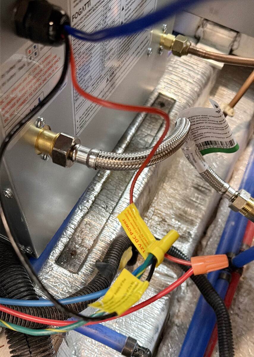

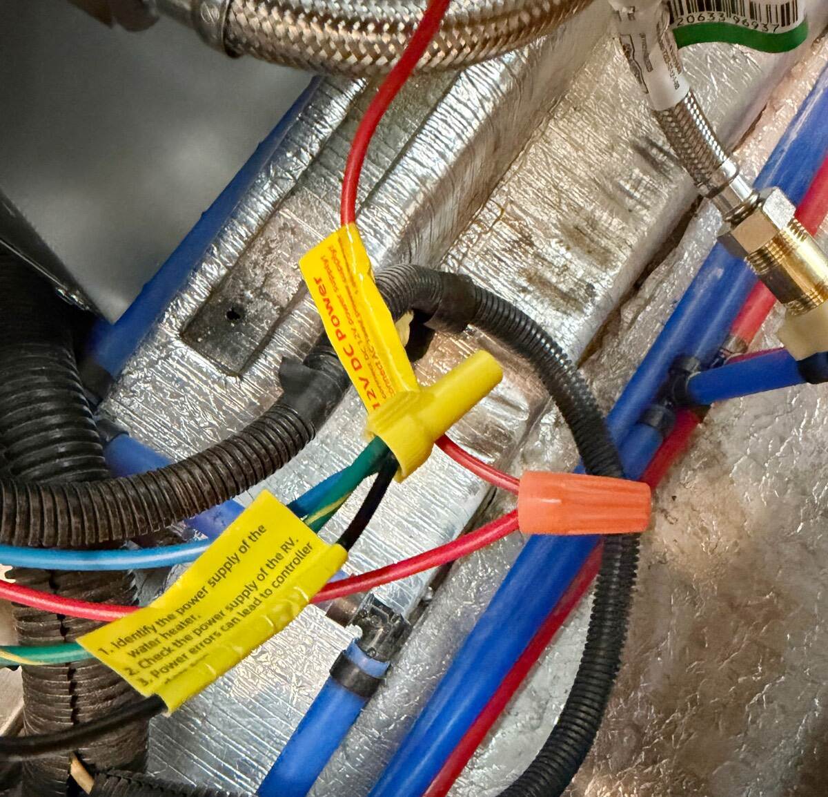

Thanks @Geronimo John and @jd1923 for the additional comments. Clearly I have not provided adequate information regarding the install. No the Fogatti WH only uses 12 VDC to run the internal circuits, sensors etc and which also then feeds back to its remote control which is a nifty device itself. The power to heat water is only through propane and not AC and certainly not DC voltage. The wires themselves coming from the Fogatti are probably 16 AWG or 18 AWG at best and they are intended to connect to the same wires that fed the Suburban sensors circuit board, nothing more. Attaching a few photos below to illustrate (hopefully) the layout and wiring situation. I will be crimping those connections later on today rather than the wire nuts but used those just to make sure everything is working ok before proceeding to final installation. In the first photo the black and red wires represent those coming from the WH and as you can see I have red to red (+) and black to blue & green/yellow (- & GND). The new WH works fine this way oddly enough. The next photo is the same just pulled back further to illustrate the entire enchilada a bit better Remote below with two blue wires (non polarity) from the same wiring harness of the new WH inside the basement where the new WH is installed using 1/4 - 20 SS screws, lock nuts and fender washers rather than the pitiful pop rivets initially used for the Suburban WH. Note this IS a two person job. 1/4-20 stainless steel screws viewed from the outside though the bottom row I used self tapping Big Timber screws into a block behind the FG wall. There simply is not access to tighten nuts and screws on the bottom row. Everybody knows what a locking nut looks like but just in case someone else tries this method thought might be helpful.

I was thinking “new DC run” and GJ laid out the circuit logic perfectly! See what fuse and wire gauge Fogatti specs in their documentation. I would locate a spare or empty position in the 12VDC fuse panel to do this right. The last thing you want is more inline fuses under beds! This is a major appliance. Source wiring should start at the main +/- buses with the positive running through the fuse panel. 😎

Forgive me if I am not understanding your problem. But here is what I am thinking: Your Hull #70 is most likely set up like my 2018. A hot water requires a bunch of energy. It can get that energy from propane or 120 volt. The switch on the unit activates the 120V AC power to heat the water. The switch inside just activates the circuit board. Our hulls are not set up to power up hot water from the DC source. It is not like the refergerator that is. The Suburban hot water heater needs energy from three systems. The 120 V lines provide alot of power to the unit if your outside switch is on to use 120V power to do the heavy lifting (heating water) The DC power to to the gas solenoid valve to provide propane to heat the water if you want it to do the heavy lifting. But regardless of how you want to provide the energy to heat the water, you also must have DC to the circuit board. Those wires are not sized to provide power to heat the water. The DC wires are there only to provide power to the circuit board. Put a massive load on them and one would think you would blow it's fuse. Likely the reason your not blowing the fuse is that your new demand hot water has a sensor that will not energize it's heating coils unless the voltage is high enough to work properly. IF THIS IS YOUR PROBLEM Then you have a larger project than you anticipated as you'll need to run a new DC + and - to your demand hot water heater. I sure hope I am missing the boat on this one. GJ -

After many attempts finally got the thing to work but only after I used both the blue - and green/yellow ground wires connected together and to the negative black terminal of the Fogatti WH. The device would not work using either the blue or green/yellow wires individually connected to black wires of the Fogatti. So apparently it would be better to connect the green/yellow wire to some metal portion of the trailer, correct? I should add once operating the Fogatti worked great.
I looked at the Suburban manual, it shows a wall switch with Fault/Reset light on the blue wire. That would cause voltage drop! Use the green/yellow wire for negative ground, and you should be good to go. Let us know if that’s what you have. Cheers, Geoff

Understood good luck with JD. The HW switch I am referring to is the one remote switch that Oliver installs on the interior not the switch at the new WH. IOW's I'm still confused. Thanks for trying though. Thus far nothing is connected to the new WH other than the propane. I am trying to figure out which wires to connect to the new WH. Many thanks.

That is different. I'm on jury duty lunch break, this will be quick. The WH switch I assume is a remote switch. It likely is a specialty switch with some resistors or such causing a voltage drop, some LEDs will do that. Unfortunately I'm not familiar with that suburban unit. You will probably need to replace the switch for the new WH. Check the old switch for internal resistance with an ohm meter. Good luck and let us know what you find
I probably did not explain my situation thoroughly @Snackchaser. The old Suburban is completely out of the Oliver, AC wires are taped off and disconnected. When measuring the remaining 12 volt wires they have not been connected to anything yet. If measuring with the HW switch off, crickets, I get nothing other than small microvolts. The switch has to be turned on to obtain anything close to 12 volts +. So if I connect the red + wire and the blue - wire to the new Fogatti it will only receive 12.2 volts of input. That amount of DC current is not enough to effectively run the Suburban furnace based upon past experiences and it might have a negative impact on the new WH with only 12.2 volts. Or am I missing something? Thanks
You are measuring volts with WH switch on, which means your measuring the voltage drop of the internal WH electronics. Disconnect the red, and volts should be 13.7. The yellow/green wire is a non-current carrying ground due to the AC aspect of the WH, so it does not see the electronics voltage drop. All seems normal. Cheers, Geoff

So I am finishing up the install of a new water heater, tankless version to replace the old Suburban. Retrofitting into the Oliver is NOT an easy task but more on that later. So on the old Suburban there are 3 12 volt DC wires connected to the 12 volt terminals, red for +, blue for -, and yellow/green for ground. However when I measure the voltage across the wires with HW switch turn on, the red to blue measures only 12.2 volts but when I measure the red to green/yellow @ ground I received the full SOC of my Epoch batter which is 13. 7 ± volts. The new Fogatti tankless only uses two DC wires, red and black, and no AC connection at all. I am inclined to think in my case to use the red and green/yellow wire for the full DC voltage available to me. Can anyone explain why the red to blue wires only return a reduced voltage of 12.2 volts DC? My gut instinct is the wiring was done incorrectly at the factory build swapping the negative terminal for the ground but this is just a stab in the dark not being totally versed in DC electronics. Thanks and appreciate any insight on this.
