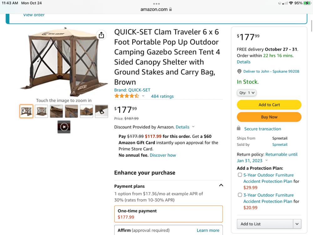

https://www.amazon.com/gp/product/B00TMBEMQ6/ref=ppx_yo_dt_b_asin_title_o00_s00?ie=UTF8&psc=1 I already have the big one (almost 12 feet) and I do like it, but holy cow it is big and hard to store and set up for just one person. I can use this when I am traveling solo, and I also plan to use it as a winter shelter over my Caldwell shooting bench. I have a short airgun range set up in my unheated RV bay aka The Hanger Deck, and with the wind panels installed, this will be a lot easier to keep warm when it is below 40 degrees there. This CLAM will leave room for another chair and some walking space. I already have three “wind panels” for the larger CLAM, I do not know if they will fit this small guy, but a new set is just $40. Does anyone know if the panels are universal? John Davies Spokane WA

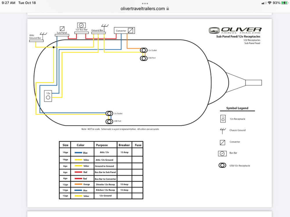

The USB ports and AC plugs not working on the curbside
John E Davies replied to Trailblazers's topic in General Discussion
The USB ports are 12 volts DC (input), the AC outlet is 120 volts AC, they are in no way connected (electrically). You need a basic volt ohm meter so you can do some testing. The AC outlets are all wired together, with a single circuit breaker. You are lucky in that you have real wiring diagrams, they quit supplying them after your year I think. While you are checking fuses in that panel (at the converter) check all the little brass “ears” that grip the fuse contacts. These DO loosen and can cause intermittent or complete failure. Remove each fuse one at a time, and carefully squeeze the ears together using needle nosed pliers. You should disconnect the batteries first unless you like taking risks…. When reinstalling fuses, push them straight in, do not cock them or you will just loosen those ears again. That may fix the USB issue, but it has nothing t do with the AC outlet.That may be faulty, it is easy to replace. John Davies Spokane WA
