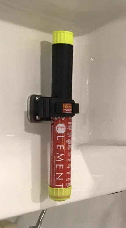

It would have to go outside, in the upper access area - the burner area is where fires normally start. So it would perhaps need to be above the direct chimney heat. I actually like the concept, I was wondering when the Chinese would give us cheaper versions of this patented unit: https://olivertraveltrailers.com/forums/topic/4291-how-to-element-fire-extinguisher-install/ Those are great, I bought three already and would buy extras if the price weren’t so very high. I will wait for some actual test reviews of the Jogoswal units before getting any. The price will be way cheaper after the other manufacturers start copying the design. If there is even a functional Chinese manufacturing sector in a year…. ;). Also, I don’t see any info about water resistance, I wash my engine compartments at least annually, and a fridge bay is certainly a “wet” location. if it gets damp on your car, the engine heat will dry it quickly. Not so in the fridge. Did anyone notice this: ”The small fire extinguisher is very suitable for ladies,can be used as car accessories for women ,or girly car decor accessories.” FYI Fridge Defend is RV SPECIFIC and adds a thermo sensor directly to the burner can, where a fire originates. Plus it is made in Montana and they will actually answer your email…. John Davies Spokane WA
