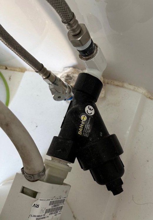

Note 2:  The black fitting behind the toilet is a filter, not a pressure regulator.

@mossemi I did figure out the thing on the toilet was a filter and cleaned it out, there was a lot of sediment in it but it was not clogged.

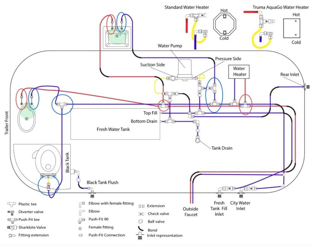

I was going off this plumbing diagram which seemed to match the way my water lines go but I don't have an accumulator and this one does and the the one you posted doesn't so I will take another look at how my liens are run.  The one you posted and this one however don't show the inline pressure regulators and backflow valves which I really think they should.
The back flow or check valves are on the tank fill and city water inlets.  They are under the floor of the basement/storage area in my 2017 LE2, in the area your diagram shows.
Interesting.  I have not ever heard of filtering drinking water to a toilet.  The previous owner must have had some really really nasty water that broke the toilet. Or maybe their pets like filtered drinking water.
GJ
@Geronimo John LMAO...I know you were joking but to clarify for others, the filter does not purify the water it just catches debris in the water so it doesn't get in the valve of the toilet and damage it or cause a blockage.
