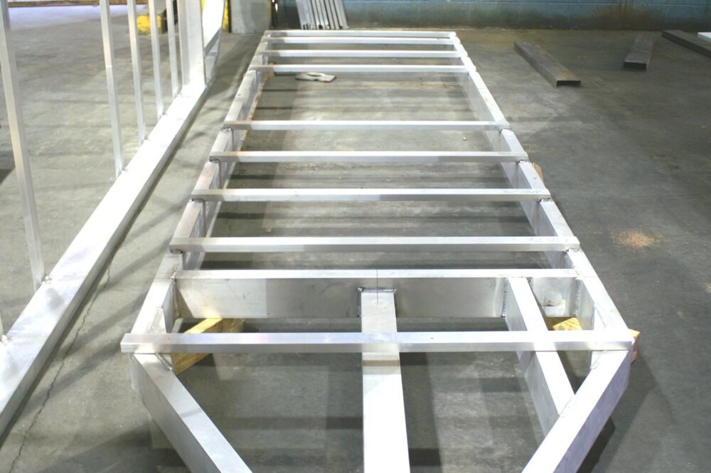

Tali and I have been around and under the trailer all day installing the new Alcan springs. While under there, I counted eight cross members behind the rear axle with one doubled.

wow, thanks for all the conversation regarding "sagging crossbeams". We have been off the grid and it's raining. I will get some images of the under-side of my frame posted and count the crossbeams when I'm in a dry clean place get on the ground.  I discovered the beams were sagging when I was making a drilling template for installing a mid-trailer mud-flap per John Davies design. I clamped my drilling template (1" wide flat bar of aluminum) to the crossbeam in front of the axle and it clearly was sagging..
