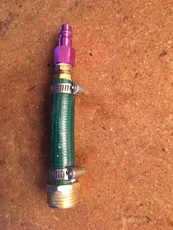

jd1923 Posted June 13, 2024 Posted June 13, 2024 Your hot water is working everywhere, so don’t work any hot water maintenance. Do you have a shop aid compressor? I would connect air to the city inlet at 50-60 PSI and blow air through the cold water lines at all 4 outlets on and off. You need to make a tool like this: Chris & John in Prescott, AZ | 2016 EII #113 | '01 Ram 2500 Cummins!
jd1923 Posted June 13, 2024 Posted June 13, 2024 If you do not have a high volume shop compressor, make a 1/4” air to 3/4” hose fitting like this with hardware store parts (Walmart, TSC, etc) and run your trailer by the shop where you just spent $$$ on tires and borrow their air line. You have something blocking the main water line going to the front of you Oliver. Push to 80 PSI if you have to! PEX IS rated to 100 PSI. Best wishes, Godspeed and prayers for your quick departure. JD 1 Chris & John in Prescott, AZ | 2016 EII #113 | '01 Ram 2500 Cummins!

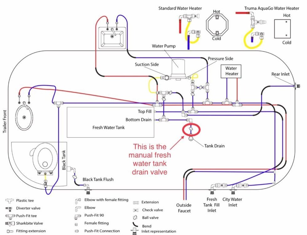

jd1923 Posted June 13, 2024 Posted June 13, 2024 (edited) 2 hours ago, csevel said: I have a compressor. Going off now to Ace Hardware to get the parts... Given you have no cold water to the front of the trailer, the air cannot hurt, hopefully help. With air applied, I would push the toilet pedal first since you already cleaned that filter and can again. Then try the bathroom sink. Good to try vinegar and keep the HWH valve shut for that and the compressed air. Found this plumbing diagram (newer than your hull and mine since it shows Truma HWH). Appears there is one cold line going to the front and somehow, who knows how, this is blocked. It shows one side of one T-fitting goes to the front and yours must be blocked there or along the path to the front. I've never heard of this before either. Good luck! Edited June 13, 2024 by jd1923 Chris & John in Prescott, AZ | 2016 EII #113 | '01 Ram 2500 Cummins!

jd1923 Posted June 13, 2024 Posted June 13, 2024 @csevel You’re welcome Claudia! I’m just happy I came up with the idea, was able to help, and being up after midnight is the usual case for me. The point was getting you on the road today. Personally, I’m not much for suggested maintenance procedures. I work mine my way and certainly have used my “thinga-ma-giggy” in several RVs always at 40+ PSI. Hate the pink stuff, always blow air. BTW, you can always run air pressure up to the rating of your water pump PSI. My upgraded water pump is variable speed at 65 PSI, 10 over OEM. Many would worry, but I prefer its performance and it has served us well. Best wishes! Have a great trip, post pics! 🤣 Chris & John in Prescott, AZ | 2016 EII #113 | '01 Ram 2500 Cummins!
