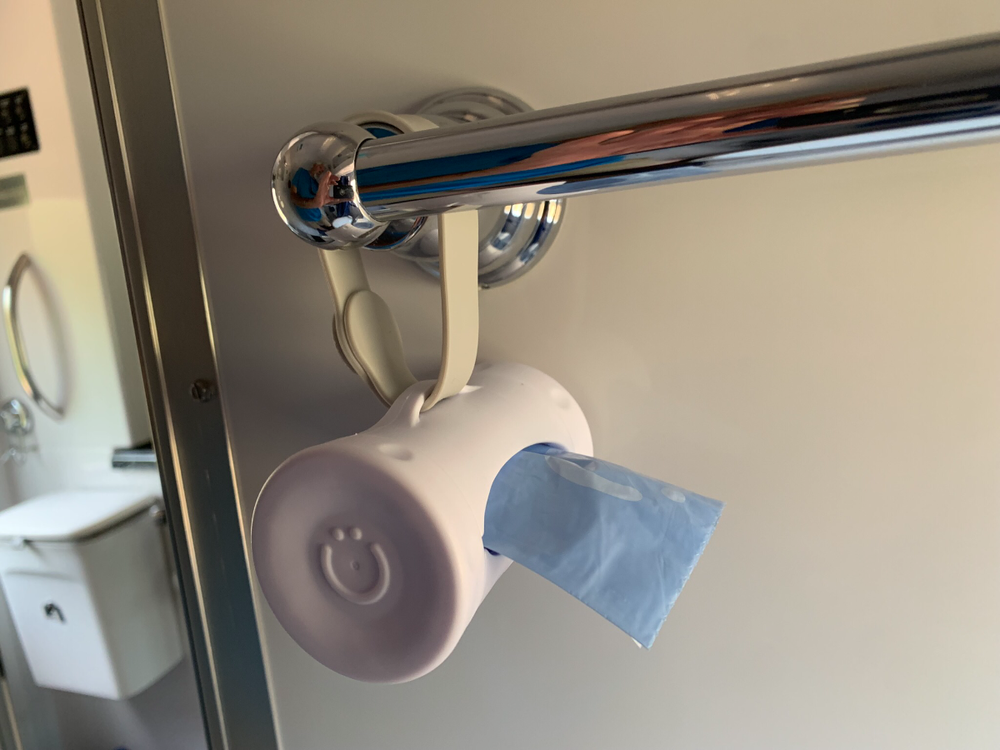

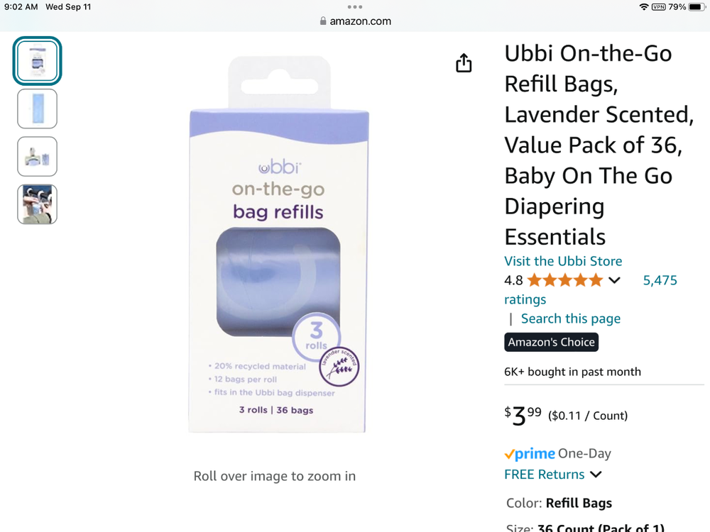

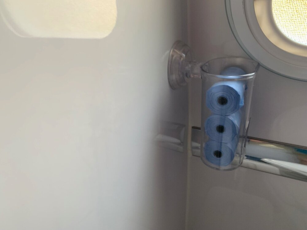

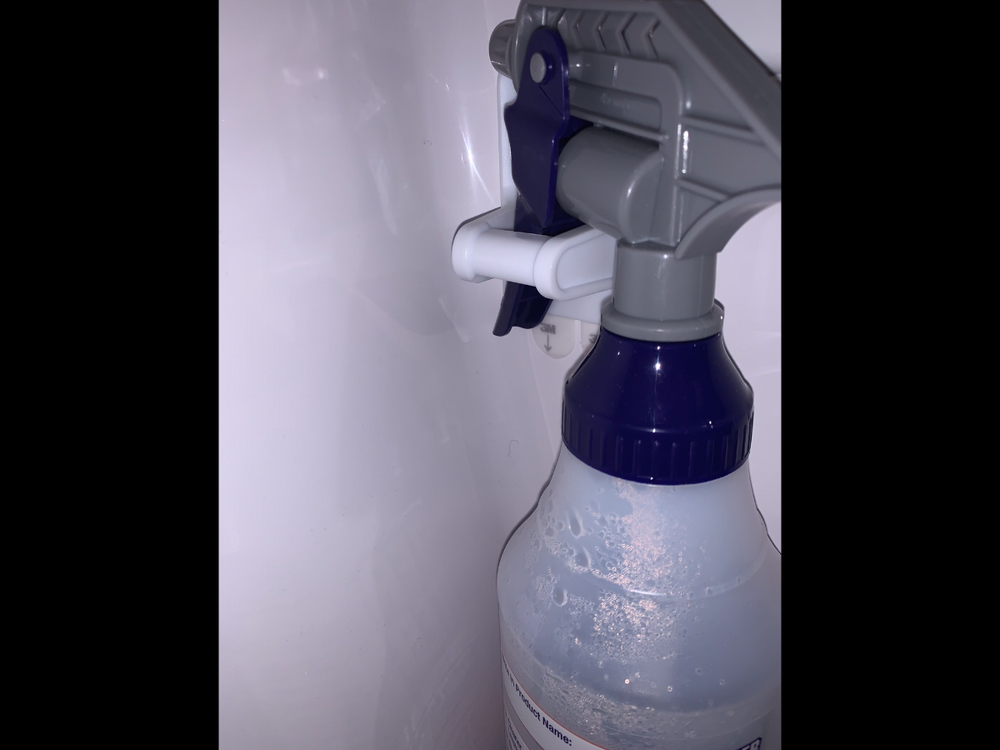

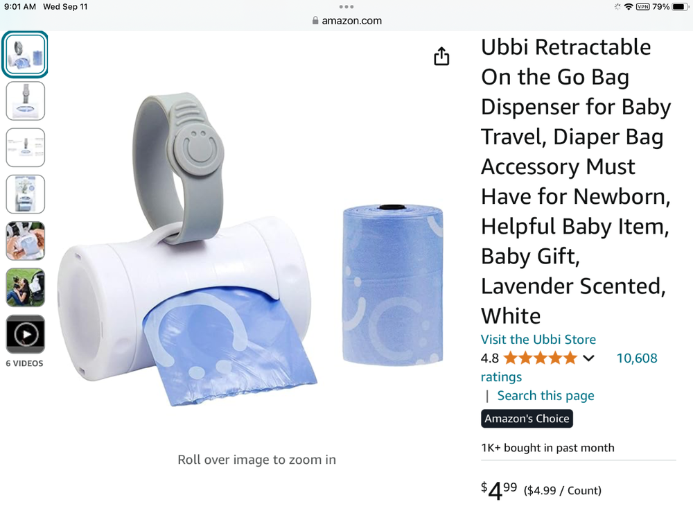

We no longer put TP in the black tank; reduces waste volume, less water to flush toilet, and dumping the black tank is much easier and faster. Here’s a couple of ideas:
Personal scented waste bags, disposed of as needed. These bags and dispenser are marketed for use in managing baby diapers when on the go and are inexpensive.
Handy spray bottle for final bowl rinse, as needed. Amazing how much less water is required, thus further reducing black tank volume.

16 minutes ago, SNY SD UP said:
@Ronbrink
do you have source info for those
Amazon purchases:
