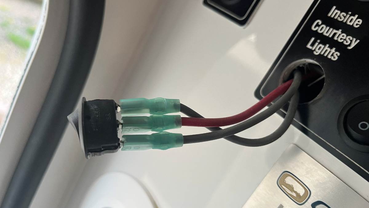

taylor.coyote Posted August 2 Posted August 2 (edited) dj- I'm an electrical zero, a couple of questions: when jumping wires, the toggle at the pantry has two wires and the toggle at door has 3 wires. easy to jump the two wires at the pantry. how to you deal with jumping the three wire toggle? is the center a ground? do you unplug the two outer wires and jump them ignoring the center wire? or what? Edited August 2 by taylor.coyote 2016 Legacy Elite II, Twin Beds, Hull #124 Tow Vehicle: 2019 Ford F250 4x4 / Short Bed / Crew Cab / 6.7 Diesel Fieldbrook, Ca

jd1923 Posted August 2 Posted August 2 (edited) 39 minutes ago, taylor.coyote said: dj- I'm an electrical zero, a couple of questions: when jumping wires, the toggle at the pantry has two wires and the toggle at door has 3 wires. easy to jump the two wires at the pantry. how to you deal with jumping the three wire toggle? is the center a ground? do you unplug the two outer wires and jump them ignoring the center wire? or what? Taylor, I'll go out and look at mine... In the meantime the real expert here, he who turned his water pump 3-way switches into 4-ways to add another switch for the outdoor shower is our friend Geoff! Maybe @Snackchaser is online?! Edited August 2 by jd1923 1 Chris & John in Prescott, AZ | 2016 EII #113 | '01 Ram 2500 Cummins!
taylor.coyote Posted August 2 Posted August 2 I have done some research on-line and have learned each three way toggle switch will have three wires attached. The toggle switch for the inside courtesy lights located under the Pantery has only two wires attached. Seems the middle wire is floating between the fiberglass wall below the Pantery and behind the battery compartment. I don't have a scope. Does anyone have experience fishing a wire from between the walls of this compartment? any coaching will be appreciated. 2016 Legacy Elite II, Twin Beds, Hull #124 Tow Vehicle: 2019 Ford F250 4x4 / Short Bed / Crew Cab / 6.7 Diesel Fieldbrook, Ca

jd1923 Posted August 2 Posted August 2 OK, so forget the jumper and I'm hoping you have a multimeter. If not, get one ASAP! On the main switch, the one at the entrance, the center RED wire is 12V+. The two gray wires will carry 12V+ based on the position of this 3-way switch. When down as pictured the red is connected to the upper gray wire which carries power to the bedside switch. This allows the secondary switch to turn ON when activated. When the switch is turned ON, the center red wire is connected to the bottom gray wire which will turn the Courtesy Lights ON. Set the multimeter to the Continuity setting, which looks like a ground symbol. In this position, you can touch the two leads together and it will make a sound like an alarm. The main switch should show continuity between the middle 12V+ lead and the top lead when OFF, and show continuity between the middle lead and bottom lead when ON! RE the bedside switch you could just use a jumper or you could test for continuity in the up/ON position. I understand this is a lot and I can get on the phone with you tomorrow if you like. BTW, as you can see in this picture, not a spec of fiberglass dust and these spade terminals were so tight I had trouble pulling them back just a 1/16" to get the multimeter leads to connect to metal. If this is above your head, start looking in the basement for wires disconnected at the lights. Best wishes, my friend! JD 1 Chris & John in Prescott, AZ | 2016 EII #113 | '01 Ram 2500 Cummins!

taylor.coyote Posted August 2 Posted August 2 jd, thanks for the pic,,..yep my center red wire is missing / not connected to the toggle switch and floating somewhere in the wall..... I have the use of my neighbor's scope, hopefully I can find the center red wire. Should be / could be a quick fix ...maybe? Few would take the time to pull the toggle switch and send me the pic You are the best !!! 1 2016 Legacy Elite II, Twin Beds, Hull #124 Tow Vehicle: 2019 Ford F250 4x4 / Short Bed / Crew Cab / 6.7 Diesel Fieldbrook, Ca
jd1923 Posted August 2 Posted August 2 1 hour ago, taylor.coyote said: yep my center red wire is missing / not connected to the toggle switch and floating somewhere in the wall..... I have the use of my neighbor's scope, hopefully I can find the center red wire. Should be / could be a quick fix ... Cool, easy fix! Empty the kitchen cabinet and remove the access panel. You should find it easily but be careful not to disturb the other wires too much! 😎 1 1 Chris & John in Prescott, AZ | 2016 EII #113 | '01 Ram 2500 Cummins!

taylor.coyote Posted August 3 Posted August 3 jd, I learned a lot today. I was looking for a red wire because the center wire at other end (courtesy light toggle switch by the door) was red and not labeled. Using a scope, I started by looking up from the basement. I had pulled out all three toggle switches just below the Pantery (hot water, water pump, courtesy lights) to pull on the various wires to identify and exclude them. Accessing and scoping from the basement was unsuccessful and difficult at best. I had success pulling the plate with the tank monitors next to the toggle switch plate. Removing this place gave me a nice size cut-out enabling a good angle to maneuver the scope. I was still looking for a red wire when I came across a loose gray wire (same color as the other two wires going to the courtesy light toggle). The loose wire was labeled T46 and did the trick. 1 2016 Legacy Elite II, Twin Beds, Hull #124 Tow Vehicle: 2019 Ford F250 4x4 / Short Bed / Crew Cab / 6.7 Diesel Fieldbrook, Ca

taylor.coyote Posted August 3 Posted August 3 Geoff, Your offer to help is appreciated. I was able to find and reconnect the loose wire. You are correct, not much room behind pantry switches. As stated above, I found pulling the tank monitor face plate provides a generous opening to access the switches and wiring in front of pantry. 2016 Legacy Elite II, Twin Beds, Hull #124 Tow Vehicle: 2019 Ford F250 4x4 / Short Bed / Crew Cab / 6.7 Diesel Fieldbrook, Ca
