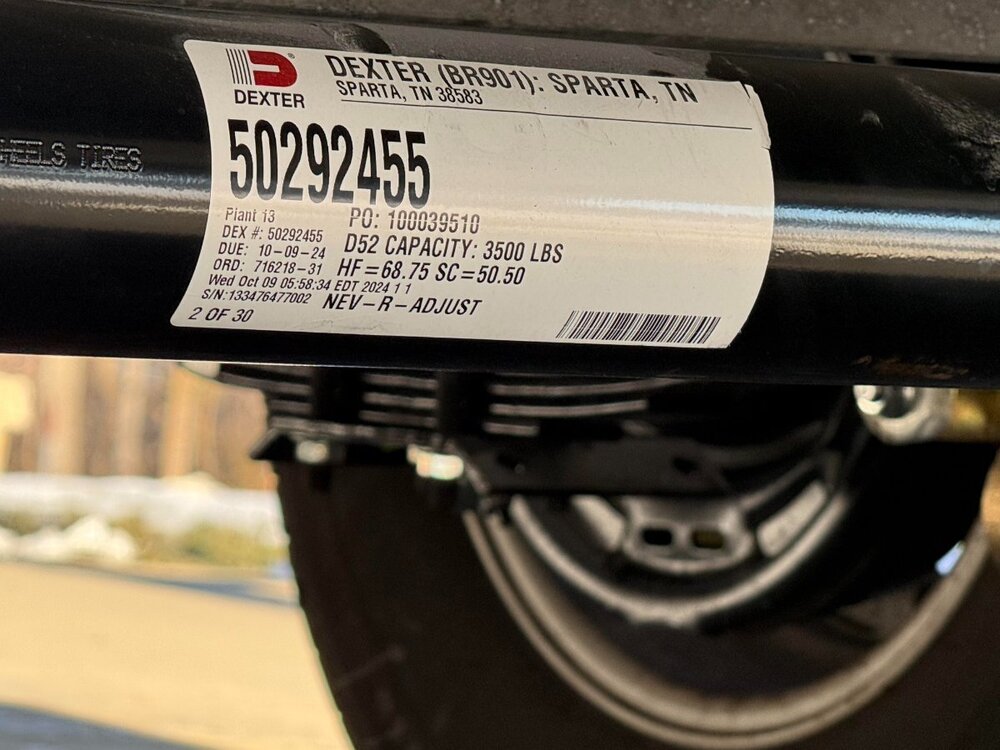

It took awhile, but I finally found pictures of my axle label and although I had several pictures I wondered why they all had the same serial number.  I went under the Ollie and found that I only had 1 label and it was on the rear axle.  I then found the engraved SN for the front axle and it was the same as the rear, which I thought was weird.  So I emailed that information to Dexter asking for an as built sheet and if tandem axles should have the same SN.  Dexter sent back a single build sheet and never addressed my question about the same SN on both axles.
So the question that I now have is if anyone else has the same SN's on both axles and if that is Dexter's standard practice?
The attachment is for 2017 LE2 #193 which has the original suspension equipment
