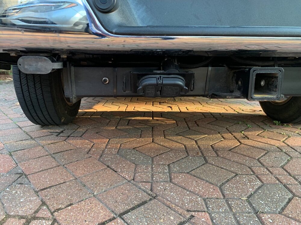

Either way, mounting under the bumper was the mistake made. Besides the greater chance for damage, it makes it hard to reach. I'm thinking the cables and SB175 will come out somewhere between the bumper and license plate.
Recently completed the cable transfer from my former TV to the Savana van for the DC-DC setup. On the former, the 7-pin outlet was well protected on the bumper next to the license plate and at the recess designed for a ball hitch mount, the receiver hitch being below the bumper. The van however, came stock with the trailer cable connections affixed to the receiver hitch cross beam, underneath the bumper. That being, I mounted the DC-DC Anderson connection likewise. My hope is the rather robust receiver hitch cross beam will serve as a skid plate and protect said connections!
2020 OLEll, Twin, 579:
On 2/10/2025 at 9:30 PM, jd1923 said:
For the DC-DC charger, I'm not going to pop the hood and throw a switch every time we hitch and unhitch. Much too much bother.
You may recall, I installed a solenoid to activate power to the DC-DC cables leading to my rear bumper-mounted Anderson when the motor is running and thus, no power when off. That said, I also do not want these cables powered while running and not trailering, unless the Anderson is needed for others purposes like the VIAIR or an alternative Dometic fridge/freezer power source. Therefore, I installed a toggle switch for the solenoid trigger wire, which leads into the van interior for convenient toggle activation, as needed.
Agreed Ron, you have automated this with an ignition circuit solenoid and if I though it was more important, your design is the way I would go too. I was referring to others who have mounted a manual switch under the hood.
Understood, I was simply reinforcing your thoughts about having an on/off switch under hood and sharing an alternative to others on the matter. Originally, I installed a circuit breaker fuse with manual reset to serve as an on/off switch as well, but added engine temps during extreme heat conditions would cause it to trip. No bueno! I replaced it with an ANL fuse holder/60A fuse for cable protection and the toggle switch for manual on/off capability; again, information for those that may not be in the know.
Your logic line is the same I used.  I also figured that there was no way that the ground would ever get in the way of my Anderson that I had mounted below and in front of the rear bumper on our F-150.  But alas a young driver on a very tight mountain switchback trail road proved me wrong.  He unknowingly backed my TV into the sloped side of the mountain and crushed my TV Anderson plug.  No electrical problems as I always turn off power at the battery circuit breaker when not towing.
Experienced as your are, I know that you'll be wise when backing back up to bumper blocks and curbs.

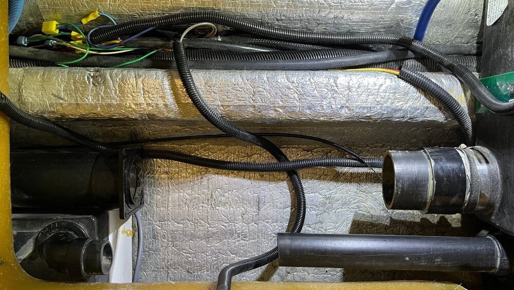

Yay, wired our Oliver for the DC-DC charger today!
(TT side only, wire lengths installed hitch to buses, no connections made yet)
An injury and then rebuilding the waste valves took precedence. But after Reading @Ronbrink's comment (thanks Ron) about running the wires around the toilet and not having to remove the vanity shelf, I thought since I have the waste valves removed under the front dinette seat, I should get this done before putting them back in.
I pulled the two valves yesterday and then thought, a couple of hose clamps and I could pull it all out and inspect for condition inside and clean the area. Good thing I rinsed the toilet 4 times when we dumped tanks. The 4 AWG wire is now laying across the floor in the picture.
It made the wiring soooo easy! I stuck my head down where the waste valves were installed and looking forward I could see the OEM installed cables coming through the hull. I'll see if I can take a picture of it.
If they truly sold me 65 ft and I have 28 left, then I used 37 ft for the round-trip in the Oliver (2 x 18.5 ft). I ran it as straight as can be leaving some extra length where the buses are located under rear dinette seat, and outside I made it 5" longer than the trailer cable to be safe. The amount left over is enough for the + run to the starter battery (~20 ft) with 8' left over for rear and front frame grounds, and a 4 AWG straight run from battery to alternator.
We're leaving to Catalina State Park and the Coronado NF a week from Monday, so completing the DC-DC charger installation is second to getting the waste valves finished. So glad, I got this wiring run today. I'll be happier when the plumbing is done!
